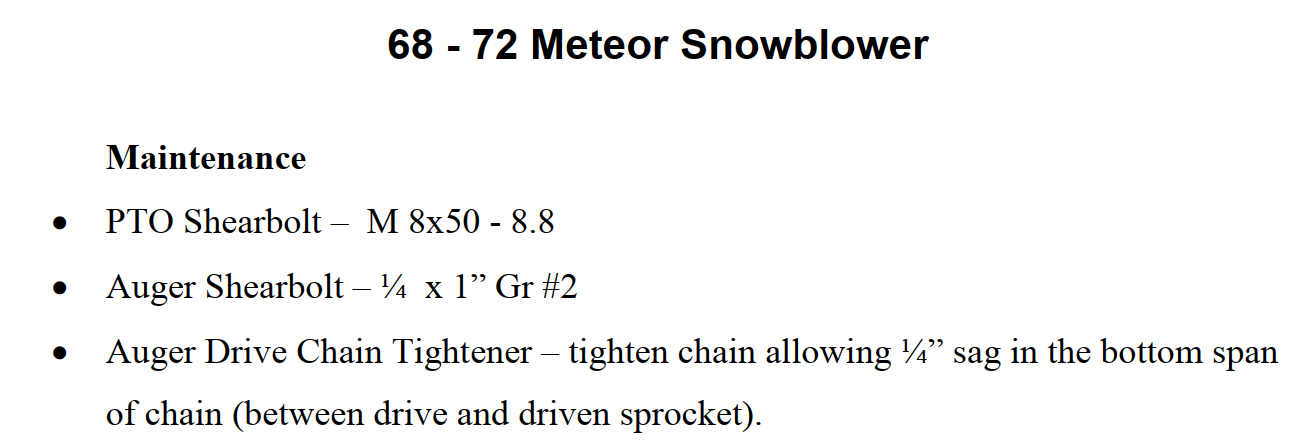

I guess I'll have to call tomorrow. They are in Ontario and it's a Family day holiday there.
But found this further down the manual, so twice there they mention grade 8.8 for the PTO shear bolt. Don't know why the original was a grade 6.8...

FWIW,I've never seen a 6.8 bolt thread.
4.8,8.8 & 9.8,but never 6.8.
I have to wonder if the bolt head is poorly stamped?
Good Luck!
Good Luck!
Yeah, if you look at the posted picture, there is like a dimple on the left side between both halves. That's what I thought it was, 8.8. I'll get confirmation from them today.

Gave them a call. They confirmed that it's an 8.8, so that 6.8 is a misprint.
Now all I have to go get are grade 2 1“ 1/4"D shear bolts and locknuts for the auger.
