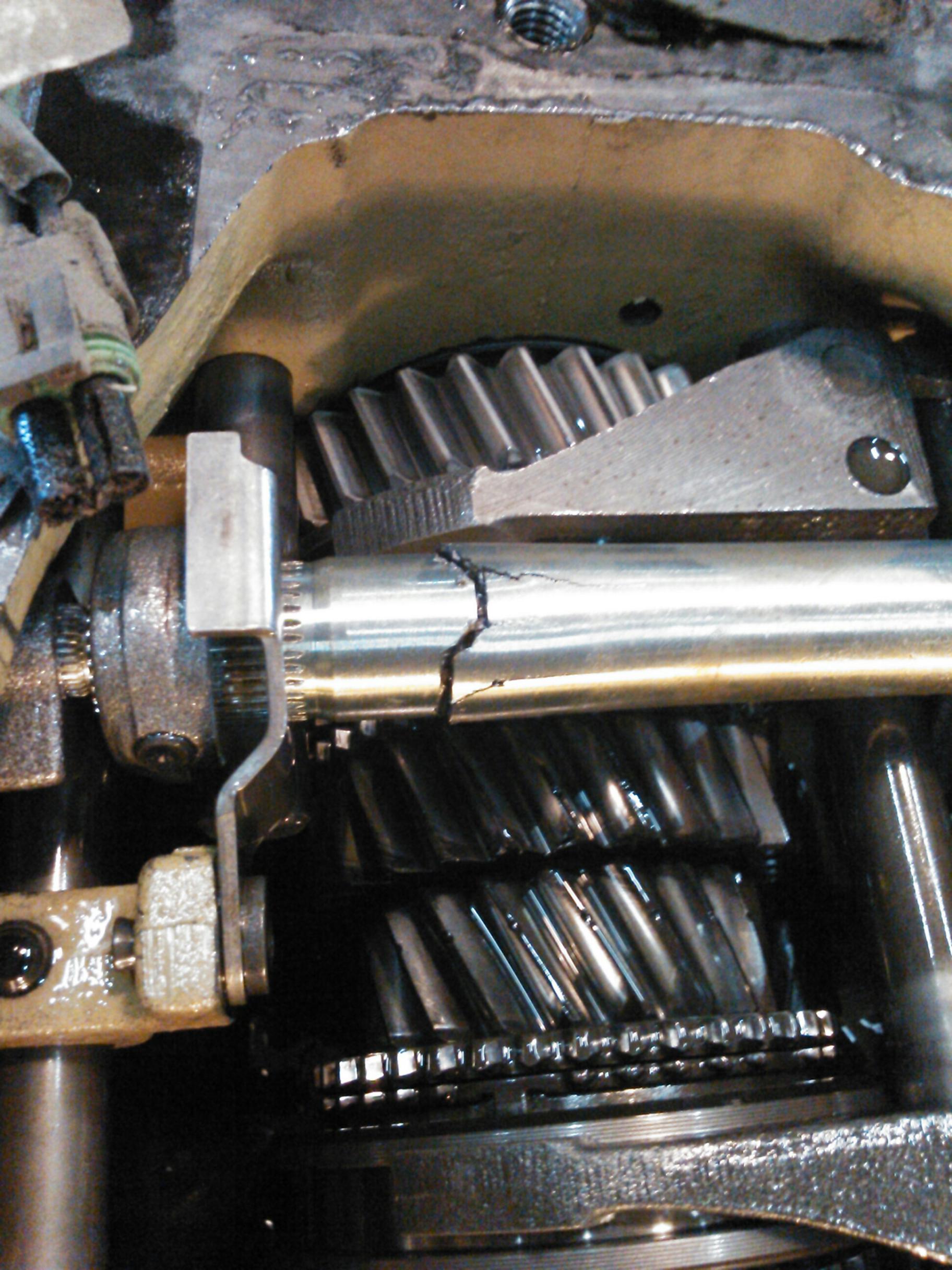

Hey guys we've got my 2955's cab off to fix a broken shifting linkage and we're thinking of replacing the clutch since its the original and I'm at 4600 hrs and we've found that the hand brake is all burnt to sh** so I have to change that out too. My questions are:
For the clutch what needs to be changed out? JD parts lists to different clutch disks; AL70272 & AL69935, plus the clutch itself AL68485. The throw-out bearing is AL120028.
For changing out the hand brake band can we wiggle that out as-is without pulling apart the left planetary?
Anything else we should check while we have it apart this far?

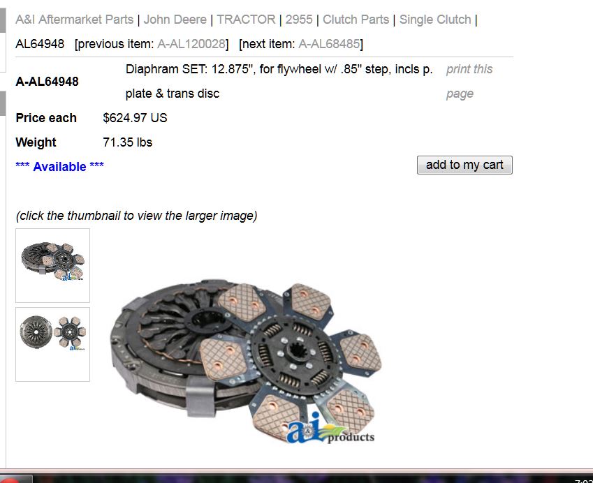

The clutch disk is kind of personal preference. The AL70272 is the factory style and is considered "heavy duty". The AL69935 is "regular duty". Personally, I like the regular duty. It is smoother operating, less jerky in operation. WIth a good operator, it lasts just as long and it is less aggressive on the pressure plate and flywheel surfaces. I would plan on sending the flywheel to machine shop to be resurfaced. Also plan to replace the pilot bearing. Part number JD10107. If you choose the heavy duty clutch, there is a part number that includes the disk and pressure plate in one box. AL64948 is a "kit" that includes AL70272 and AL68485 in one box. The kit saves you a few bucks.
The brake band can only be changed after removing the left final drive. A pin needs to be removed that is only accessible from the left final drive area. Even then it can be a pain in the butt, but while cab is off it would be foolish not to replace it. Hopefully the drum that the brake rides in is not destroyed. That requires removing both final drives and differential to replace.
Personally, I would replace orings and seals in rockshaft(three point) valve while it is off. Pretty easy to do and costs only a few dollars in parts.
What did you find in the shift linkage?

That's AL55218… $365 dollar piece of tin.
Strange on the clutches… AL70272 is cheaper than AL69935.

Here's clutch & PP from A&I plus they also offer pilot & TO brgs
A
Where did you get a price of $365 for AL55218? Here's my dealers price: AL55218 Shaft ADD 458.89 USD
