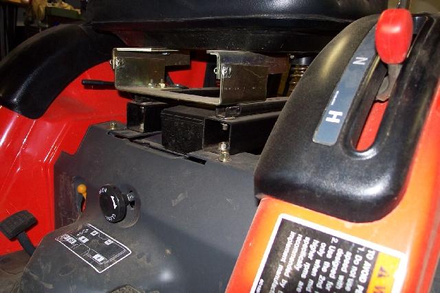

I'm 6'2" on a B7500, so I should have the same problem; and I did until I did 2 things:
1. Moved the seat back to the farthest back setting
2. Added a 2" square steel tube between the seat slider and the frame (raises the seat about 2")
My knees clear just fine now.

I'll see if I can do a pic for ya. It's pretty simple; two pieces of 2x2 square tubing about 10" long. Unbolt the whole seat (4 bolts). Drill 2x2 tubing to match the seat/frame. Remount. Need 4 short bolts/washers/nuts. I used 4 5/16" bolts 3/4" long (I chose stainless, but cad plated would work too).
That's about it. I'm only 200#, but since I'm only 1" shorter than you, and on a smaller tractor, thought the dynamics would be pretty close.
Might be a while before I get a pic though. Haven't succumbed to the digital camera mavens yet. I'm too cheap. /w3tcompact/icons/crazy.gif
The GlueGuy

Got my digital camera & took a couple of pix of the seat extension. The first one here is taken from the front of the seat standing on the right side of the tractor.
The GlueGuy

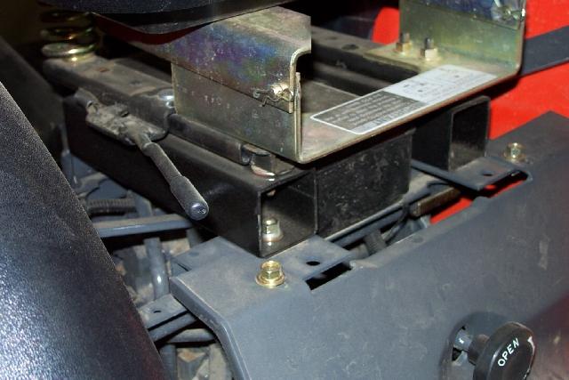

This last one is from the rear (hoses up and to the right go to the T&T).
The GlueGuy

Thanks for photos. You must have a 2710. The 2910 has a little different seat but the basic idea is still doable. I don't think the extra 2 inches will do much to the center of balance. I have alot of steep terrain.
I think I know what you did. You replaced the original bolts with ones 2 inches longer then drilled through the 2" square tube. Another possibility would be to use two sets of bolts and offset the seat to the rear.
Thanks again
Rick /w3tcompact/icons/smile.gif
/ 2910 Light/Turn Signal Switch Mount #13
Actually, it's a B7500. /w3tcompact/icons/smile.gif One of the reasons that I'm curious why a B2910 doesn't fit you when we are so near the same size. With this little seat extension, the B7500 fits me just fine.
The bolts going into the seat rail are the originals. I put 4 new 3/4" bolts into the frame. So there are a total of 8 bolts now.
The GlueGuy
