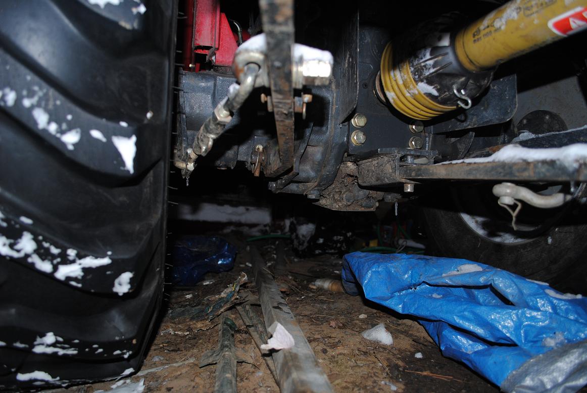

Not much else can beat up a tractor more than logging in the dense woods of New England. I 'd like to know if anyone uses this size Mahindra ( 2615 same tractor?) to skid their firewood in or the like as I think it is a good size for the woods. Questions come to mind such as ground clearance, things hanging low on the tractor that can get wiped away or bent by meeting the stems of underbrush. Plastic parts that might break etc. such as fenders. I've used my 85 JD 750 in this fashion for many years. Very few parts left for it so it is quickly becoming an outdated relic. My closest dealer is a Mahindra one so if this tractor can hold up to this kind of work as my 750 has, I'd consider buying one.
   / 2816 for logging #2

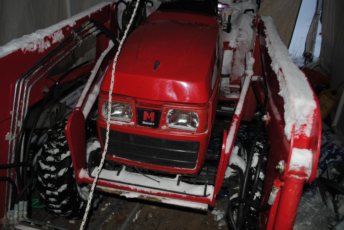

Their are some hoses under the front area but you could protect them with a little work and the front axle doesn't have any linkage that could be bent from hitting a stump, not like another company. From the pictures that I've seen it look's like all the fenders are metal, can't tell about the hood. The only thing it might be wider than the 750 which might be an issue.

Get the tractor with ag tires, and the 2816 will do as well or better than any other similar sized tractor, and yes, the fenders are all metal. The tractor is buildt by Mitsubishi in Japan for Mahindra and I can not say enough for the reliability of the Mitsubishi made Mahindra's.

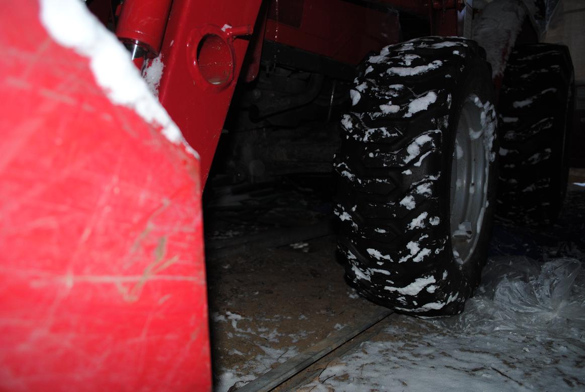

I really have been impressed with my 2816 so far. It was alot stronger than I anticipated. I highly recommend getting the tires filled. It will pull much harder.
As far as undercarriage, its fairly clean. I havent hurt anything on mine and I've ran over alot of junk while clearing our land.
