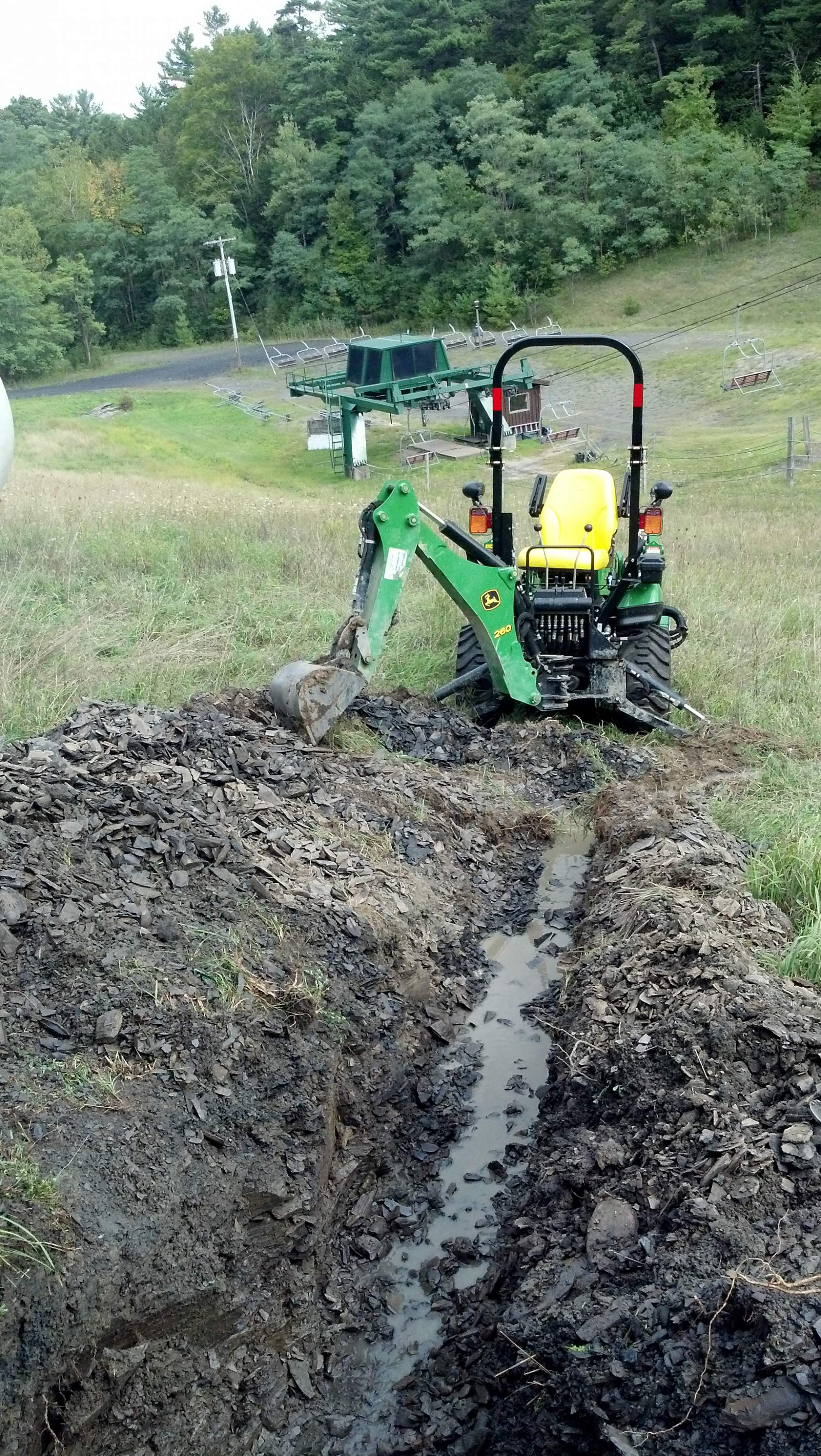

we start out with the 1026r/260 to locate the main water line and electric service

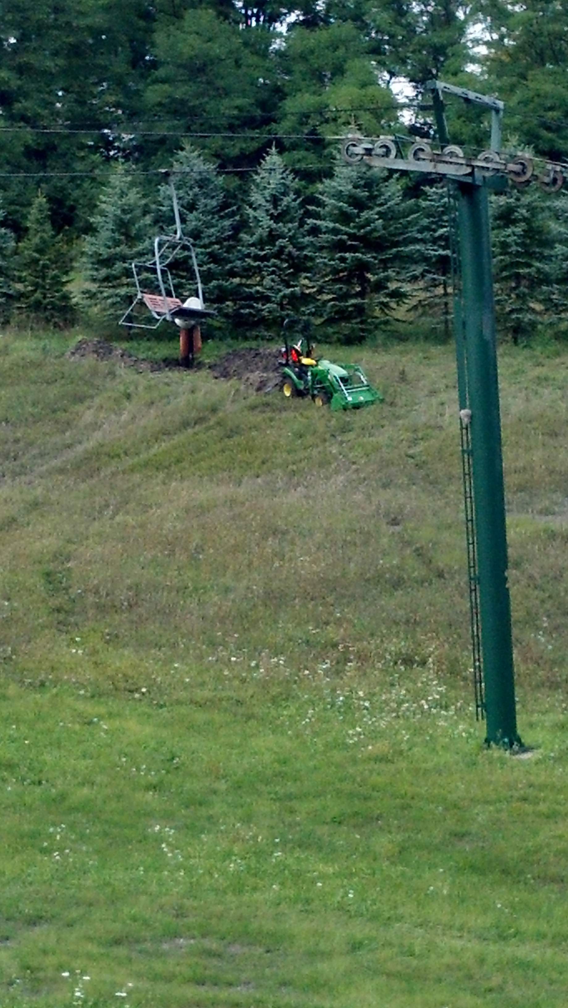

then bring in the JD 290D excavator with its 36" wide bucket- in this case the slope of the hill is to great to use the excavator
big hint here if you bury somthing take pictures or make a map
never put electric and anything else in the same trench
trying to do this from a 30 year old memory, even with having someone with first hand knowledge - doesnt work

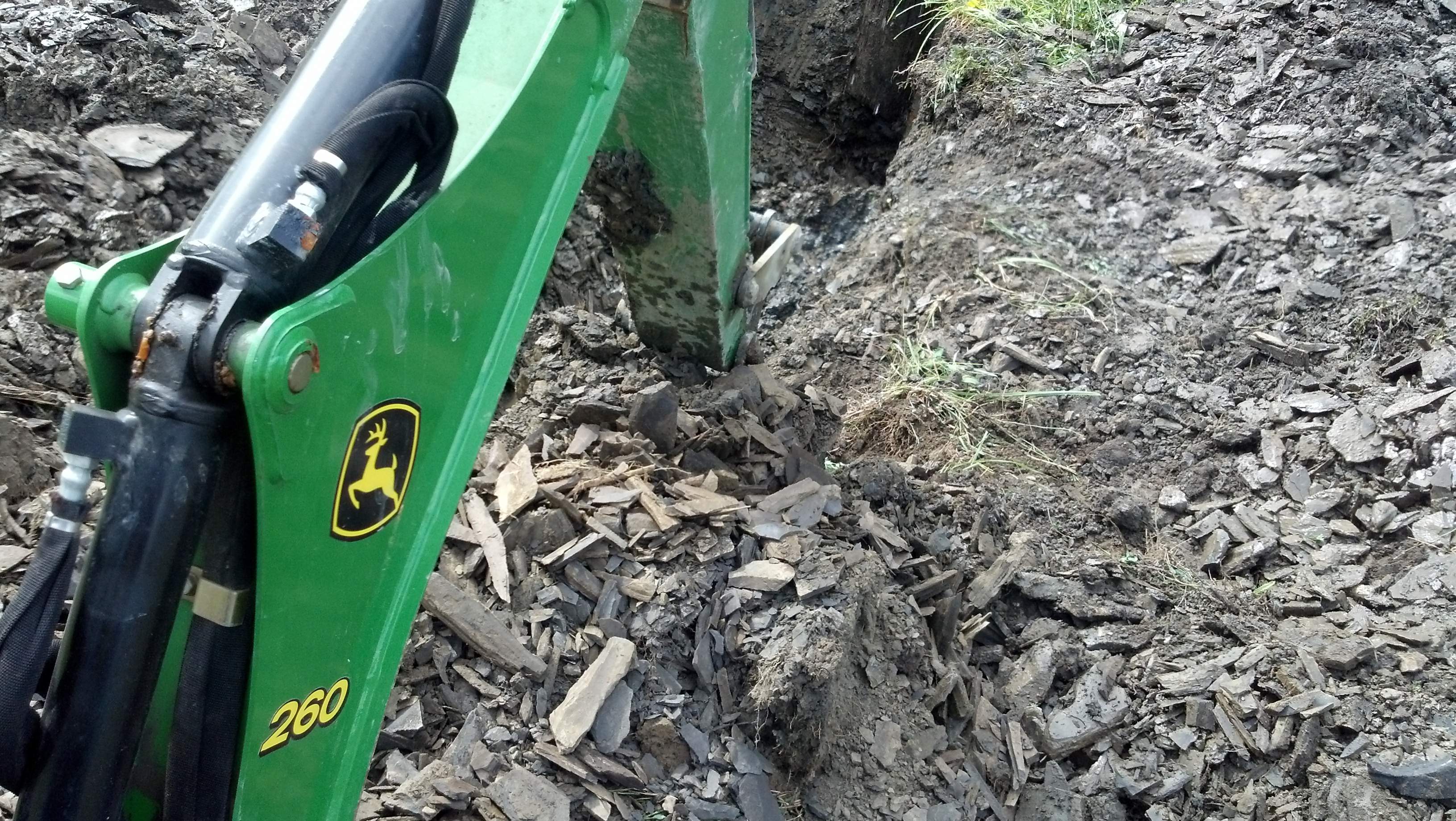

the trench was dug in undisturbed shale and a 4-6" layer of soil to a dept of 5' at the starting point

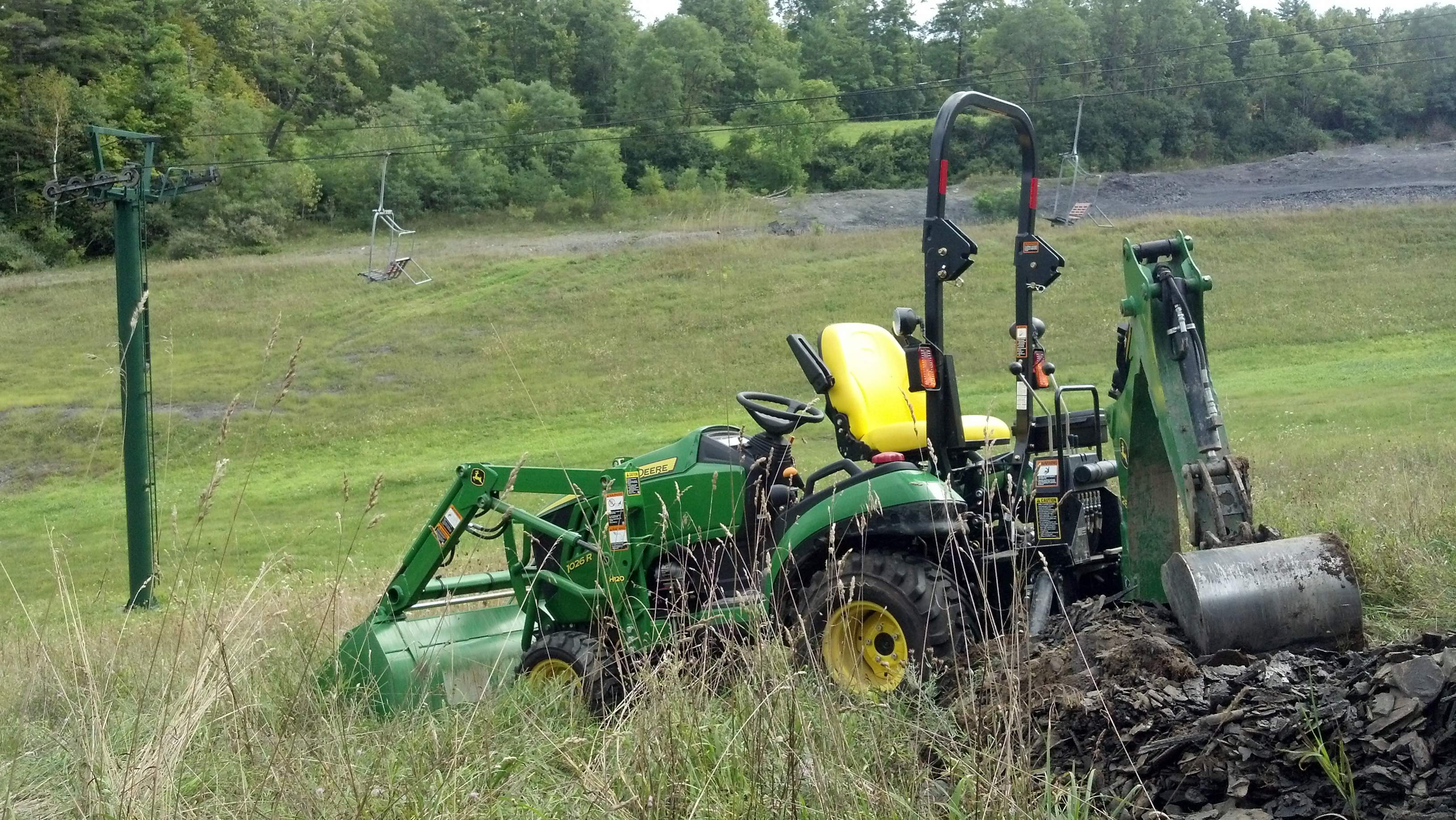

turns out the water main is on the other side - luckly only the main hydrant valve was bad
the total project took 2.5 hours to dig at 1600rpm
proving the key to the 260 is the bucket curling force
