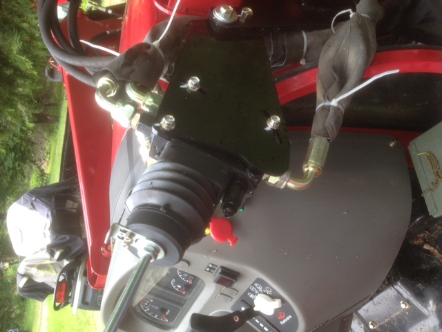

Well, getting more things and customizing the new tractor. I just got in the mail the wr long 3rd function but am not sure where the power beyond port is from the loader valve. here is a pic of the loader valve. loader valve pic 2.JPG it must be one of the top two hoses or the one on the bottom that I need to follow down. A little confusing since all three of the hoses goes under floor board on right side where one of those hoses goes to pto valve, another goes into the main center frame of tractor, and the third goes to the rear of the tractor i think to one of the rear hydraulic ports. also, there is another hose going into the bottom of the pto valve, i assume this is the pressure line.
any help appreciated. thanks.

If your dealer has a 2555 with a backhoe (assuming you don't have one), the line that goes from the loader valve to the backhoe is the power beyond line. I have a 2540, if you post of picture of the other side of your valve and it's similar to mine, I can tell you what is what. I'm replacing my loader valve with a [huge] new valve block that has loader controls plus a third function spool, with its own lever. I will then use the old valve on the back of the tractor, when I have the loader removed, to run whatever (top link, etc.)

taller port on top is power beyond

I have a 3rd function kit that I'll soon be installing on my 2538HST. Someone was nice enough on this site earlier to tell me the power beyond port is the one that has the longer fitting on top of the control valve. And yes that's the one that then goes to the hydraulics at the rear of the tractor. I'll let you know how it goes.
