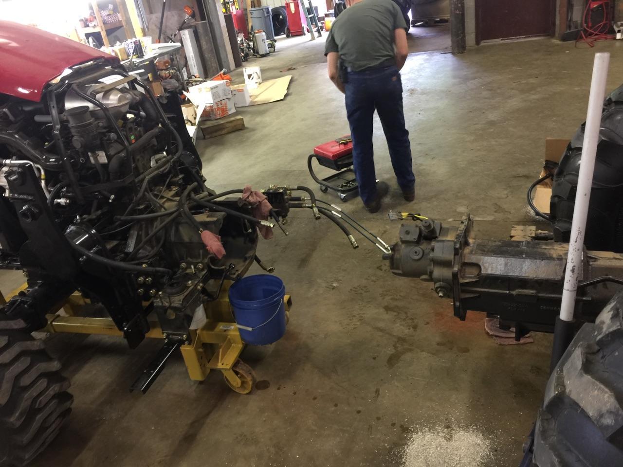

Hey Pat. Right now my transmission is being reassembled by hand and I expect it back in a week or two. It is a long drawn out story but my dealer has been phenomenal. Mahindra just so happen to drop a demo tractor off to them to put out in the field (6065 with PST) and I already have 30 hours on it even with the rains we have been having in VA.
Long and short; the noise in the video appeared, tractor went in to shop and they replaced entire PTO internals under warranty. Tractor came back with noise and over the course of 10 hours the hydraulics were overheating and the clicking was getting worse. Tractor went back in and corporate came out to evaluate... heated discussion in the garage and the mechanic tore my tranny apart (HST) and found bad bearings (gritty feeling) - he is also shimming everything to the center of tolerance - this is what the mechanic believes is causing the problem.
Not sure, but I will find out when it comes back.

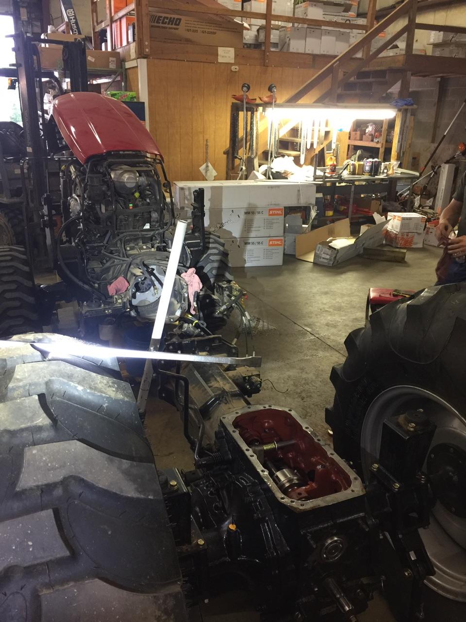

UPDATE -
The drivetrain was re-assembled (two weeks ago) with new bearings and seals, tested and still a PTO click. The dealer is still working the issue and actually used a stethoscope to pinpoint the origin of the noise; they believe it to be a clutch pack in the HST, so part has been ordered and it goes into tear down again. They believe the problem is in the clutch pack and the sound is reverberating to the output shaft because the noise from the stethoscope is very distinct in this area - not before it, but right at it and gets louder as they move the stethoscope back.
Even the owner was out there laying on the shop floor listening to help isolate the issue. I am amazed at the above-and-beyond attitude and service they are putting into this. Granted they are getting paid major $$$ from Mahindra on this and the cost will be nearly 2/3rd's of the tractor but in the end I know it will be right.
With the dealer digging they found some interesting things regarding the 2555 and clicking PTO; 40 units in the US, 27 in Europe and 20 in Asia have reported the 'clicking' PTO issue. They did not say HST only, but I can only draw the conclusion. TYM has come back and said 'this is an acceptable noise tolerance.' My dealer will not accept this because they know it is an issue because they have sold over 50 2555 with HST (cabbed and non-cabbed) with no issues. Out of the 50, 5 of them are cabbed and run a 7' Mahindra HST cutter like me and have zero issues.
The dealer is carrying the torch with an open ticket from Mahindra Corporate because they (dealer) want to isolate the issue, correct it and shove it up TYM's blow hole. From what I understand the dealer's owner has blown up the President of Mahindra a couple of times because they are not pushing back on TYM because this is a problem which will eventually manifest into a catastrophic failure for customers whose tractor may be out of warranty.
I think the incentive on my end is I am demo'ing the 6065 (which might replace the 5xxx line) and providing feedback on a weekly basis... I get a call once a week from the Mahindra Regional Rep (Graham H) and we chat about the tractor - they even took a suggestion for the PTO selector detent setting, re-engineered it and are sending out the replacement part to be installed and for me to test. I've just crossed 40 hours and expect to get more run time on it this weekend with spraying and more cutting. The dealer has told me to run the snot out of the demo unit because I have some pretty steep rolls in some of my fields.

UPDATE (yet again for those who are following)
The clutch pack and seals were replaced in the HST, tractor assembled and tested. As soon as the PTO was turned on 'click, click, click, click, click' during rotation - same issue.
I was immediately called and it just so happened I was 3 miles from the dealer so I decided to stop in. I sat down with the Sales and Service Manager and we started to talk. At this point the three of us are scratching our heads and their lead mechanic is completely baffled. The dealer is starting to draw up the paperwork for a replacement but I asked them to get me the name and number of someone @ MahindraUSA corporate so I can vent... I contacted customer service to get the issue placed on file on April 17th and received an email response on April 26th, with no follow up - I was upset to say the least with customer service.
They gave me the number to the VP of Marketing and we had a bit of 'Come to Jesus Meeting' over the phone. A statement was made by him 'maybe your dealer does not know how to correctly diagnose and repair the problem' - I immediately took offense and the entire conversation, with this statement, was relayed back to him in an email, as well as the dealer. I also pointed out that if their corporate engineer who flew out from Texas to look at my tractor could not diagnose and fix the problem maybe they should look internal.
I immediately got passed to the head of Corporate Customer Service and it looks like they are working with the dealer to replace the tractor. With all the information I have received and problems reported from the TYM rebranded units I told him if I had another 2555 delivered or any TYM re-branded tractor delivered to my property and I had the FIRST issue with it he and the VP of Marketing would be getting calls on their personal cell phones from me directly. It looks like I will be getting another model equal to or better...
We will see how this all plays out but I am soooooooo happy I picked my dealer above the brand. The dealer is hitting corporate from their side and I am squeezing corporate from the other.

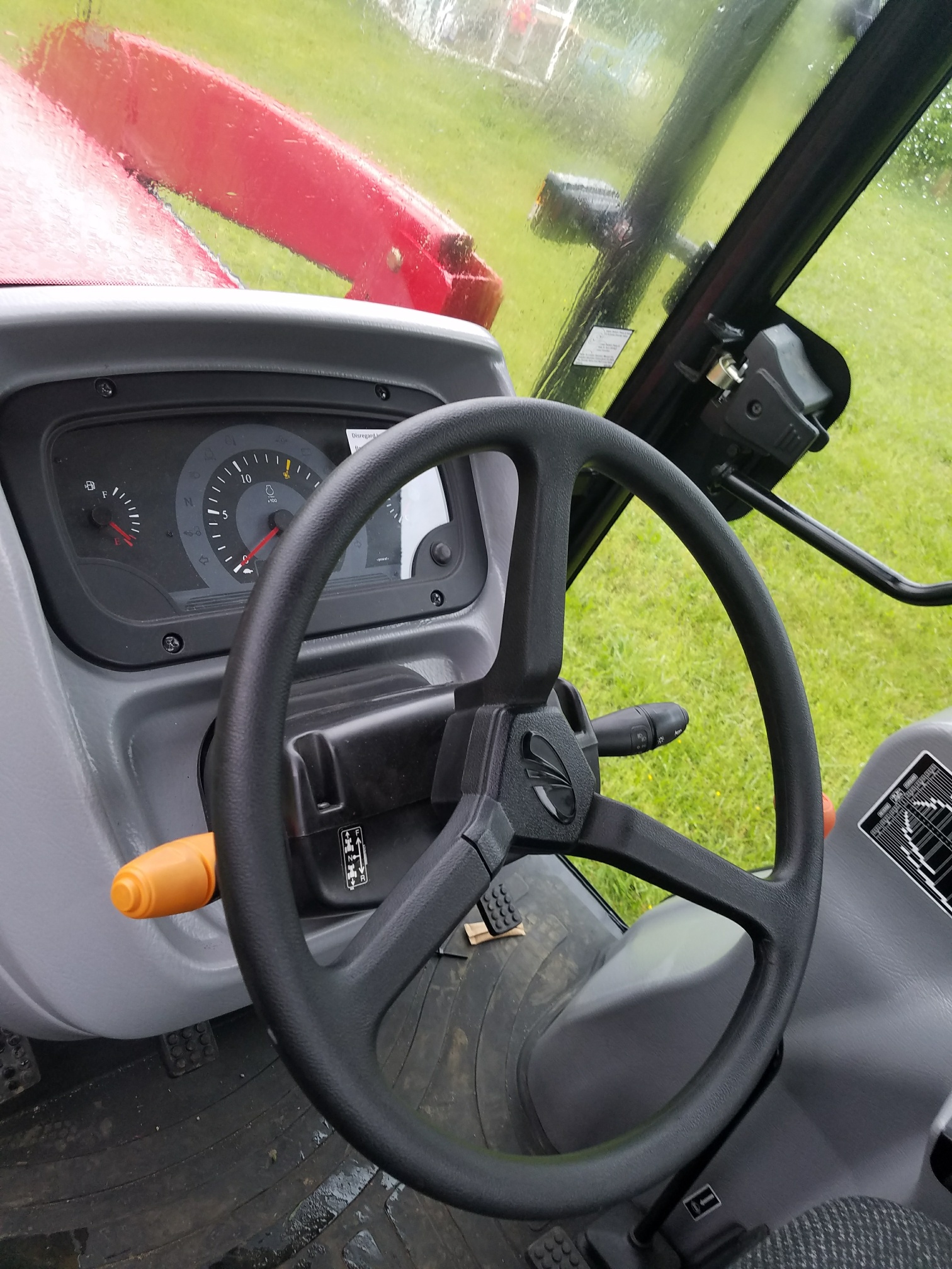

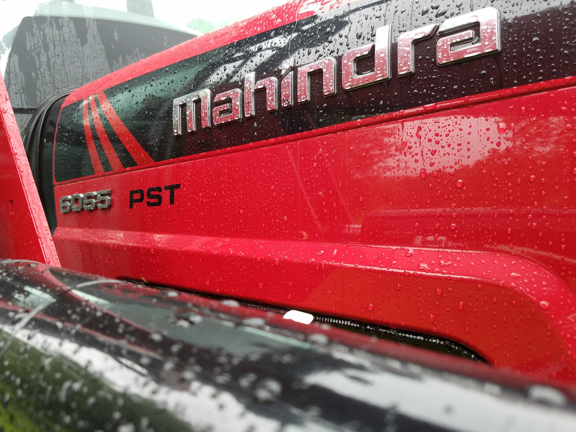

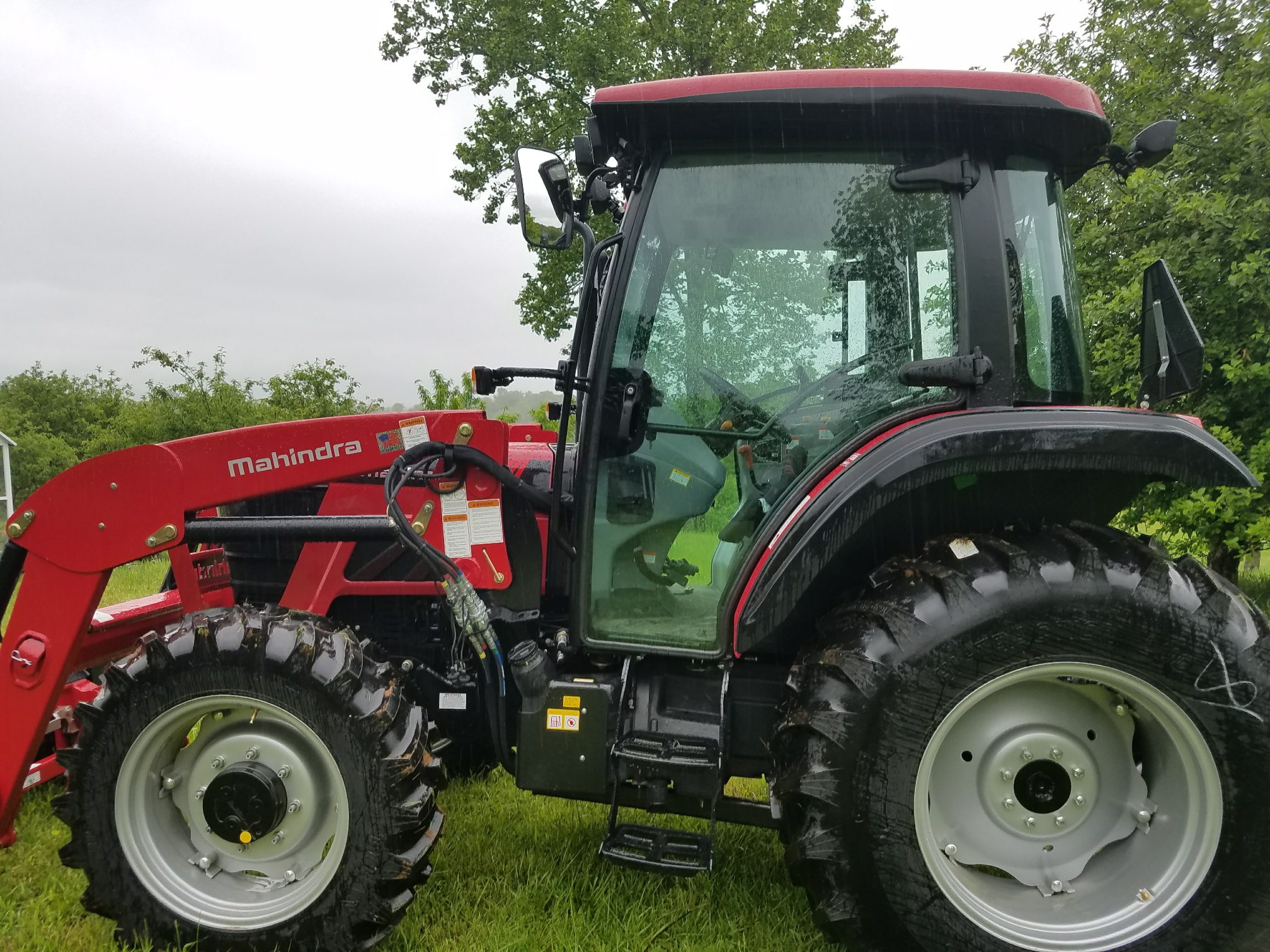

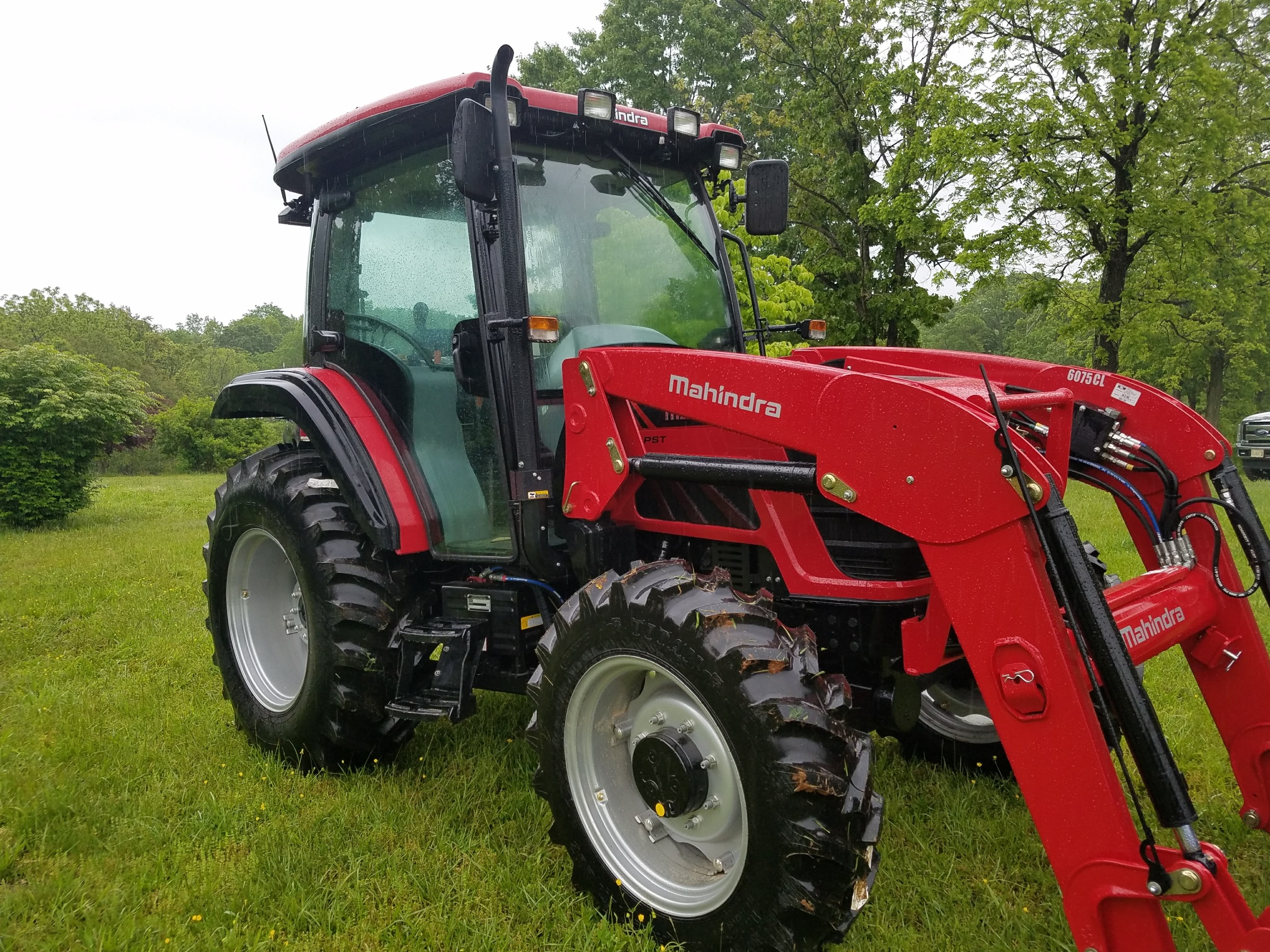

Final Resolution - Mahindra has replaced the tractor with a different model. :laughing:
For the past 3-4 months I have had the Demo 6065 and it has handled every task thrown at it. Once they refine a few things they should be coming out in the future.
Mahindra has since sent out 2 or 3 different engineers or technicians to the dealer so they could re-shim/replace bearings, seals, gears whatever you can think of from the transmission all the way back to the PTO with no resolution. They even had it sit outside at idle, PTO engaged with nothing connected to it, stub shaft spinning and after 60 minutes you could not touch the rear casing because it was too hot.
This has stumped the company so they upgraded me no questions asked with no money out of my pocket for my time and trouble. Plus providing them valuable feedback on the demo pre-release model has helped them add needed changes before they go into manufacturing.
