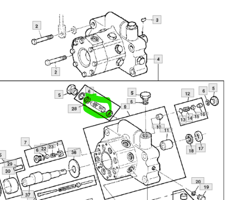

With engine operating at idle speed in order to de-stroke pump turn DS screw clockwise until it stops then turn DS counter-clockwise until it stops turning. Be sure to check pump shaft to be sure it rotates when engine crankshaft rotates. De-stroking screw is encircled in green. HTH's, Jim

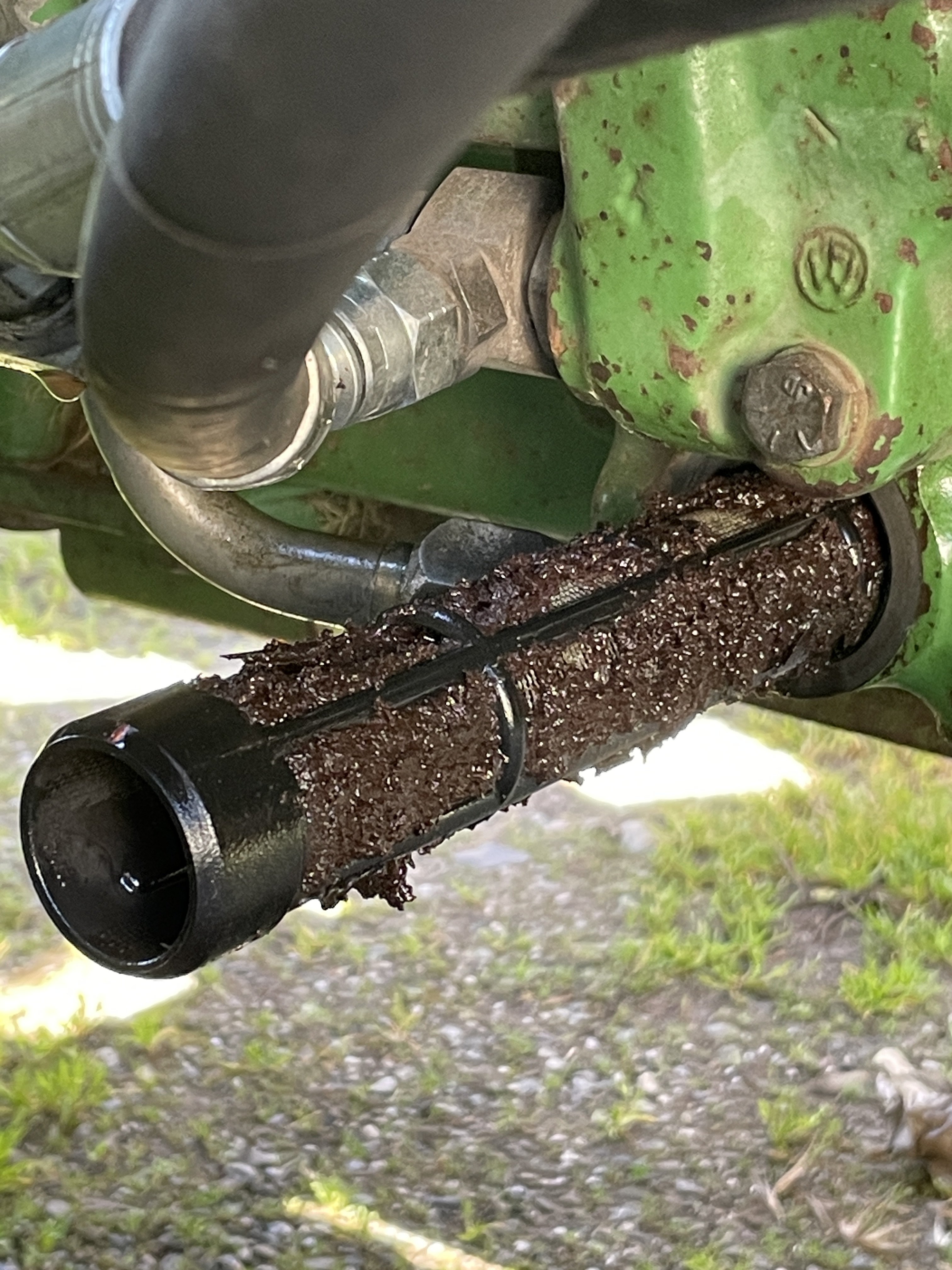

I can't find the link where I am supposed to post a new thread, but since this is totally related to what I am experiencing on my 2355, and the last post was at the time my problem began, I hope no one minds my tacking on. It has 1,600 hours since new. I began experiencing hydraulic problems with the loader, which had previously happened because the fluid got a bit low due to a couple of worn out hoses and a leaking ram, which I had repaired. But after checking the fluid level (it was good) I resumed working and all seemed well again. Since it was a kind of pulsating pressure issue I assumed it was air in the lines.
Shortened story: drained fluid, changed element filter (old one looked good) and put in new fluid. Same issue, when driving tractor (mostly use it with a 10 foot flail mower) everything worked fine until I started using the loader a bit. Then the "shudder" began and the loader finally crawled to a stop. But after a couple minutes of rest, allowed to idle or just drive, even while mowing, loader would resume working. If I tried to run it long enough even the non-ram steering would also stop intermittently. JD dealer told me it might be the fluid recirculating pump. Basically a low pressure lift pump that keeps the main pump reservoir full. If so, I would need to split the tractor to get to it.
After consulting here and some utube videos I found there was an additional "pickup screen" in the lower case, which I was not aware of, and had never changed or cleaned. Well, after I redrained the sump and pulled the big filter housing so I could clear the hyd. lines and get to the large, inverse hex cap/cover and the one on the opposite side (which oddly takes a slightly smaller and less common allen size) I was able to push out the nylon screen, and it was obviously the cause of some blockage. (And yes, do I feel stupid for not knowing this was there!)
At any rate, it seems that it slowed down the supply of fluid enough that the supply tank above the main pump would run dry if the demand was too great. After cleaning it out and trying to get any remaining crud out of the lateral, transverse hole where it resides, putting all back together and refilling fluid, it ran just like new again. For about 2 weeks. Now it's doing the same thing, and my first instinct is that the filter has picked up some residual crud, and must therefore be removed once again.
But now after reading the rest of this thread I think I may also need to destroke the pump seat as explained above. I will also likely pull the screen out again to check and was now wondering about the possibility of pulling that without draining all the fluid. I know I'll probably loose some when I pull the caps, but will it completely drain? By all the photos and descriptions, it looks like the 2355 and 2555 have nearly identical layout as what the OP's tractor has, and for sure the pump.

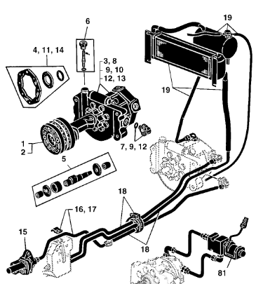

Your tractors front hyd pump could have a filter depending on which front pump you tractor has. One can check/clean hyd oil suction screen by inserting an operating shop vacuum hose nozzle into open hyd filler then remove screen for visual inspection. What type hyd valve controls FEL(SCV or ind)?

The picture you posted of you screen looked as if it may have been clogged with brake lining material. If so it is probably clogged again. If you clean it again, spread some aout on a white towel and post a picture of it. May be able to identify it better. You do need to drain all oil to remove it. Some people use a shop vac to pull vacuum and pull it out without much loss, but I feel the vacuum pulls some of the debris off the screen and back into the oil in the process, so I don't like doing it that way. Also can clean out bore where screen comes out better.

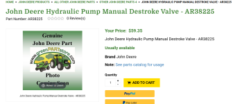

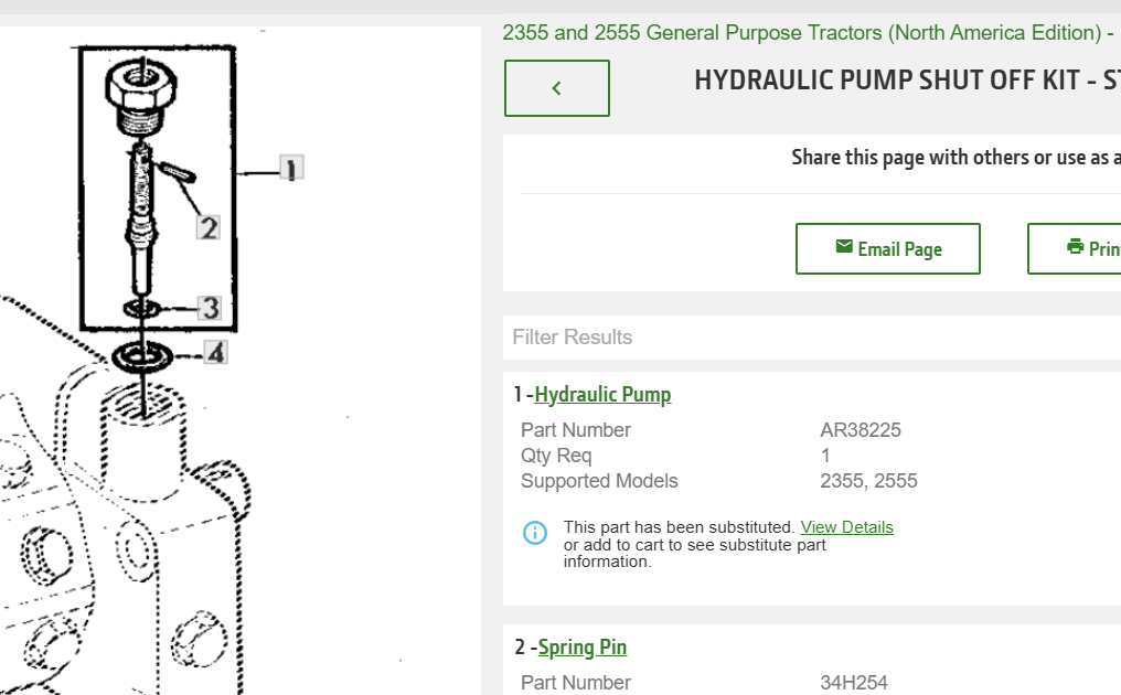

Does anyone here know where I can get the De-stroking screw/kit mentioned above? I called the dealer who put me through to service, and the technician hadn't heard of one. He did get back to me with a diagram and some part numbers, but he said the kit was no longer available. I don't see in the parts the number for the hollow nut that reeplaces the cap nut at top, which is internally threaded to recieve the actual DS screw. If I knew the dimensions and length of the parts I could just acquire the parts individually. Though that would be a real pain.
   / 2550 hydraulic problem #30

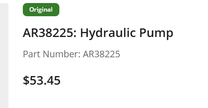

If JD dealer parts personal that can't locate info on 2355 hyd pump destroking screw & parts on that part # he needs to get a different profession/job. Last photo lists the part #s that AR38225 could sub to. John Deere AR38225 Kit | eBay
