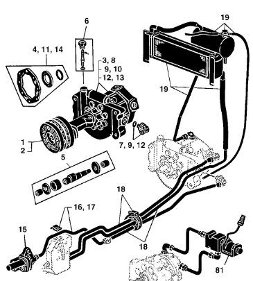

Good morning guys
My tractor is a 2550 built in 1985. I am visiting my cousin in North Carolina, and we have been working my tractor pretty hard the past few days. Long story short, the hydraulics seem to have quit. On Friday there were some chattering in the hydraulic lines but once I idled it down and back up it seem to be fine. This happened at least twice on Friday. Yesterday Saturday, everything seem to be working well and I moved a lot of debris. I was attempting to move some dirt and we got off the tractor and back on it and now the hydraulics will not lift the bucket or the three-point hitch. Steering seems to work fine oil is full and clean. I was able to get the tractor back out of the woods but I am not sure I will be able to raise the bucket enough or the three point hitch to get it up on a trailer. I have read and similar post to try to raise a three point and look inside the rear housing for oil leaks. I will do that after church but at this point all my tools and equipment are back and Georgia. I am without my pressure tester and being unable to check flow do y’all have any thoughts? The only thing I know for sure at this point is the power steering works fine and it’s full of clean oil.
Thoughts please?
/ 2550 hydraulic problem #2
If power steering operates correctly it's possible stand-by pressure which should be 2250psi has lowered to 1700 psi. This lower psi allows pressure control valve(item 15) to block pressure to 3pt hitch, scv & fel control valve. It's also possible stroke control valve isn't seating as designed due to foreign material in seating area. If your tractor hyd pump has a de-stroking screw(item 6) one can with engine operating at idle speed turn de-stroking screw CCW to open stroke control valve then turn DS screw CW & if you're lucky foreign material if present will be dislodged from SC valve seating area. You could if de-stroking SC valve doesn't solve pressure problem possibly attempt to back your tractor on trailer dragging bucket rearward.
Thank you very much. I will try this after church today. I believe my SC is
at the bottom of the pump if it’s the same one that controls the pressure.

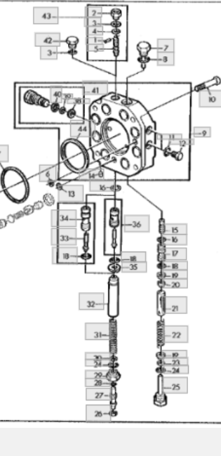

/ 2550 hydraulic problem #10

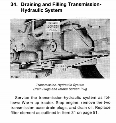

Photo below shows trans oil screen location. DO NOT TURN STROKE CONTROL VALVE SCREW without possessing a 5000 psi gauge to check stand-by pressure which should be 2250 psi! I think you're confusing "stroke control valve'' & "de-stroking valve". De-stroking valve if present will be on upper side of hyd pump.
Keep in mind over the yrs many hyd pumps have been replaced WITHOUT PERFORMING GOOD HYD DIAGNOSTICS only to determine that the replaced hyd pump in fact was good & not the hyd problem!!!!!!!!!!!!

/ 2550 hydraulic problem #14
My plans will be to back off on the de-stroke valve while idling. Then check screen again, and change hyd filter If needed. Does that sound correct? About how far can I back out the de-stroke valve?
Thanks again
Are you referring to de-stroking screw(item 43) or stroke control valve(item 27)? The 2 valves have different applications? De-stroking valve is turned clockwise(in not out) to open stroke control valve seating area to stop pump from pumping oil. Then de-stroking screw is turned CCW to allow stroke control valve to seat allowing hyd oil pumping to begin again.
Good Morning Jim
I am glad you are willing to help, so thanks again. I have been reading through this a few times and I do think I understand (now anyway) what you are telling me about the de-stroke valve (43) so I will look for it on Tuesday. I just returned home last night from Florida and I have Japanese Pastors in for the weekend, so I will go down to the camp on Tuesday to pick this back up.
If I do have a de-stroke valve (at the top of my pump) I will turn it clockwise to release the seat while idling. Then after a few moments I will bring it back to let it reseat the Stroke control valve. Whether that works or not I will pull the screen and check it, just to see if there is anything there.

/ 2550 hydraulic problem #16
You're welcome
When you remove plug to access hyd oil screen be aware you need to block off hyd filler hole with something so as to create a vacuum or drain hyd oil reservoir. Yes one utilizes de-stroking as you stated.

Hey Jim
I am going down in the morning to work on my tractor and I do have another question, if I may. Does 42 screw into the top of 43? I found a picture of my pump “I took in the past” and that’s what it looks like to me. I believe I do have the 40 CM pump.

#18
IT WORKED!
Praise the Lord and thank you very much Jim!
This is what I did. I pressure wash away the dirt and grease so I could see what I was working on. I installed my pressure gauge and checked pressure. The pressure at idle was bouncing from 500 to 600. Then I backed out (CCW) the de-stroke (43) about 3 or 4 full turns and pressure was still about 500. I let it run for about two minutes then, I started turning in the de-stroke screw in. At some point I heard the sound of the pump changed, and the pressure started coming up. As I turned it back in the pressure came up to 800 then 1000 and by the time it was seated back into place it was at 2350. With everything back in place I backed off on the stroke control so that the pressure was set at 2250 at idle. FEL and TP worked as it did before I had this problem.
