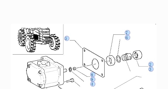

It uses a steering pump, rear pump on LH side of engine and main hydraulic pump on the front side. May be an air leak on the suction side or broken drive or shaft

I think you're both confused. The TN series has two pumps, both on the RIGHT side of the motor. The one on the front of the timing cover is hydraulics, the one one the rear (under the injection pump) is steering/transmission circuits. They share a common suction and filter, and each drive off opposite ends of a timing gear Fiat refers to as a PTO gear.

Oops, right, left sorry. It is the right front. Two pumps mounted on engine cover

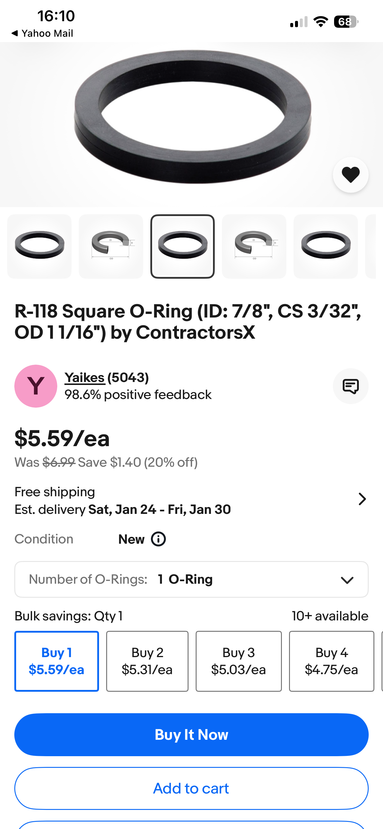

/ NH TN75 Hydraulic Problem
#12
Just putting in new o-ring in the elbow that feeds hydraulic fluid to the front hydraulic pump fixed it. However, I wasn’t too sure how long a round cross-section o-ring would last in a groove made for a square cross-section o/ring. So, I bought a few of these off eBay, and it seems to be working fine. Pulls hydraulic fluid like it should and holds prime fine as well.
