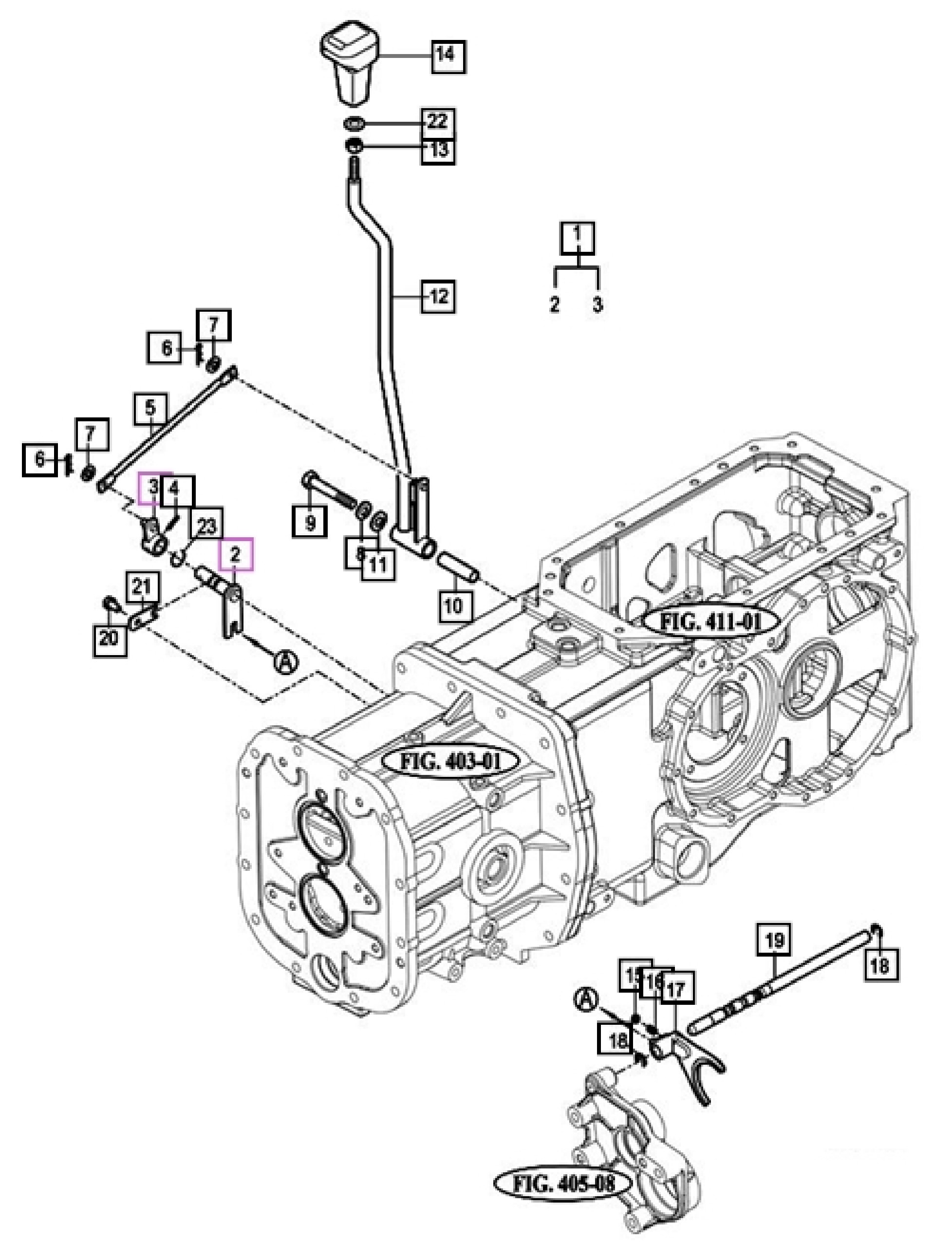

I don't think I can get a camera in there. It is all black too.
Look at the sub range shifter. There is a rod connected to it with a washer and an a cotter pin on the bottom. Follow that rod. It connects to a small lever on the side of the transmission, also with a pin and washer. When you move the sub range shifter, it actuates the other lever (bellcrank) to shift the ranges. There is a 12mm bolt next the the bellcrank. I backed it off 1.5 turns, and it relieves the tension. Then the lever would move. I hooked the rod back up, and was back in business! Greased it up good, now moves through the gears very smoothly.
   / 2538 will not shift out of high range #13
Guessing the rod you're talking about is part number 5 in this diagram and the bolt you backed off is part number 20 and the part you jiggled is part number 2?

Exactly! Thanks, I tried to find that diagram but couldn't.
To gain access to the bolt, I had to remove the pedal linkage and push it out of the way. The bolt is hidden behind it.
Thanks for the graphic! Huge help for me.
