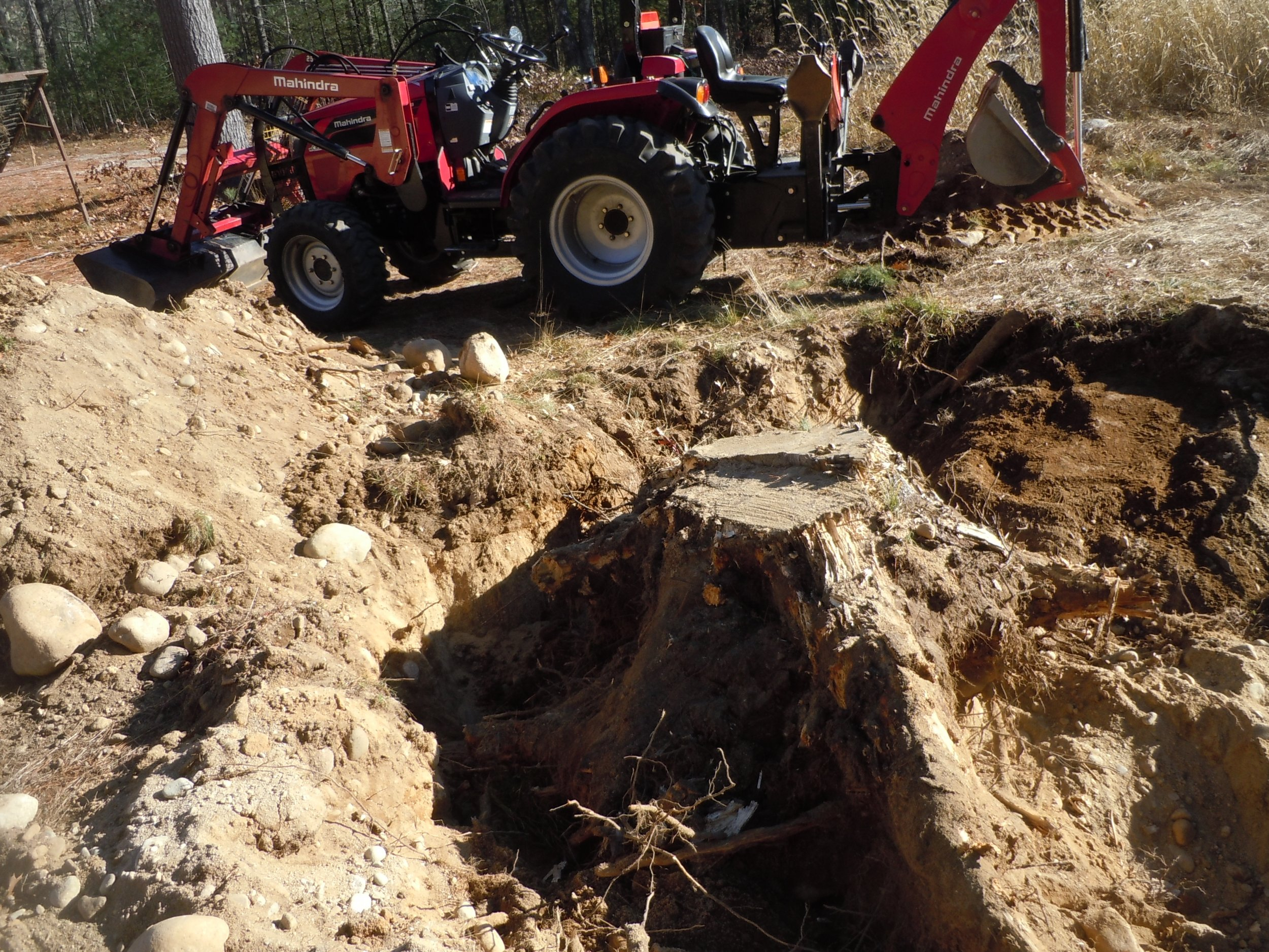

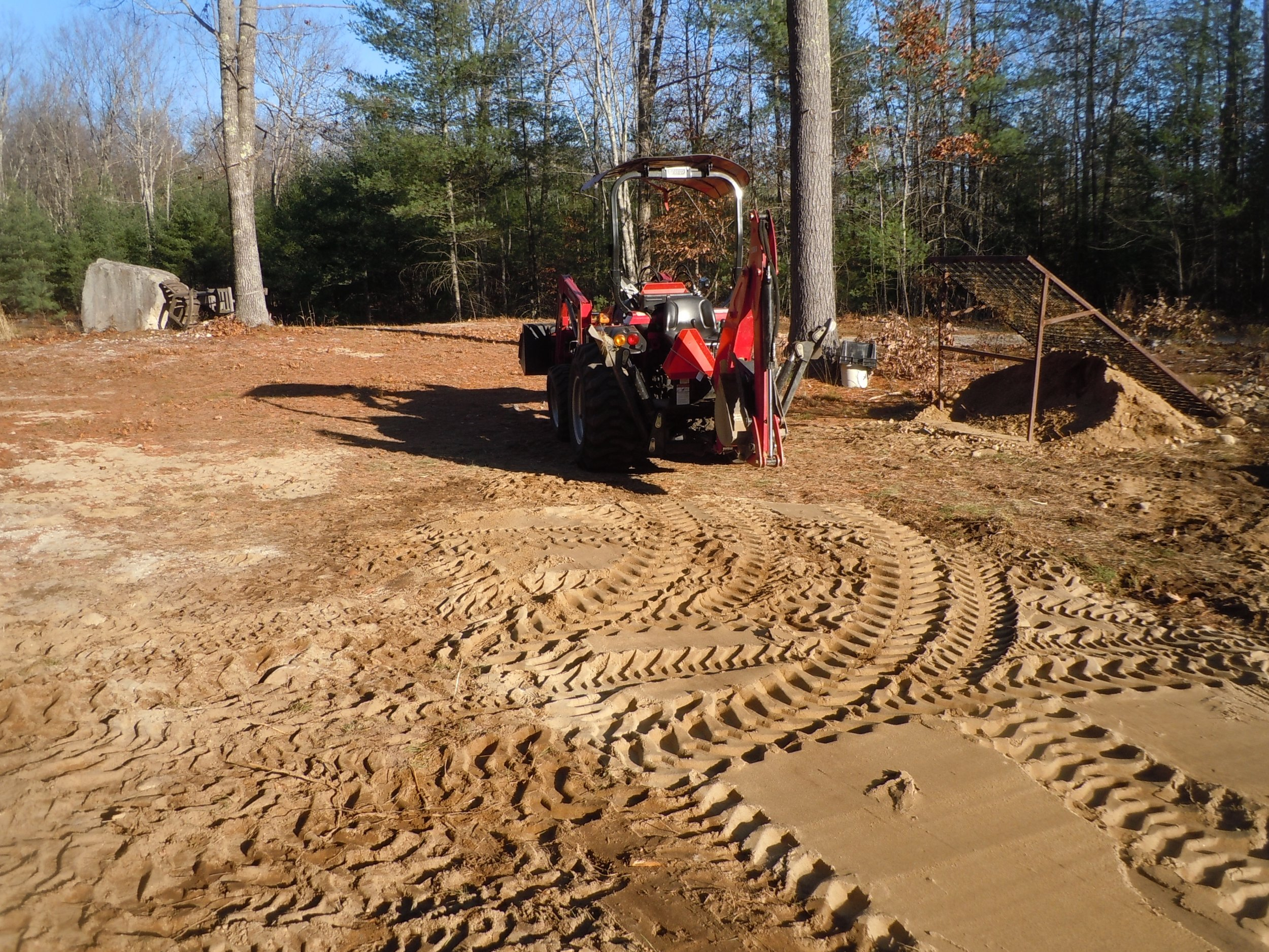

After 4 long months my pump finally arrived at dealer and I am back in the saddle again! Lots to do before we are buried in the white stuff. Thanks for all your ideas and suggestions. I'm going with "All's Well That Ends Well!".. DSCN2588.JPGDSCN2593.JPG

After 4 long months my pump finally arrived at dealer and I am back in the saddle again! Lots to do before we are buried in the white stuff. Thanks for all your ideas and suggestions. I'm going with "All's Well That Ends Well!"..View attachment 769782View attachment 769783
