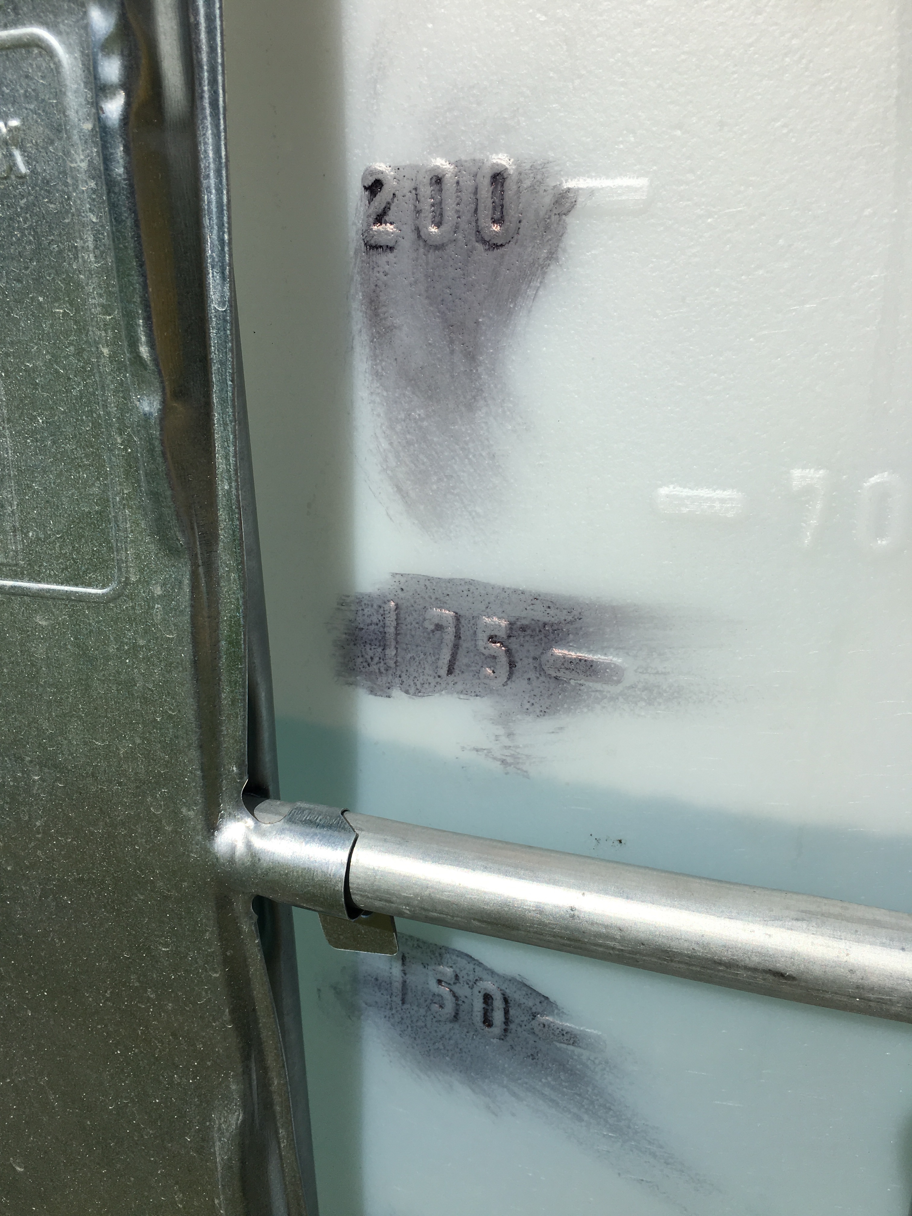

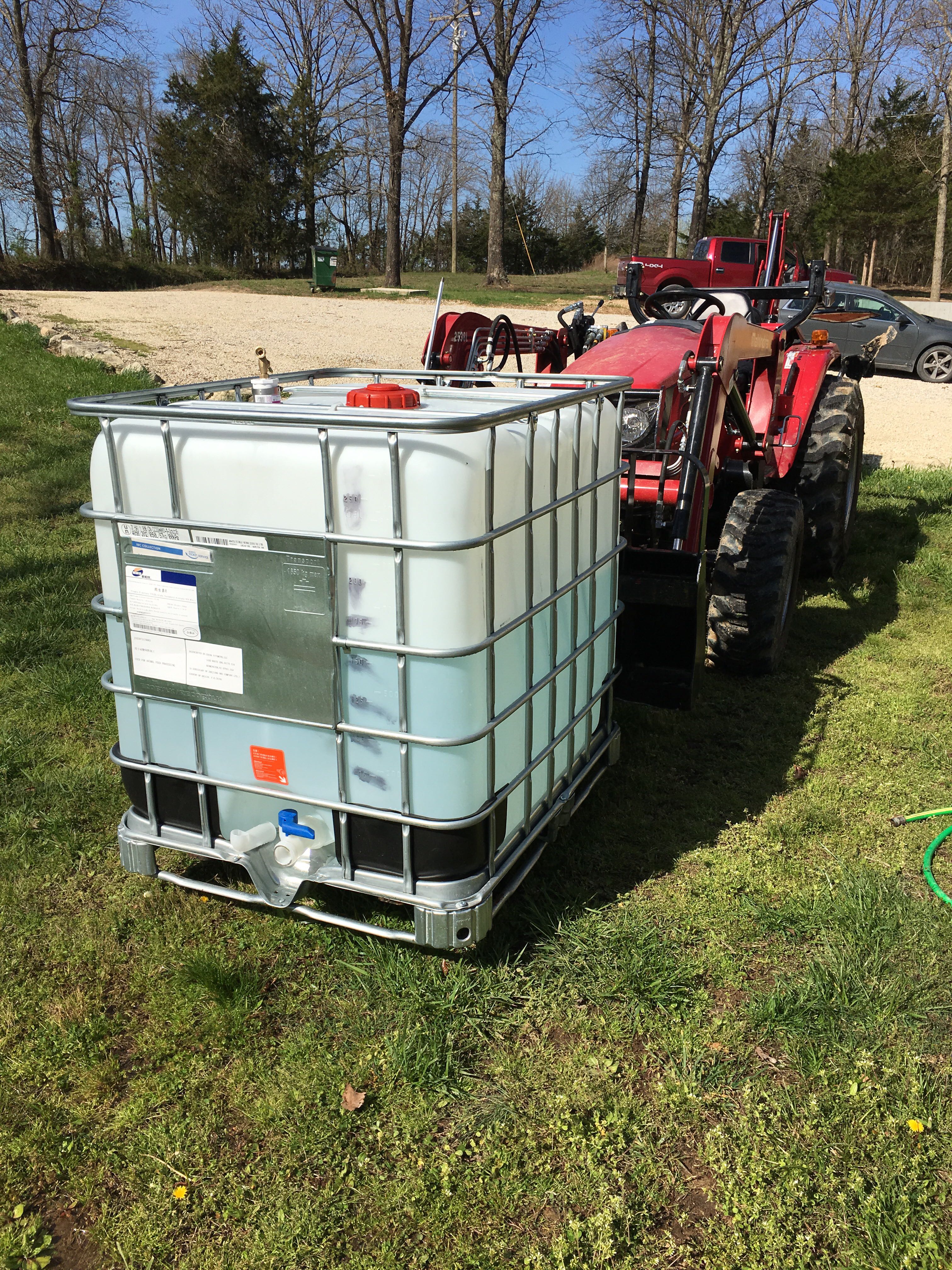

I was power washing vegetable oil out of an IBC tote this morning which gave me a great opportunity to test lift capacity. Mahindra's published loader capacity is 1634 lbs. I estimate I had 170 gallons (1417 lbs) in the IBC tote (100 lbs) and the machine had no issues lifting it. It would not lift at 195 gallons. (1626 lbs + 100 lbs IBC) I assumed that my forks would be a little lighter than the bucket which would have increased the capacity but that was not the case.

The weight Mahindra gives is measured at the pins to maximum height. You are lifting 1517 lbs plus the weight of your forks (usually about 150 lbs) and the weight is way in front of the pins. So your loader is probably working right. You were able to lift about 1667lbs.
/ 2538 Lift Capacity #6
Its working correctly.. remember loaders lift are measured at the pins.. the further your distribute weight forward of those pins the capacity will drop.. with the bucket your able to scope and curl back putting the weight almost on top of the measured poundage
/ 2538 Lift Capacity #7
Yep. Lifting that weight out on the forks would mean his loader was actually lifting more than the rated capacity at the pins. It's working fine.
