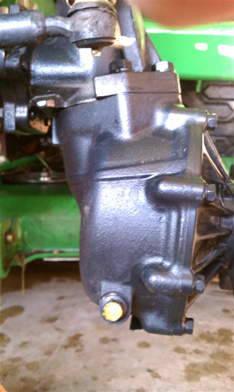

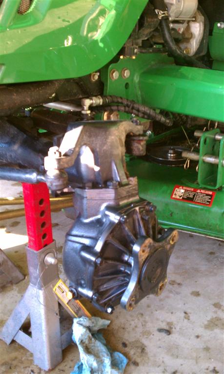

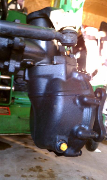

Before i can upgrade the 2520 I need to get this front end seal fixed.
I'm having a hard time figuring out which seal is it that went out.
Tonight I cleaned the hub and everything around it and hoping by morning i can find a wet spot where the fluid is leaking out. But i was wondering if any of you knew if there is a common seal that goes out around the front hub and if so what did I do wrong to cause it to fail on a tractor with only 200 hours that's used 90% of the time as a lawn mower. I will admit i have loaded down my bucket good a hand full of times. could this be the cause?
I've attached pictures of the area that's leaking. any help would be great. Also any advice this taking apart this area would be great also. from the break down there are a lot of little parts inside there.

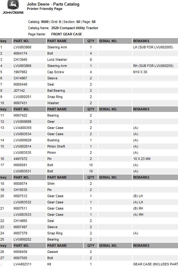

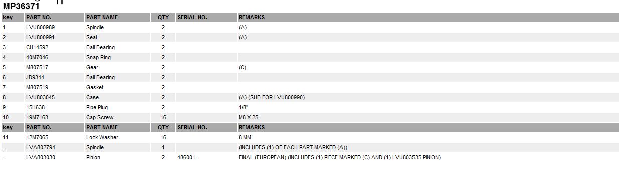

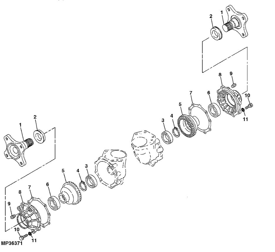

I posted two more pictures. Which seals are the wheel seals? I'm just making sure i got the right ones. even though these questions don't make me sound like it i'm pretty mechanical and can rebuild about anything. Just don't want to rip into it any deeps than i have to.
The two seals I purchased are 7 and 22. (See Picture)

Nope... the ones you bought are the spindle shaft seals. You're not looking at the right page in the part manual to see the "wheel seals". Looking the MFWD Final Drive section for the seal and/or wear sleeve for the stub shaft.

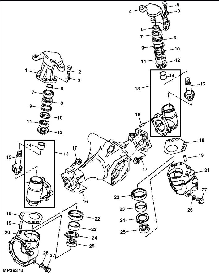

Dang I was wondering if those where right didn't seem right when i was at the dealer hmmm.
I attached a break down of the hub wheel area.
2 and 7 ?

Yes... you will need the gasket, #7, because you will need to take the cover off the housing to remove the snap ring from the stub shaft. Then remove the stub shaft from the cover/ring gear. R&R the seal and put it all back together. Very easy to do.
I see by that breakdown that JD has "cheapened" the design. It's basically the same as my 955, except that the 955 has a replaceable oil seal wear sleeve on the stub shaft. On the design you're working on, you'd have to either replace the stub or track down a Speedi-sleeve to repair the stub shaft if the oil seal surface becomes worn or grooved.
/ 2520 Front end seal. Need help please #8
Yep, number 2 and number 7. Mine went on left side 2 days shy of 24 months, covered by warranty. Same one again 3 1/2 months later - no warranty, repairs only guaranteed 90 days. Service Manager had no explanation for failures.

My dealer machanic seemed to indicate the problem is with the seal part #2 that shows in the latest diagram you attached. I'm just going by where he was pointing when he told me about it. But, I never did see whether you found the leak was on the stub axle shaft or on the steering pivot. I suppose either one could leak especially since the oil is filled up half way into the differential case.

I think it's #2 seal.
That is where it looks like i'm losing fluid.
