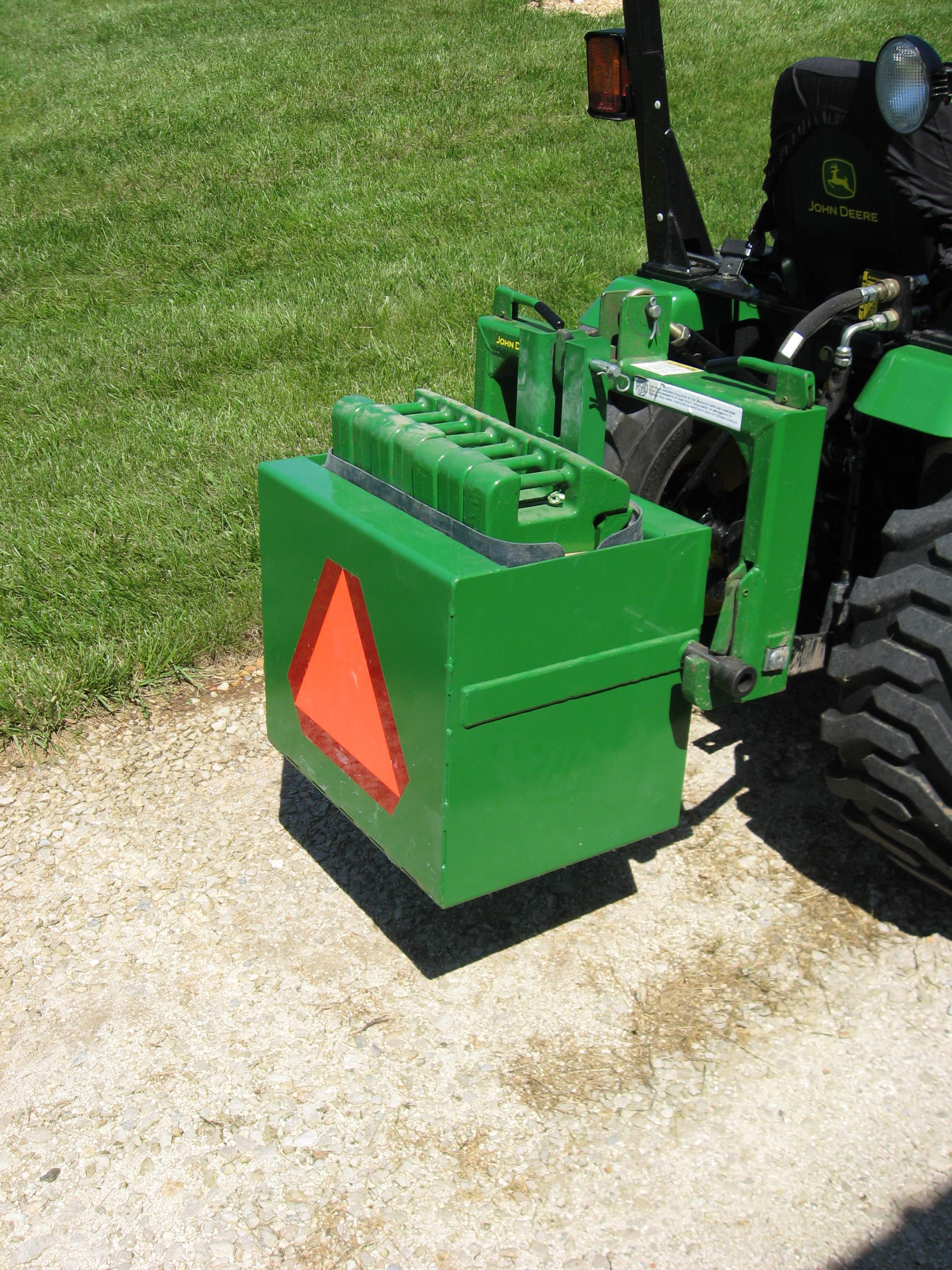

/ 2520 ballast box #8
I had a couple of issues to address when I got my ballast box. I didn't want anything "permanent" in there. I also needed a place to store my 42 lb suitcase weights. I killed both birds by doing this:
I lined the box with sheet plastic. Then I placed four, 80# bags of concrete in the box with pieces of sheet plastic between each bag. This way, if I ever want to empty the box, all I have to do is smack the concrete with a hammer and it will crumble so I can remove it. The sheet plastic will act as a bond-breaker.
With 4 bags of concrete in the box, I had just enough room for my (8) 42 lb suitcase weights. This brought the total weight of the box to 809 lbs.

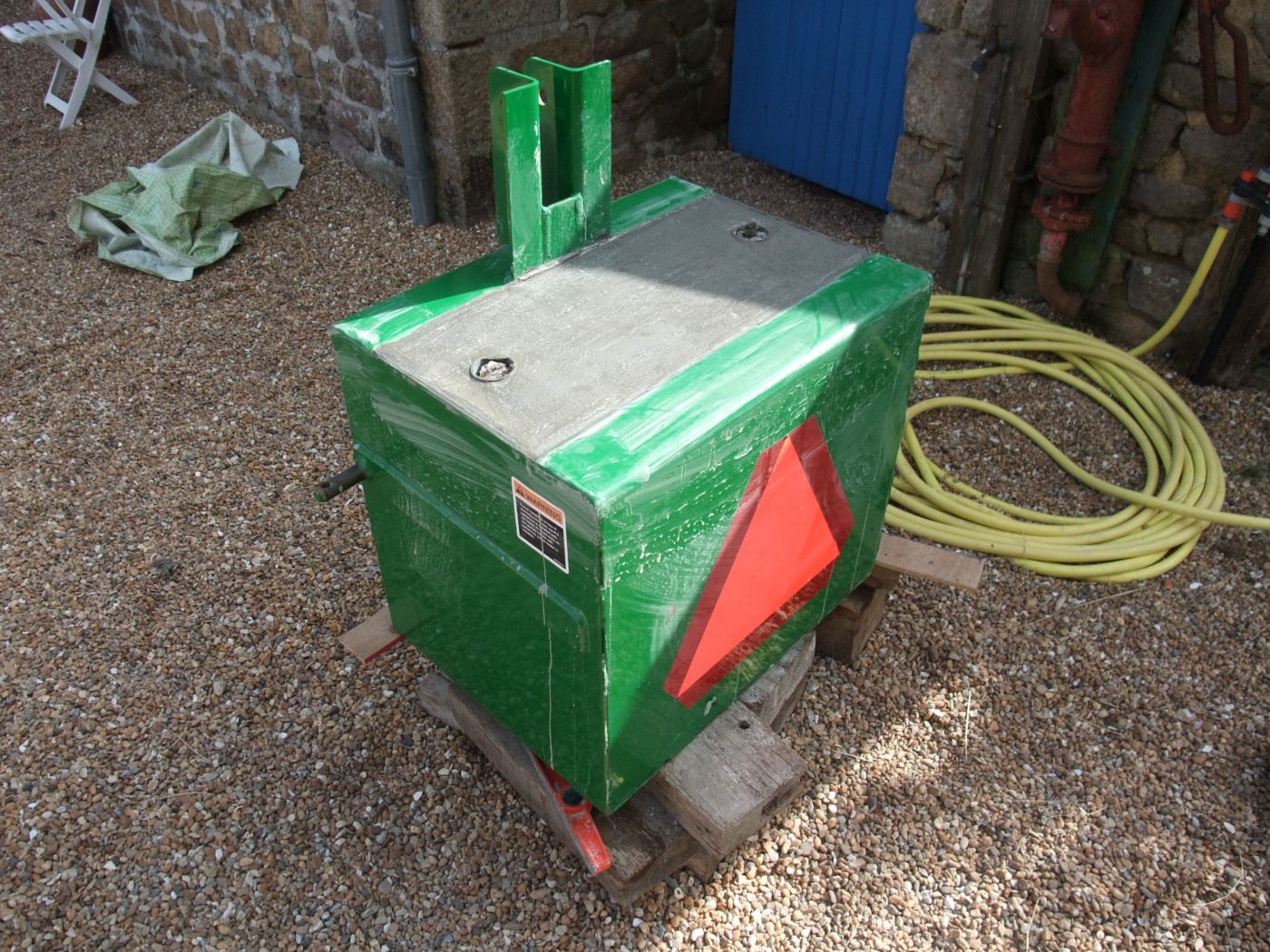

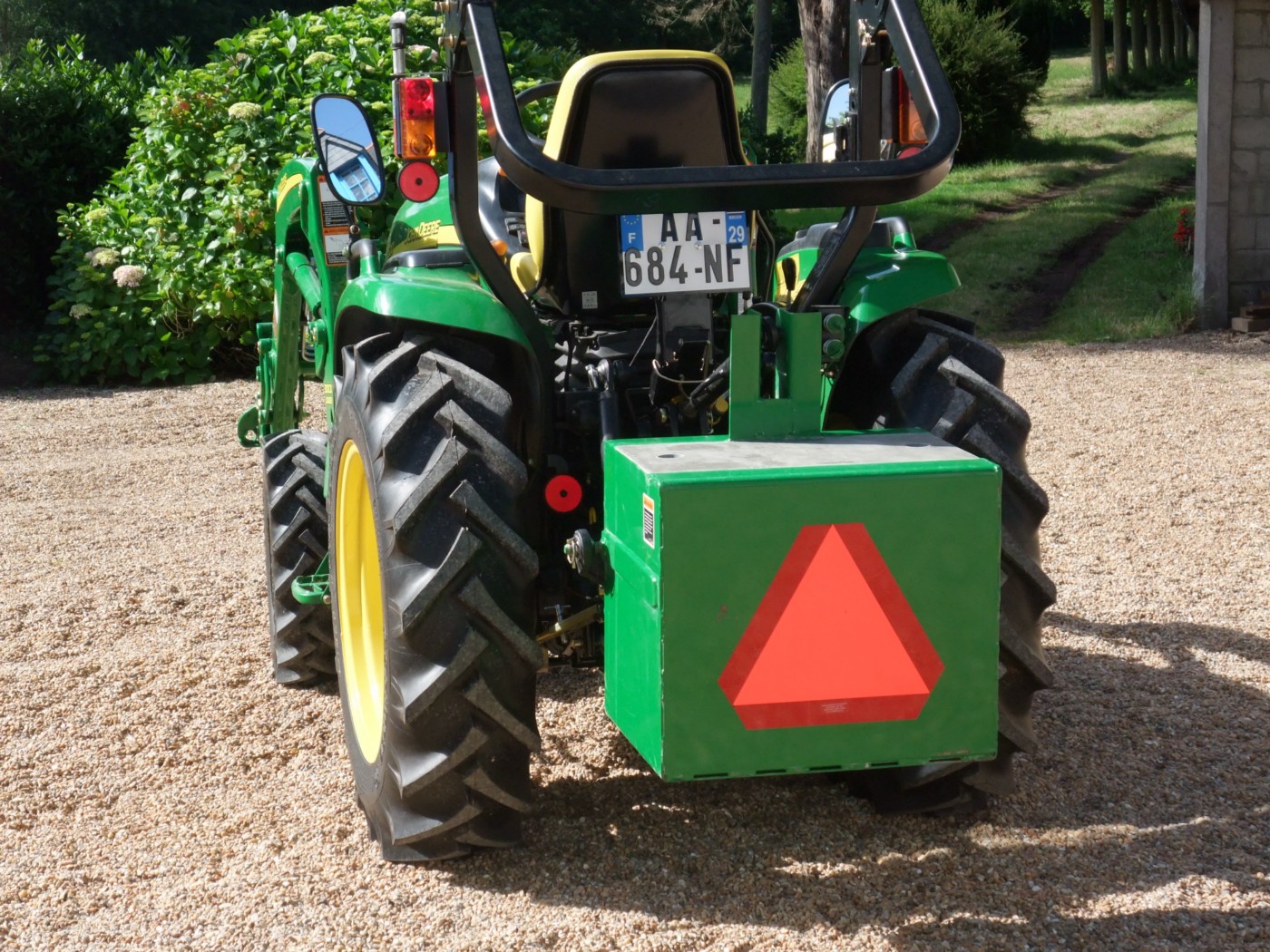

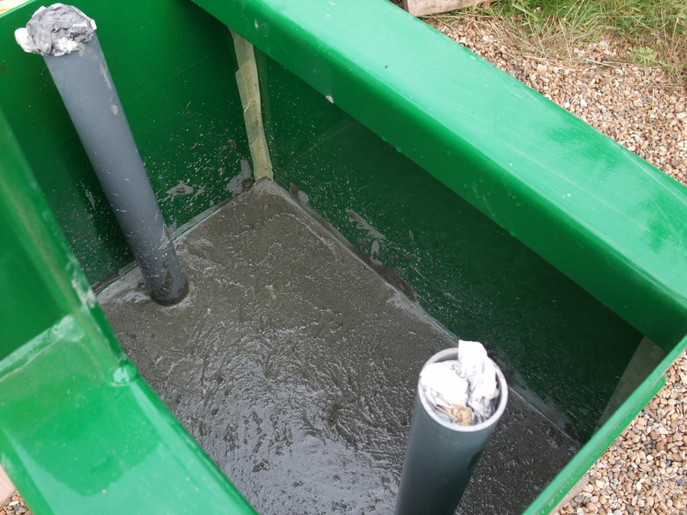

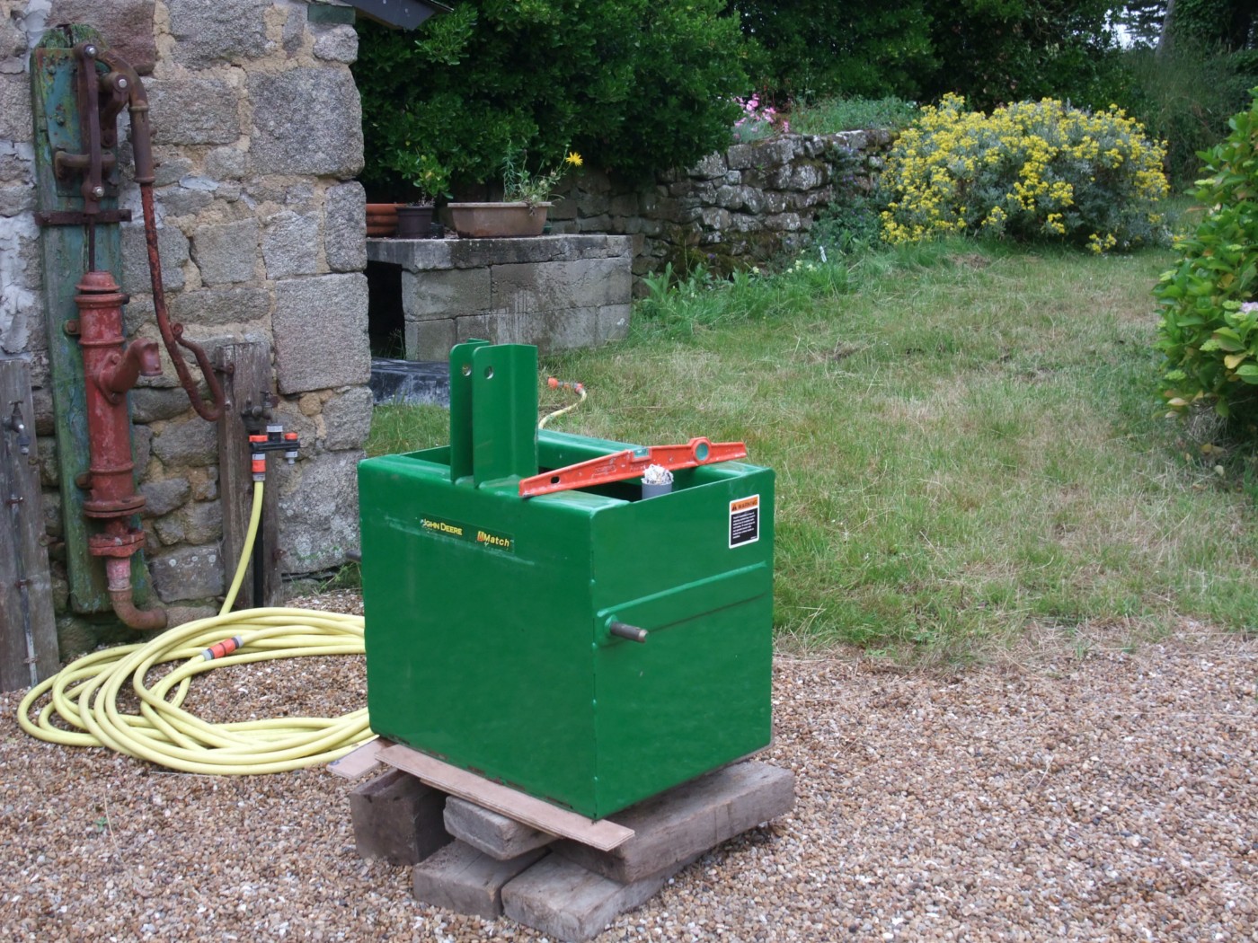

/ 2520 ballast box #9
The standard ballast box is quite heavy enough to compensate for any weight you can have on the front. Filled mine for the 3520 with concrete and find it rather too heavy, even with a bucketful of gravel or stones.
