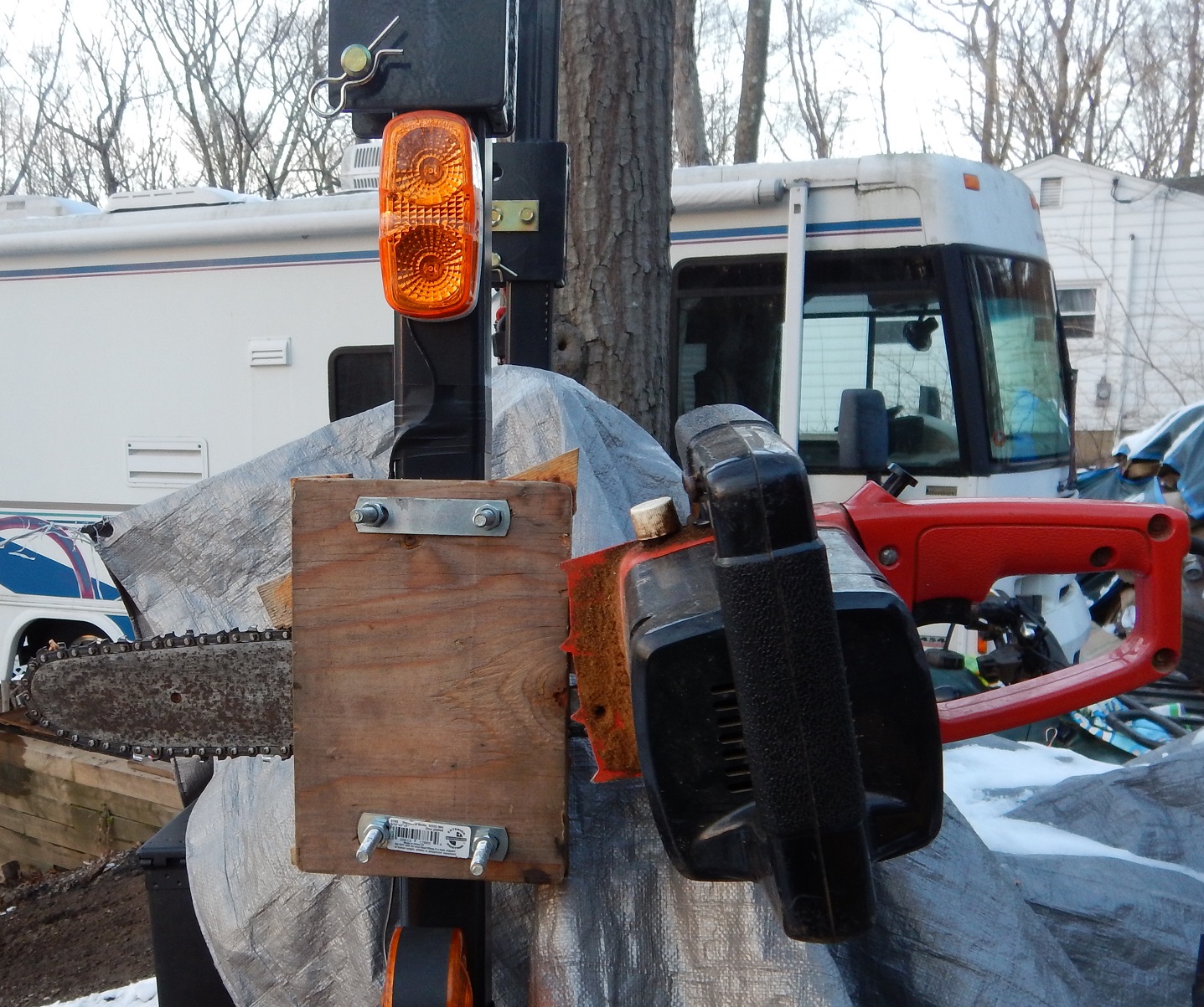

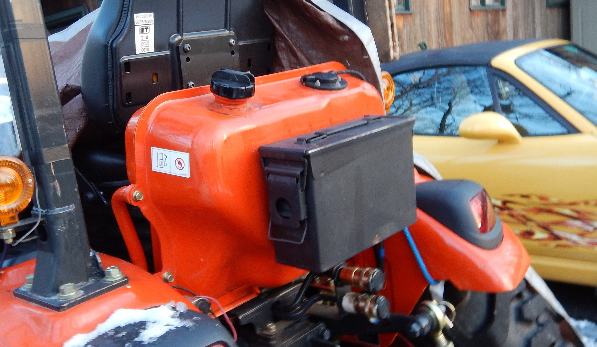

On a side note, I found a spot for a toolbox.
/ 2510 50hr. Service #33
I was going to upload pics of my tool box and chainsaw holder but it doesn't work
You need to make sure that the pix are under 1Meg in size.. anything larger will not work. Win 10 has a built in pix resizer, just right click on the pix and resize will appear. or the fast stone image resizer will work.

DSCN1437.JPG Tool box
DSCN1438.JPG Chain saw holder. I'm gonna paint it black. The electric saw is in there just for demonstration.
I got 3 led lights to mount to the ROPS; just making the mounts.
/ 2510 50hr. Service #39
I took off the bracket that hold the upper-link clip and the slow vehicle sign and used that bracket
