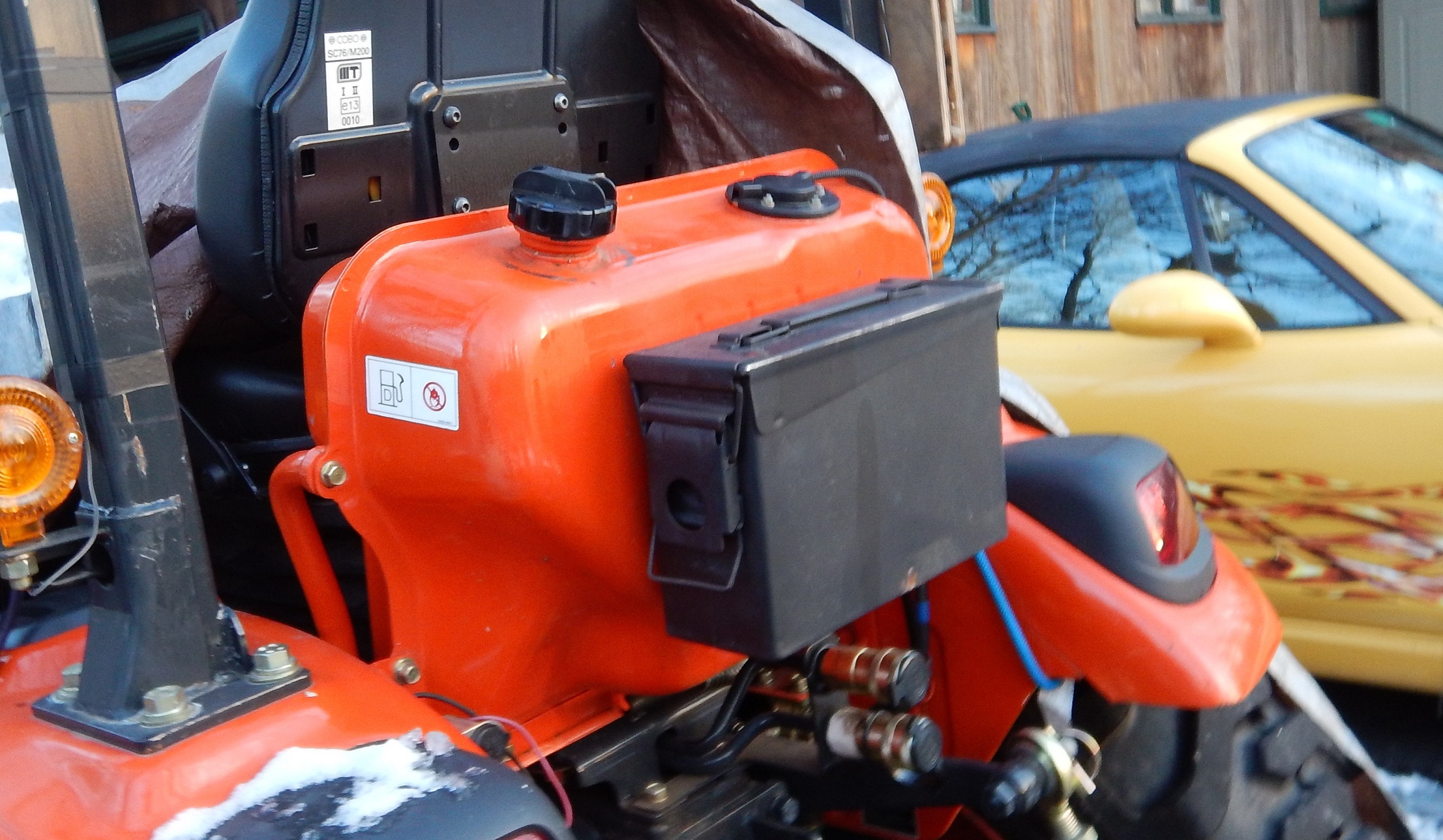

On a side note, I found a spot for a toolbox.

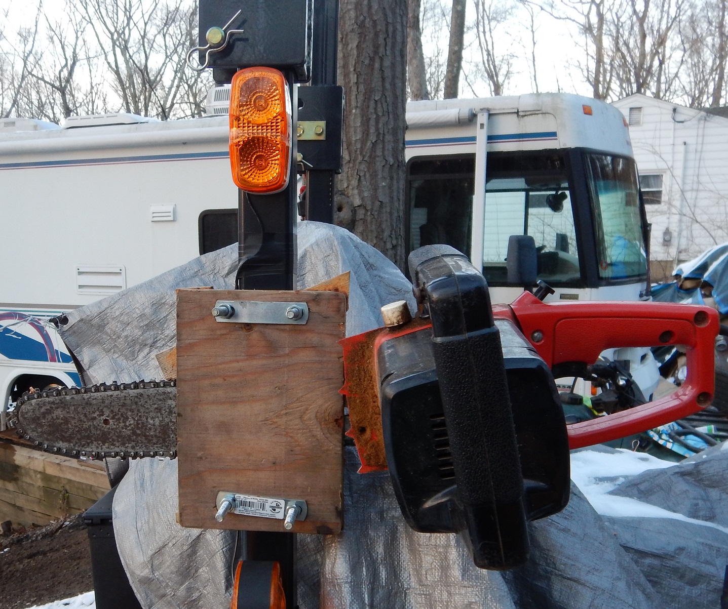

DSCN1437.JPG Tool box
DSCN1438.JPG Chain saw holder. I'm gonna paint it black. The electric saw is in there just for demonstration.
I got 3 led lights to mount to the ROPS; just making the mounts.
/ 2510 50hr. Service #39
I took off the bracket that hold the upper-link clip and the slow vehicle sign and used that bracket
