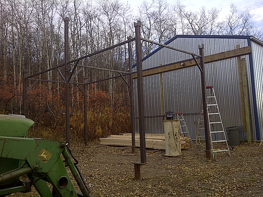

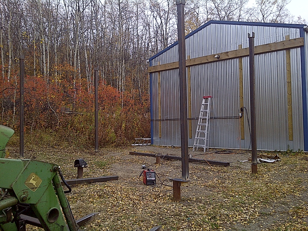

We like I dont already have enough projects on the go I gotta finish this one before the snow flies. I will add more pics as I progress.

Nice, I like the steel posts. Im going to start a build shortly with steel. Im not building anything out of wood in termite country.
/ 24x24 addition to existing shop
I had the steel screw piles in for a different building that didn't wind up happening so thought I would stick with steel for the frame anyway. Everything after this will be of wood construction.

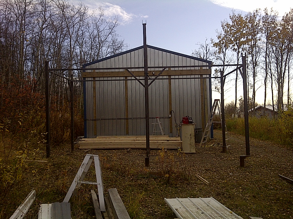

What is the purpose of the offset at the base of the posts?
When the screw piles were originally placed they were lined up in one direction but the other direction was less critical. When the use was changed one pile was out of line by seven inches so i added to the cap and gussetted it.

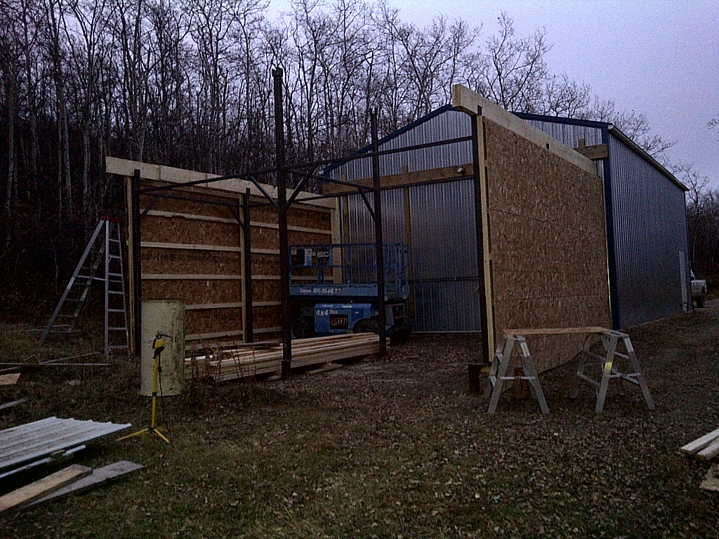

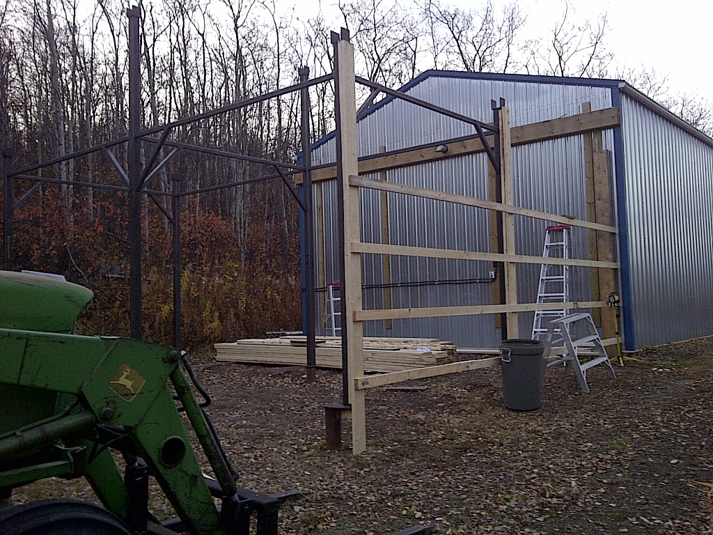

here is last nights work, by tonight that side wall should be sheeted and tomoorow I will start on the other wall.

Well got a bunch done over the weekend but not as much as I hoped. My BIL dropped off his scizzorlift for a fwe days so hopefully I can get the heavy tall stuff done before I lose it.
Here is a pic of progress
