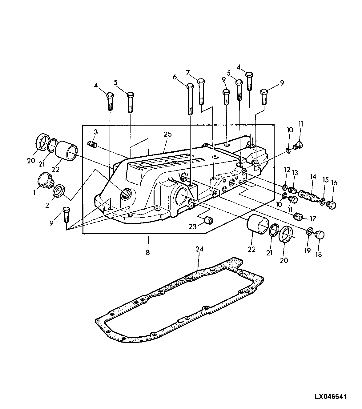

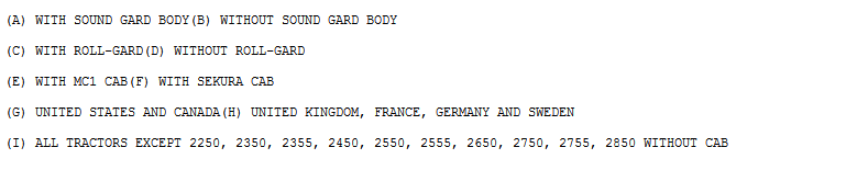

/ 245 loader qustions #6
I will suggest to attach return hose to plug hole in RH center of rockshaft housing where plug #17 is located. Length of mounting bolts varies with how tractor was optioned as shown in footnotes below.

/ 245 loader qustions #8
pipe plug(parts key 17) is 1'' NPT. Fitting(parts key 5) in jd110's photo has an option of being 15H629 Pipe Bushing 1/4" 1/4" X 1" HTH's,Jim

/ 245 loader qustions #12
The plug I was referring to is #2 in this diagram. The one TxJim mentioned will work as well, but it may be more difficult to access with cab. Plug #2 is also the plug to remove to access the parking brake adjustment. If you choose that one, you might want to adjust the park brake while the plug is out. Use a large straight screwdriver to reach adjusting screw. pull the brake lever back to second click before adjusting, then tighten adjusting screw until it stops. L114815________UN01JAN94.gif

/ 245 loader qustions #14
I forgot Harry's tractor had a cab. I totally agree the plug I listed would be near impossible to access with cab in the way.
