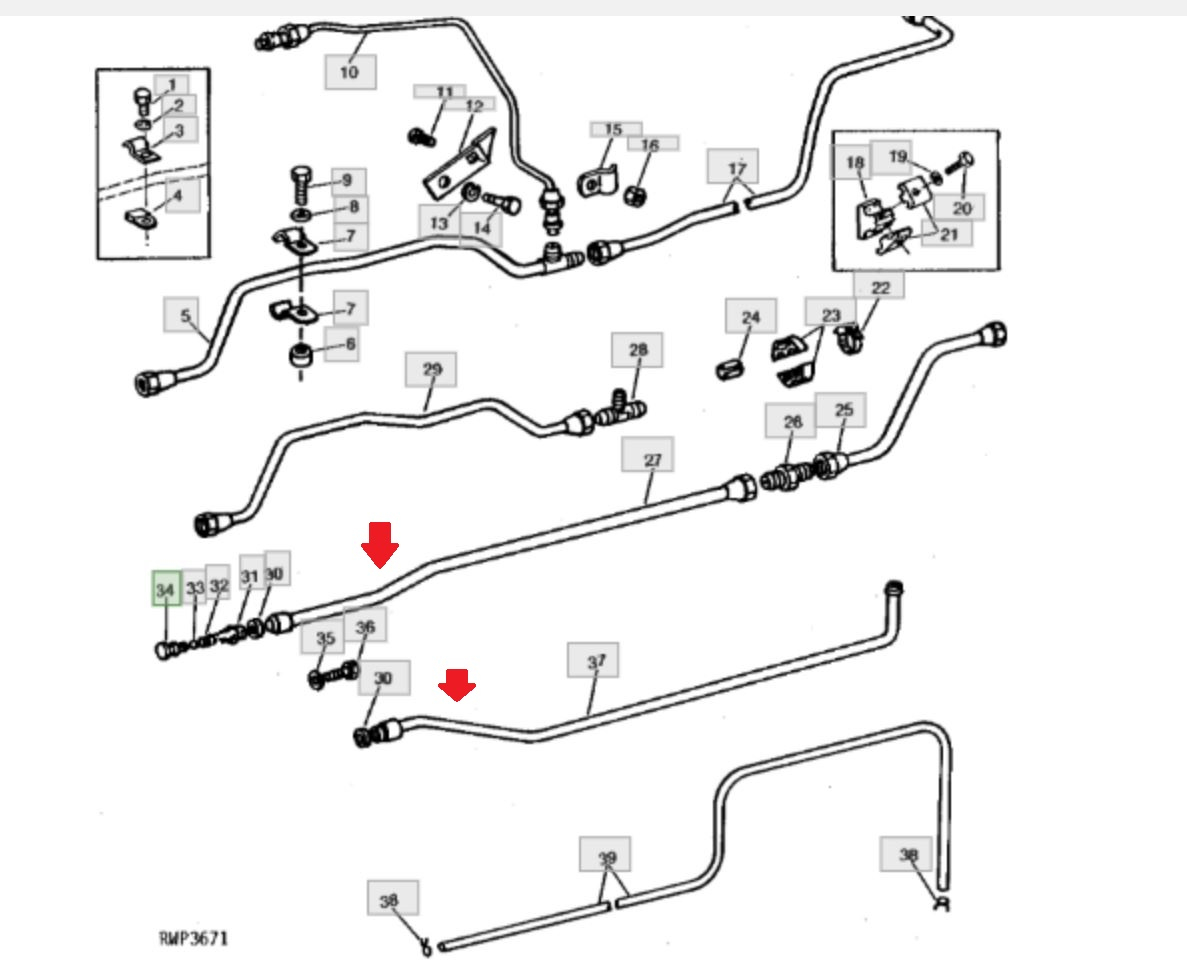

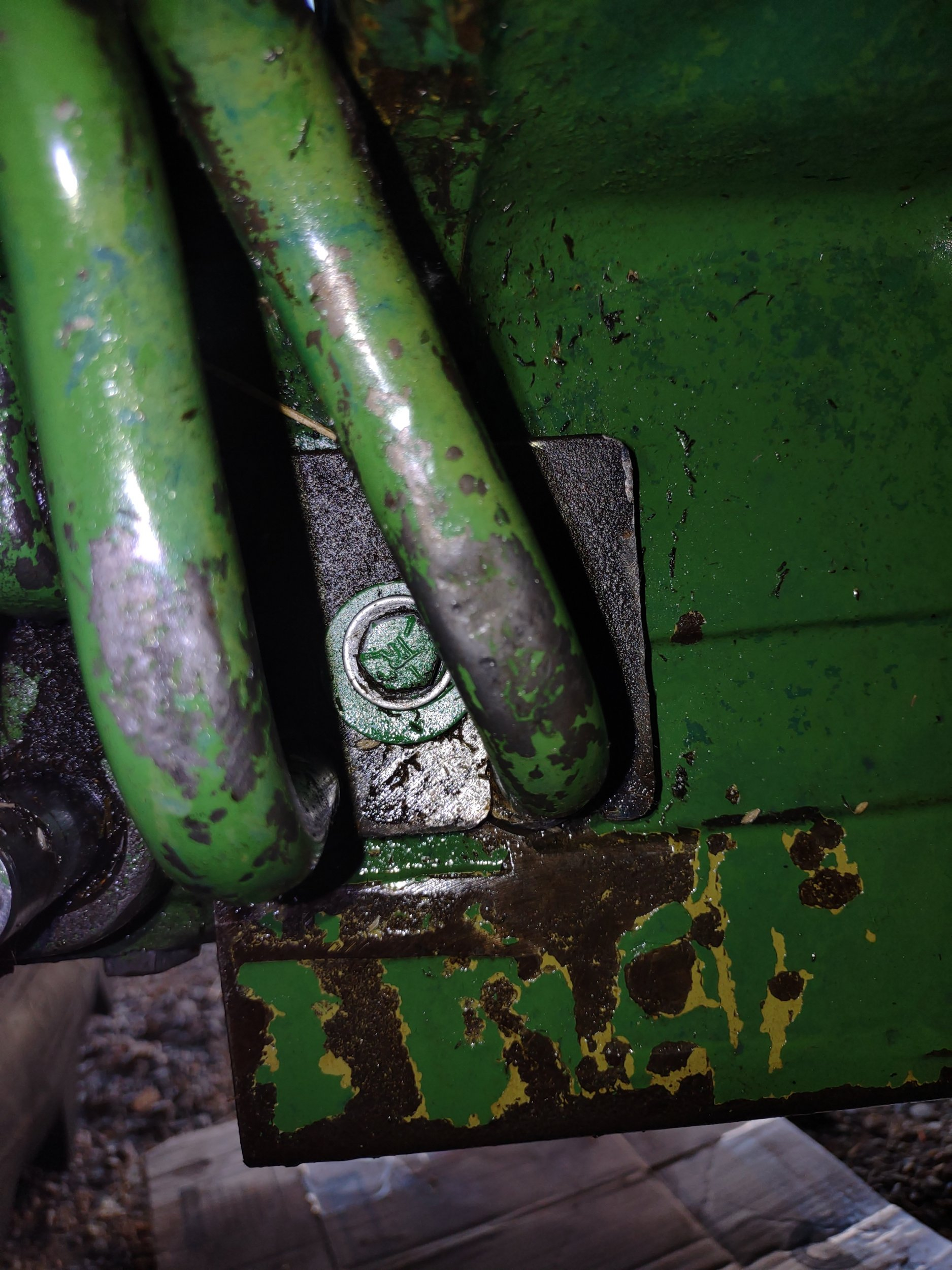

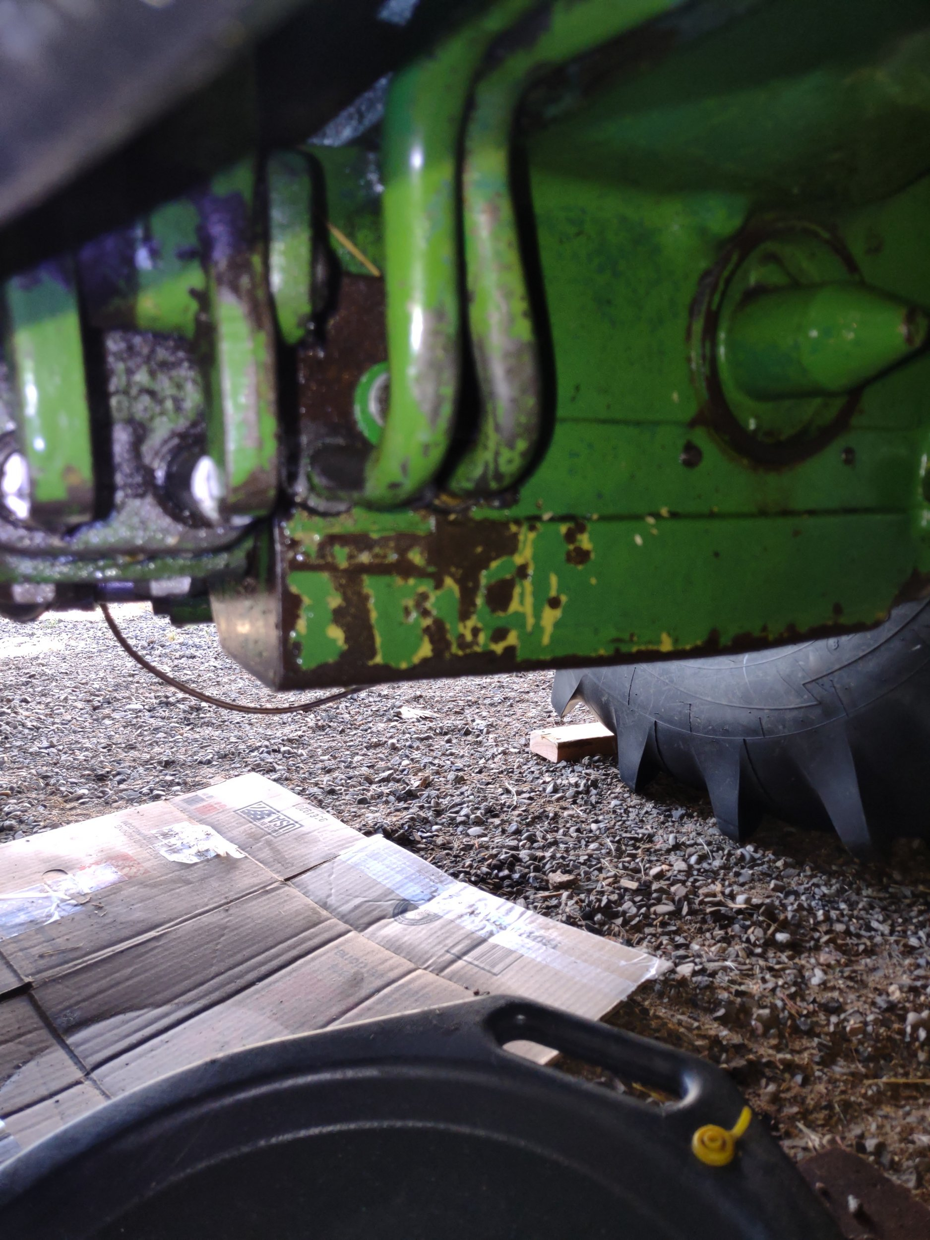

So I have a leak where two pipes go in the transmission housing on the right side next to brake valve.
Are these the pressure lines?
If I remove them from the way it looks all the Hyd will come out of the transmission, is this correct? :(
I was looking at manual and parts on JD website, having trouble trying to figure out what is needed to fix the leak, and I dont see anything about that bolt in between the pipes. I assume the two pipes in question are the ones with red arrows.
Thanks in advance

That bolt and plate clamps those two pipes to their seats. An o-ring and a quadseal seals the oil from leaking.

Thank you for that info, just not looking forward to having to drain all that oil... UGH

On my JD 2030, it uses a "washer" that looks like rubber washer, square edges, not an O-ring or quad seal.
Mine are leaking too. Last split I forgot to buy new replacements and in a hurry reused the old ones. They are now starting to leak. LMK how the replacement goes on your tractor.
I am guessing the pressure line will not lose much oil when taken apart. The return is the one I think will drain the sump?
/ 2440 Pressure line leak #7
I did a clutch on a couple, dont think we drained all the fluid, some of them are tapered and dont even have a seal.

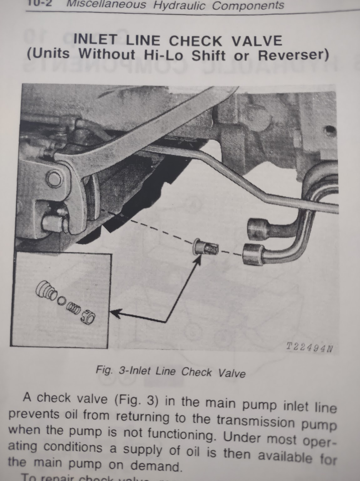

Hey folks, so I finally got a chance to work on this issue. I got everything back together but wanted to verify if the check valve / main pump inlet line is the outboard line / Right Side or inboard....The manual shows it as being outboard / right side, but the way my pipes are lining up it seems to fit better inboard... I dont know if the oil would have drained out as I drained it to just be safe.......
Thanks Again!
/ 2440 Pressure line leak #9
2440 parts catalog shows check valve location inboard of line retainer capscrew

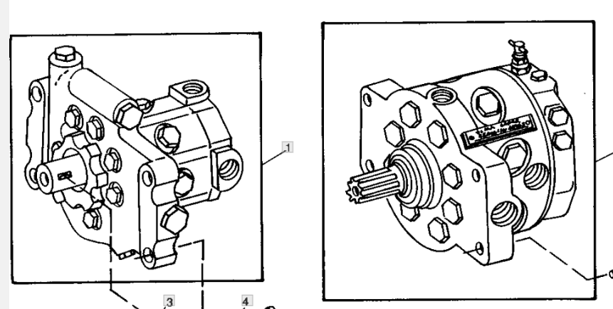

Is your tractor serial # below or above 341,000?
/ 2440 Pressure line leak #13
Which hyd pump does your tractor have? Pump on left is 1.38 in.3 & pump on the right is a 2.4 in.3
#14
Pump on right and now I understand.. LOL.....all the other numbers in the listing are related to pump! You da man Jim! If ever you are up MT way I owe ya a few beers!
