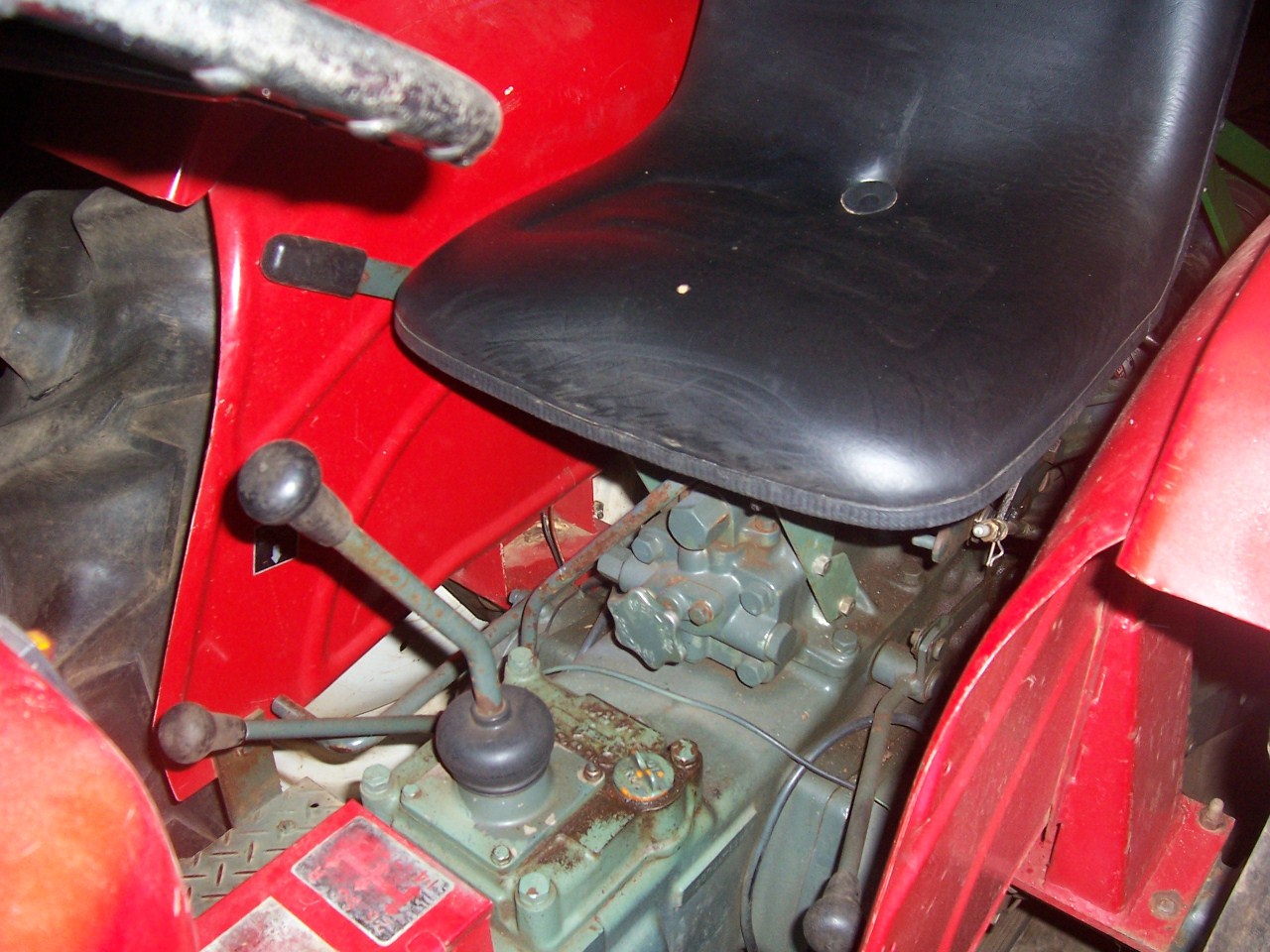

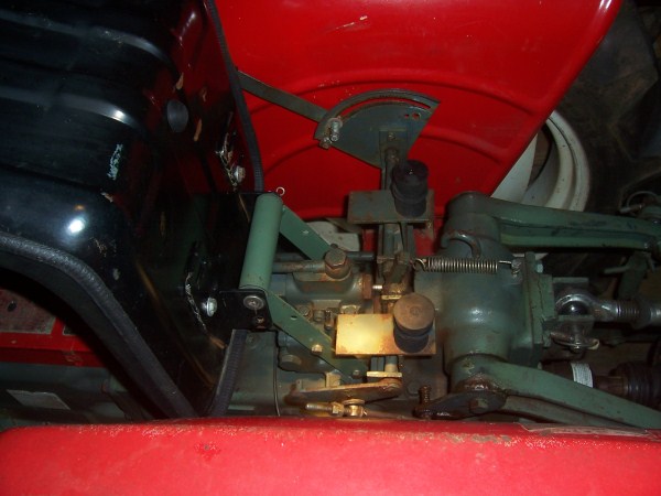

The Service Stop Valve is the Round/Flat Knob between your legs if your sitting in the seat. To prevent it from closing I open it all the way. And if I'm Serv. a Imp. I make sure it's closed all the way. No in between. The 2nd. pic. is the Drop rate and I'm wundering if that is the Adj. you were moving? I would have already pulled the pump and checked the Key Way. My bet that's it also!

Well, I don't think the hydraulic pump is the problem. Got it off the tractor and onto the bench for a closer look. The pump internals look good - the gears mesh well and there is no slop in the shafts. The coupler is in good shape and it came off the pump shaft without any problems. The key and the keyway were intact with no signs of slipping or scoring. Any other suggestions or ideas? Carey - I only fiddled with the round knob at the front of the seat and did not touch the the little lever at the rear of the seat.
Also, any tips on removing/installing the pump? I had to remove the front cover plate on the pump so that there would be enough room to get the pump off the engine. It would be a lot easier to install the pump with it all together. However, with the cover plate on, the pump bumps the vertical frame piece holding the radiator and there appears to not be enough room to get the pump on or off unless the cover plate is off.

I would take the pump and have it tested while it's out. Very unusual for it to go bad but It's possible. I'm thinking Loader Valve but that will be next when you rule out the Hyd.pump. When you Install it back remove the Battery the 2 bolts, Both sides just under the side cover. May have to remove you Radiator hose and that should give you all the room you'll need.

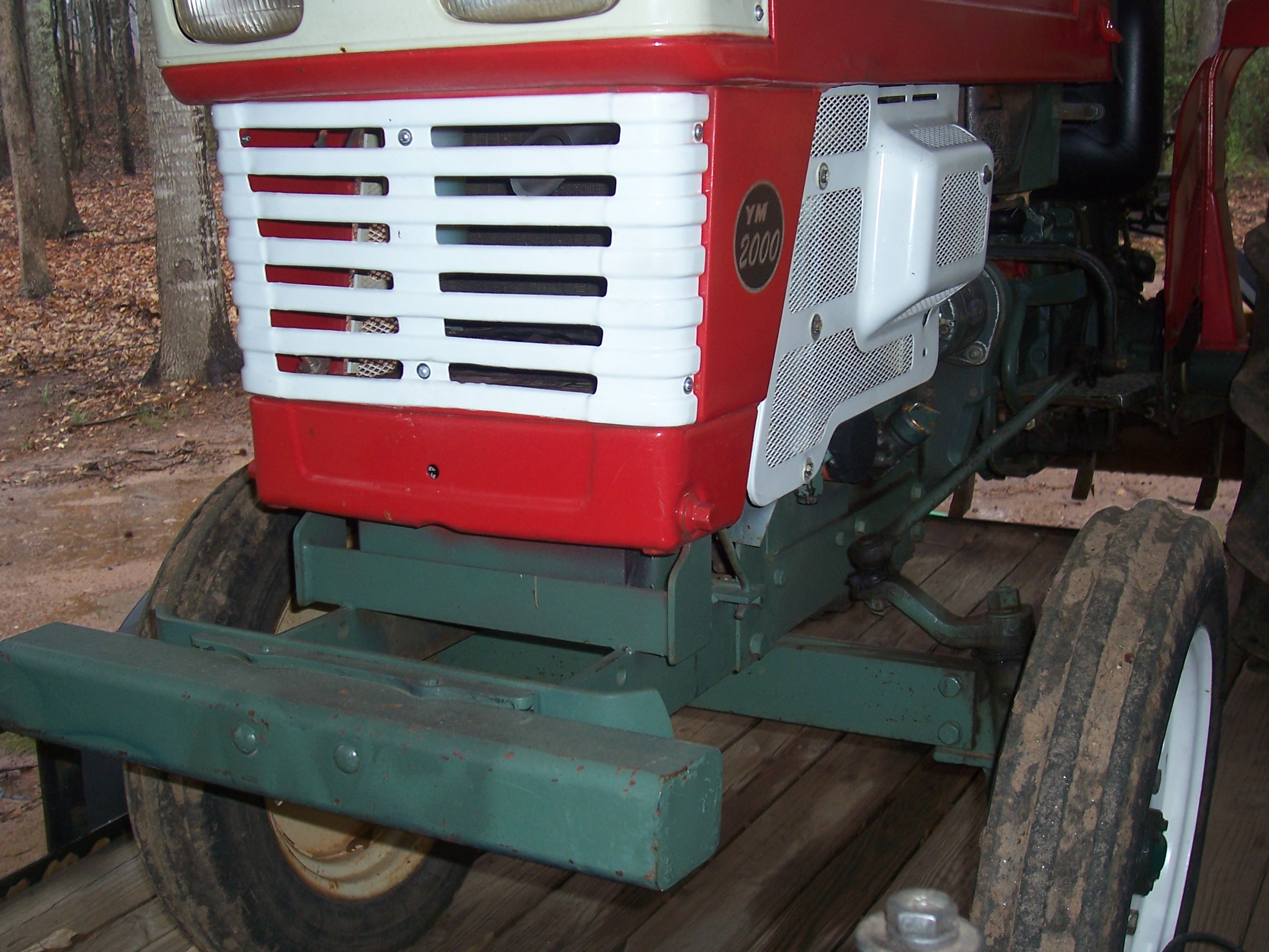

The only one that would come to mind that would be easy to damage and not loader related. And esp. working on it in the area on a 2000/240. Or possible Bad O-Rings here. Yanmar Tractor Parts: Hydraulic
