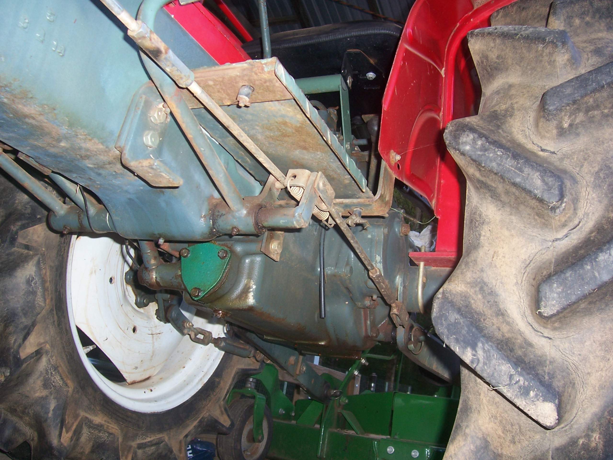

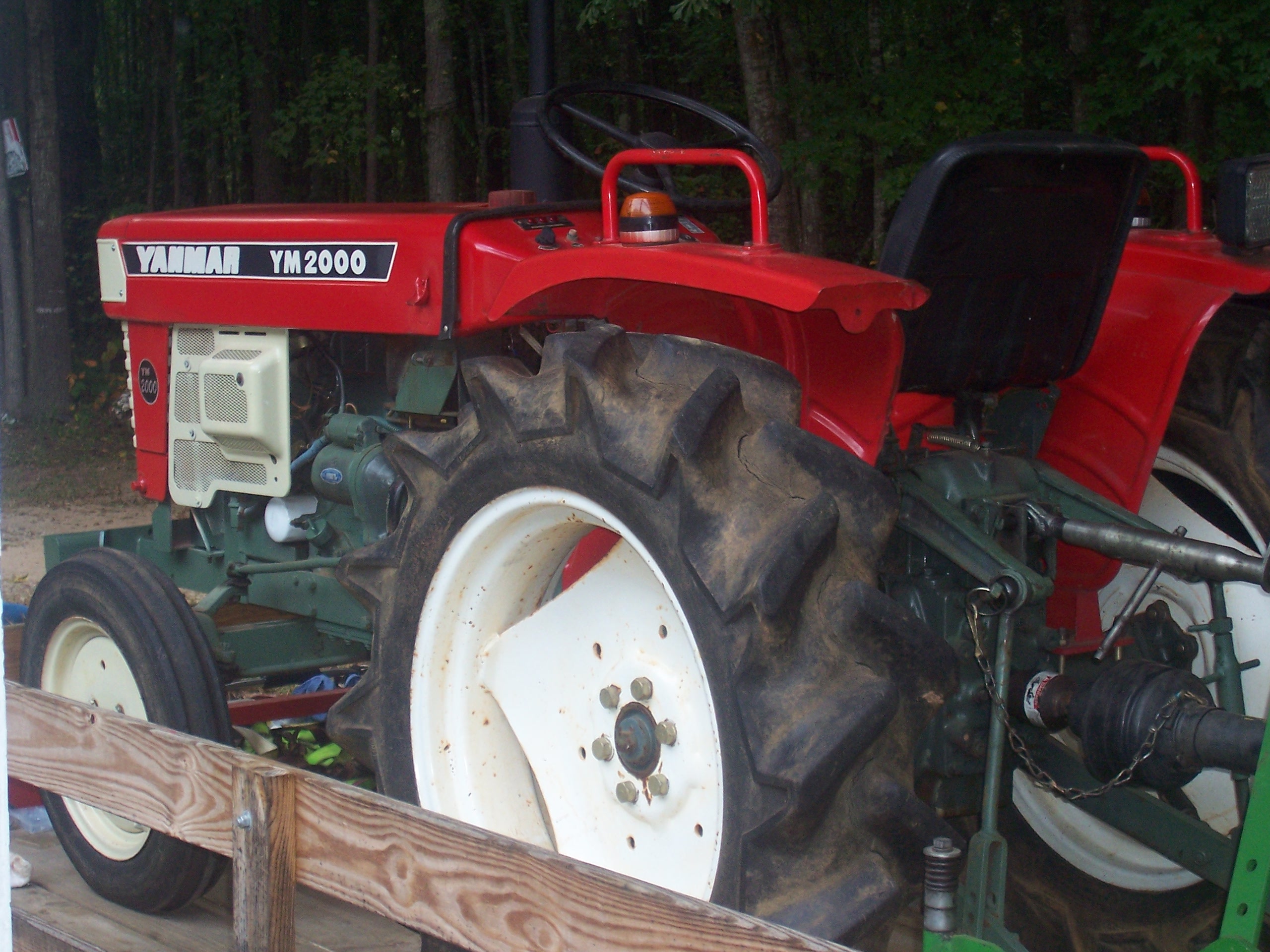

/ 240 Tires #9
Clemsonfor is right. These aren't Turfs but the tires have been on my YM2000 for Yrs. with tubes in them. There are some pretty deep cracks. IMO typical VN. When I bought it I figured I would also be replaceing them. To the day I have not had to add any air to them yet. You can also cut and add a old Tube as a buffer to give you more protection at the cracks if need be.
Carey
