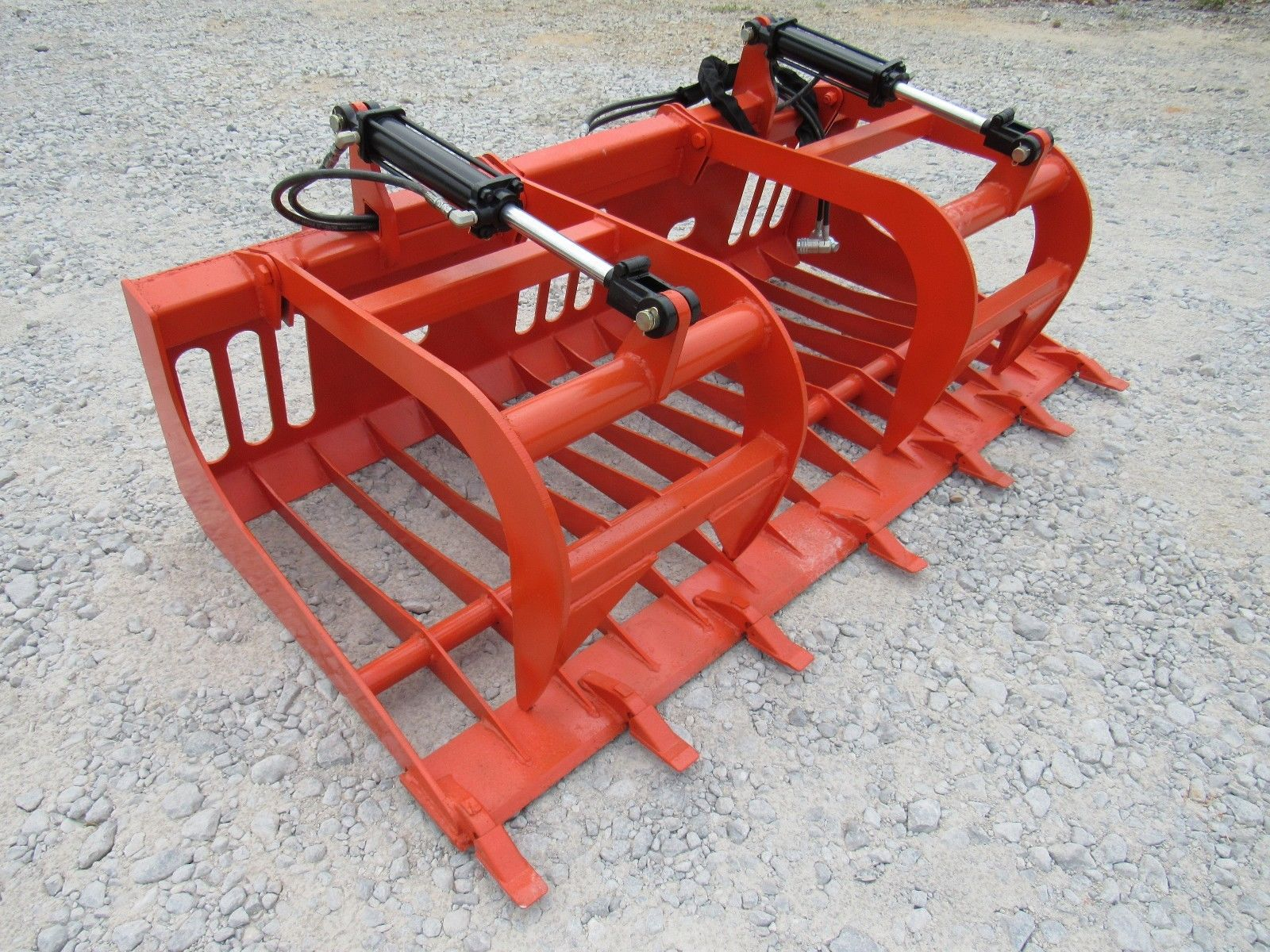

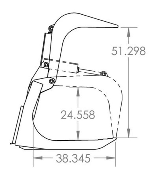

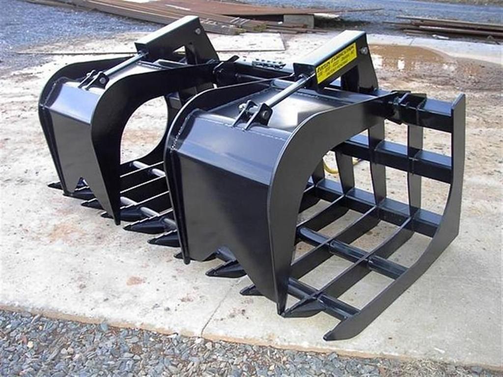

You probably have a clamshell style grapple:
I have owned both styles and for brush, trees and rocks, I recommend the dual lid, L bottom style, this one is called a rock bucket:
Mine is bigger but same style:
I have several different sizes of pallet forks and use the grapple more often.

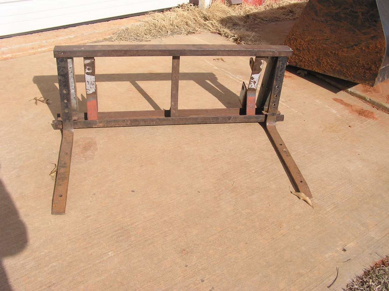

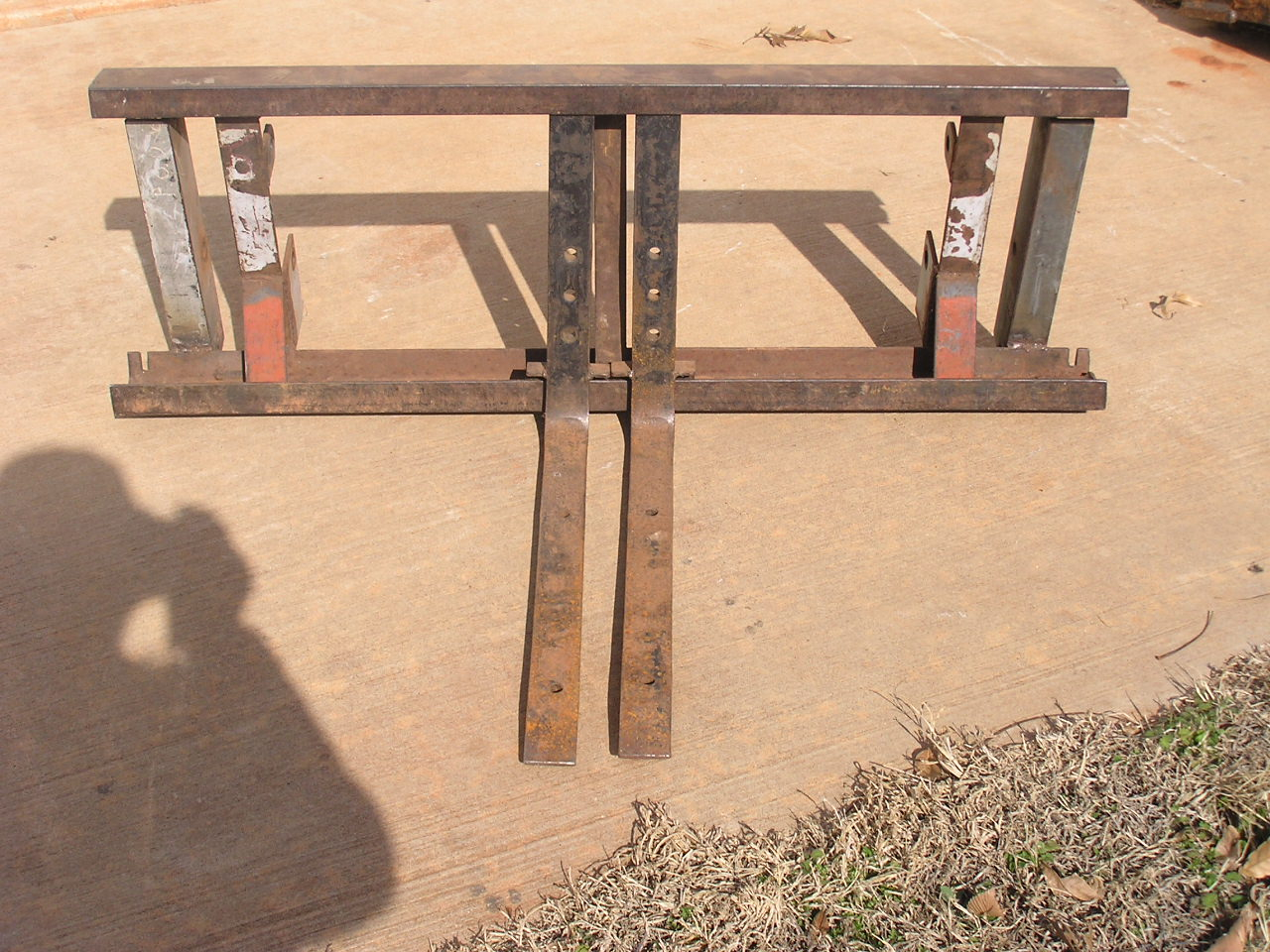

My 24 inch forks:
View attachment 753305View attachment 753306
View attachment 753310View attachment 753311
My 24 inch forks:
View attachment 753312View attachment 753313
You are correct, I do have a root grapple. It's good for brush piles which I don't burn anymore because I chip the brush now. The forks can bunch up piles with out crunching it together which makes it easier to pick apart for chipping.
