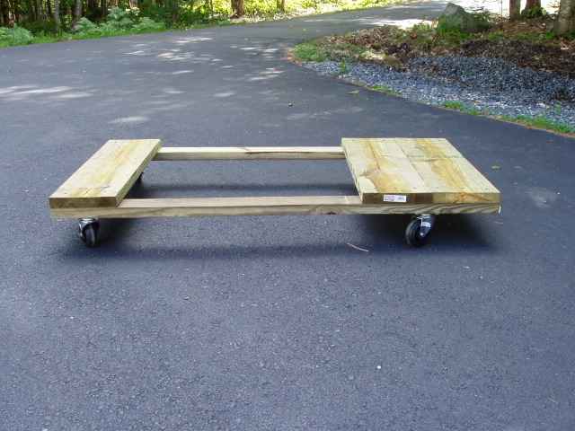

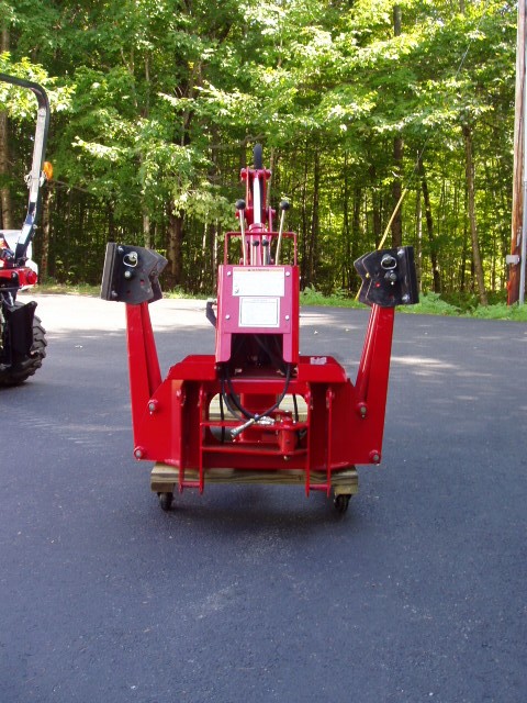

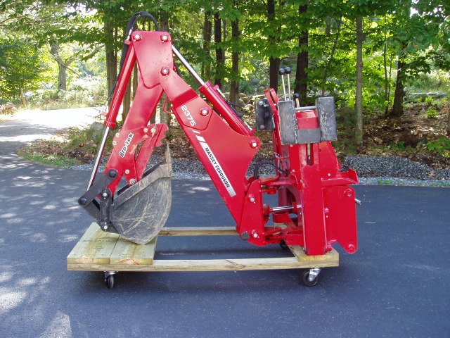

I *finally* got the casters from Harbor Freight (they must have been on that slow boat from China that my parents used to talk about) and put the dolley (dolly?) together. I made it a little bit longer than it has to be for the backhoe to accommodate the snow blower, too.
My plan is when it's time to change seasonal implements, I'll put the backhoe on the dolley - then when it's backhoe time again, I'll use the dolley for the snow blower. This way I can push them off to a corner of the garage and keep them under cover.
I know it would go easier if I had 2 dolleys, but space is already tight and my goal is not to amass a collection of these things.
I used pressure treated 2x10 for the ends, and PT 2x4s for the sides. The casters are 5", but it probably would go on an off a bit easier if I used smaller wheels since that makes it a bit easier for the BH to angle off the brackets.
Considering my investment is about $25, I'm satisfied this will do the job nicely.
Jay

What a weekend! Built a dolly for the bachoe just like in this thread 1 Hour, Took off backhoe (first time) 10 Minutes, Took off loader (5 minutes) and Installed snowblower (30 minutes) Then I pushed Backhoe and loader into the garage, greased all three liberally:rolleyes: Gee I love my tractor!

I used a bungy cord to keep the stablizer arms from settling, and locked the boom with the metal plate/pin, but I did not have the bucket swiveled all the way to the front when I took it off - and that has settled a bit.
It doesn't present a problem, just one of those things that I tell myself this year I should remember fore the next time.
But I won't. :rolleyes:
