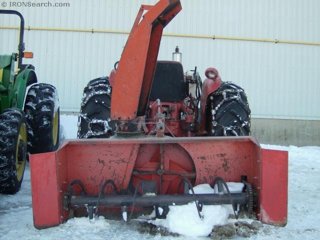

Not sure anybody sells them, but several folks here have talked about 'wings' that would extend the side of the blower a few inches and funnel the snow into the main blower.
Your other solution would be a 2305 with the blower.. ;O) Works great and the tires just about match the blower width.
   / 2320 Snowblower Question #13
Orlo: Here is a picture of a snowblower with wings on it. I doubt that anyone sells them, I believe you have to make them yourself. Garry snowblower with wings.jpg
   / 2320 Snowblower Question #14
They look simple enough to make. I wonder what thickness of steel would work well? I have a 12 ton shop press but I'm not sure I could make a clean bend in that length, might need a bending brake.
I may make some this winter as I'm getting 6" wheel extensions on my 3720. That'll bring it out to 72" in the narrow wheel position. The blower is only 59" wide. I was going to swap the extensions out for the winter but if I put wings on I can leave them on. Probably a lot easier making wings than having to remove large loaded R3's ;O)

Mike, I happened to measure a 2320 today with R-4's with the valve stems on the outside. It measured just about 48" perhaps a hair under. Given that width, I don't see the 47" blower being the problem that I, for one, thought it would be....
