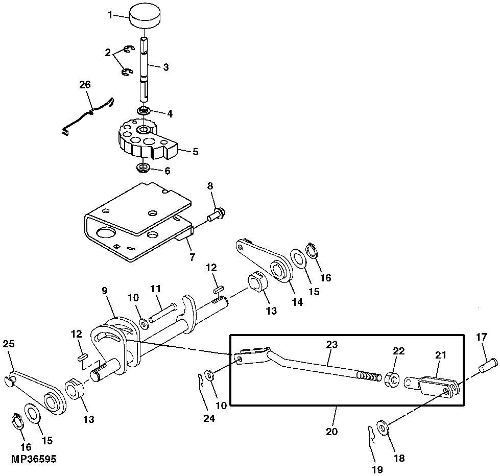

question for any 2320 owners out there.... I have the independent lift option on my tractor. Whenever I try to set the mower deck height using the deck knob, I find that on one setting the deck is either too high and If I change it to another setting it is too low. What gives with this setup? Am i doing something wrong or is this just the nature of the beast. One of my buddies has a brand new 2320 tractor and it is doing the same thing. What can we do to remedy this problem. I should be able to have finer adjustments than this. Has anybody figured out how to fix this problem?:(

need to take cam off add 1/2 the drop on the stops exept for the top lock and the instal setting .i would take cam off weld or bolt appox 1/4 inch to each drop so it dosnt go down as far on each setting.
/ 2320 mower height selection knob
/ 2320 mower height selection knob #8
The assembly is not hard to remove, but it is a pain in the butt! The knob on mine disconnected from the it's shaft, so I had to put it all back together last year. The cam block (#5 in the pic above) is what determines the cutting height as it physically stops the lift arms from dropping further down (the far right side is the raised lock position). This is why you need the deck raised to adjust the knob. As you can see in the pic, adding some material to a couple of the tabs will give you smaller increments to adjust with.
Now getting to the cam block means you have to remove the bracket (#7), and the 4 bolts that hold it in. I had trouble getting to them through the right lift arm. Maybe I didn't have the correct tools, or didn't raise the machine up high enough to have sufficient room to work in, but it wasn't fun. You'll also have to dis/reconnect the arm (#23) that connects to the rockshaft arm. Or maybe not - I don't know how the indy lift works...
Good luck and enjoy!!

From what I found in other posts - the knob is suppose to go all the way around without hitting the part #5 (which makes having the decal properly installed sorta important)..
The 'ear' (between part #'s 11 & 12 in the diagram) is what contacts the #5 cam.. In my case the ear needs about 1/2" more room to get to the largest part of the cam.. When properly adjusted, and the knob in the LOCK position, the ear will hit the largest part of the cam and hold up the MMM with very little drop. currently mine hits the cam at the first step down so the deck drops several inches when locked up.
Someone adjusted the part #23 so the ear and cam were adjusted properly.. I do not know what the difference between adjusting the upstop limiter VS the #23 is different though..
I did measure the drop on the mmm lift arms at various knob settings and they are in 1/2" increments it seems..
Does anyone know if you can buy a new decal - easier solution than moving the cam it seems? Or can you remove/adjust/replace just the knob handle?

Unfortunately, the largest lobe (which is used for the "locked up" position) that the deck height knob controls allows the mower to drop 1.0 - 1.5 inches or so from its highest position. So, we definitely lose that ground clearance. JD obviously couldn't have made it so no height was lost or we'd never be able to rotate the deck knob to the locked position; they had to allow some clearance. But limiting it to a half inch drop or so would have been nice.
I'm not sure what part number 23 does. It's not part of the mechanical lift kit or independent lift kit parts list that I have in the installation manual.
I suspect you can buy another decal for the deck height knob. Your biggest challenge might be getting its part number. Also, don't be surprised if the price is more than you think it should be for something as simple as a decal.
My setting for a 3" high cut is to rotate the knob two-clicks counter-clockwise from the locked position. I like that height of cut because a fresh owing looks good, it's not too high, and it's high enough to protect the root system when the weather is very hot.
It might help your understanding to crawl under your tractor when you have the mower off and look up at the cam -- that helped me. Of course, the tractor should be on level ground, turned off, and the parking brake set (as a businessman, limiting liability is important :)
I hope this helps.

My reply - I had my wife lower the 3pt while i was under the tractor to see how everything worked (tractor off, mmm off) currently my ear hits at the first step down from what should be the lock position and it appears to me that if i adjusted the 'ear' to hit the biggest cam part it would drop only slightly..
Quote:I'm not sure what part number 23 does. It's not part of the mechanical lift kit or independent lift kit parts list that I have in the installation manual.
My reply - part #23 on my tractor is what connects the MMM lift mechanism to the 3pt hitch and cause the MMM to raise/lower.. if you look at post #8 here you can see the a pic showing how #23 ties into the 3pt. http://www.tractorbynet.com/forums/john-deere-owning-operating/168020-2320.html
here is direct link to the pic - #23 is in the lower left hand corner, the goldish looking part

Since its only 80 degrees today and somewhat lower humidity - I got off work a few hours early to play with getting the height knob adjusted correctly
I was able to adjust (shortened) the part #21 (turnbuckle) on #23 about 2 or 3 turns BUT the ear is still about 1/8" from being able to clear the cam at the biggest part -but there wasnt anymore 'slack' to tighten it anymore..
So now I am going to have to adjust the upstop limiter if I want this to work correctly..
Im going to post a question in the forum on advice to adjust the upstop limiter..
Brian
/ 2320 mower height selection knob #19
i have the ind lift on my 2320 all the lobs should have been 1/4 inch higher except the top one, so you can get more adjustment i mow on the second one from the top lock possition the rest are to low, it a poor dezine.and it drops to quick im always lifting it.
/ 2320 mower height selection knob #20
Found out a little more information on another board..
On the MMM there is a big (4"x6") square piece of metal plate at the front edge of the mower (inline with the gear box)- This plate is what keeps the MMM from raising up too high and hitting the under carriage of the tractor.. Based on the operators manual - this plate should be about 2 to 3mm away from the tractor..
SO, I reckon this is how you tell when the upstop limiter is correctly adjusted.. I probably have 1/2" to 3/4" of space between the plate and the undercarriage on my tractor..
