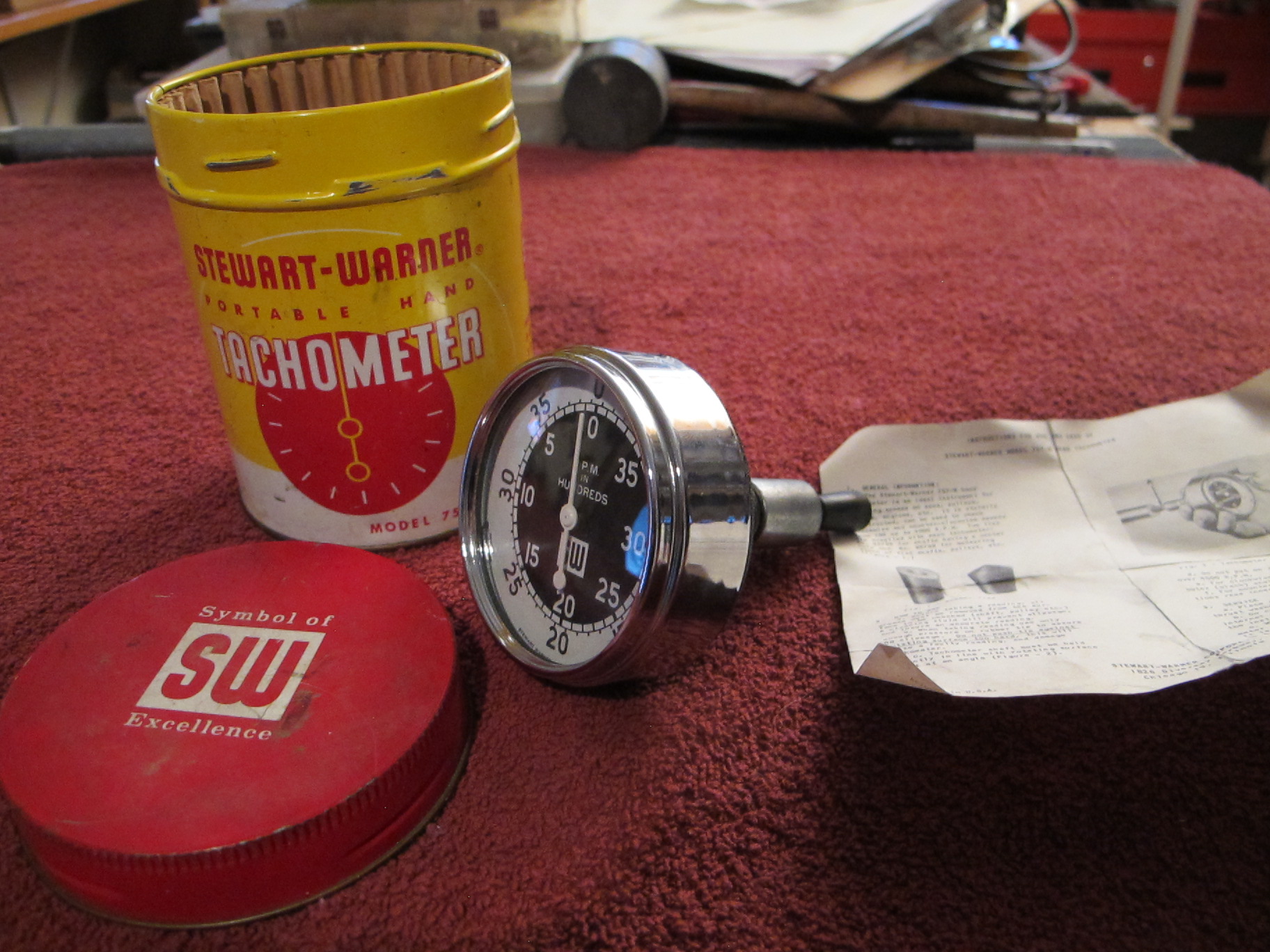

/ 2310D Tachometer Inaccurate #36
Heres a picture of another type of tachometer. I used this in my repair shop. It's a hand-held type that you hold against a rotating shaft. Range is 100 to 4000 rpm.
A beautiful thing about the size of an apple and quite heavy. It doesn't come apart easily so I'm reluctant to look inside. I wonder if it is a mechanical (chronometric type) or the simpler generator/voltmeter type? Based on the fact it doesn't read below 100 RPM and the linear scale I'm betting it is the generator/voltmeter type like most modern tachs. I'll ask Stewart-Warner if I can find them...
rScotty
