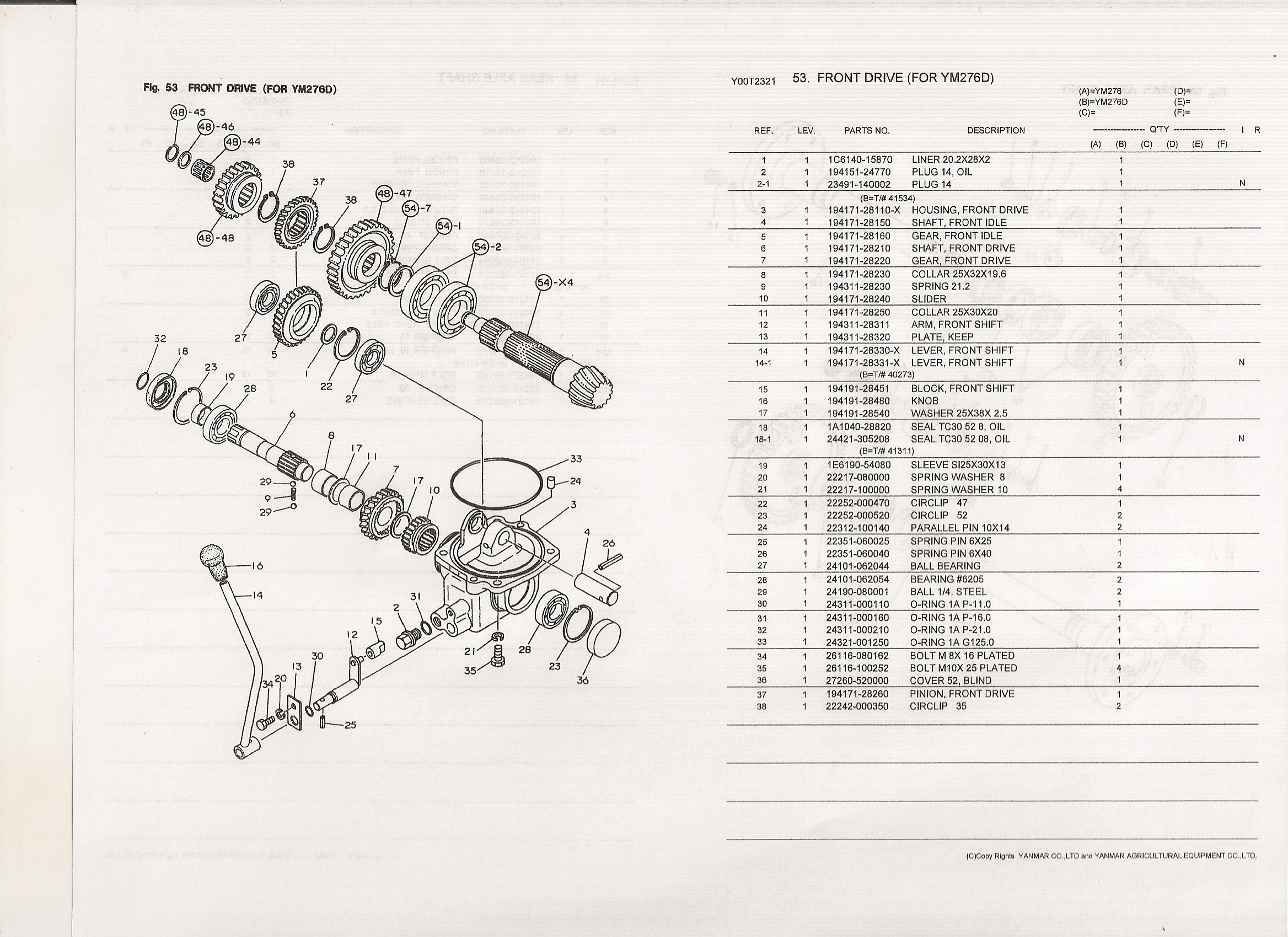

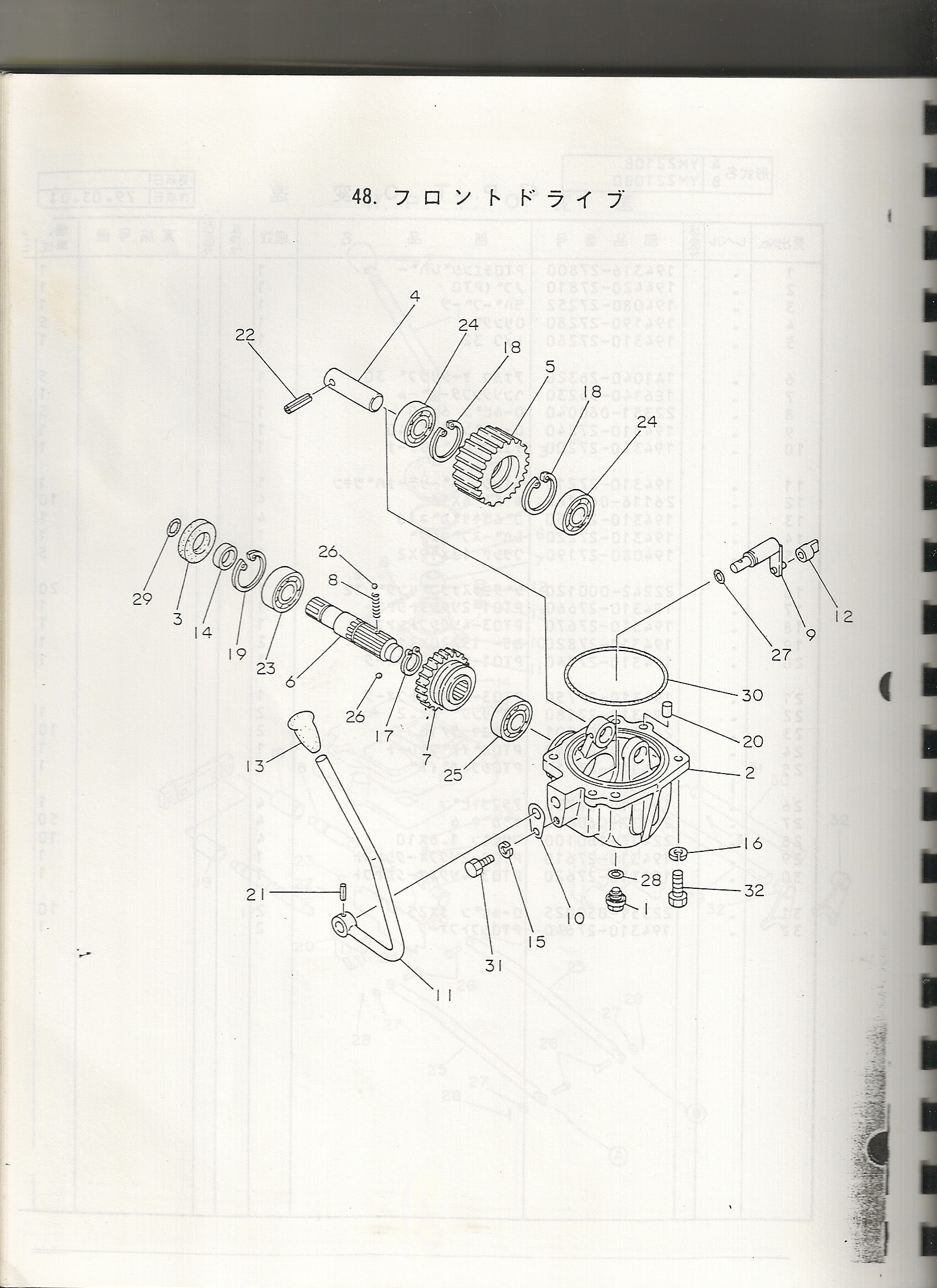

First scan out of the 2210 manual. Note the front shift arm #9 pointed down. Next scan out of the 276 manual. Note the front shift arm #12 pointed up. Is yours like either of these and are you confident your shift arm is pointed in the right direction?
I would say mine looks more like the first one as there is not an opening in the back, just the front side where the axle stub goes out and the top.
In that picture I now see what you were referring to in an earlier post about the gear being backwards, as mine has the "groove" toward the front for the sliding pin to go in. And I have never had this thing taken apart as you have to take out and replace the seal and collar in the front when you take either that gear or the lever out..that is why I stopped. When I put mine in 2wd and the gear goes forward, it clearly disengages the back gear and goes all the way to the snap ring "stop".
So I guess there are a whole bunch of things I don't know, but 2 main ones come into mind.
Is the groove side of that lower gear supposed to be to the front or the back of the tractor? Mine is to the front.
Should the lever be up? Or down? Mine is down.
But remember that mine did work for the first 4 years I had this tractor.

Your gears don't look exactly like the 276 or 2210. If the shifter works smooth in the sliding gear and all gears turn by hand as they should then I don't see how there can be a problem in that area. Are you satisfied the front shift block (#15 on the 276 drawing) is pretty much centered (up and down) in the sliding gear groove?
