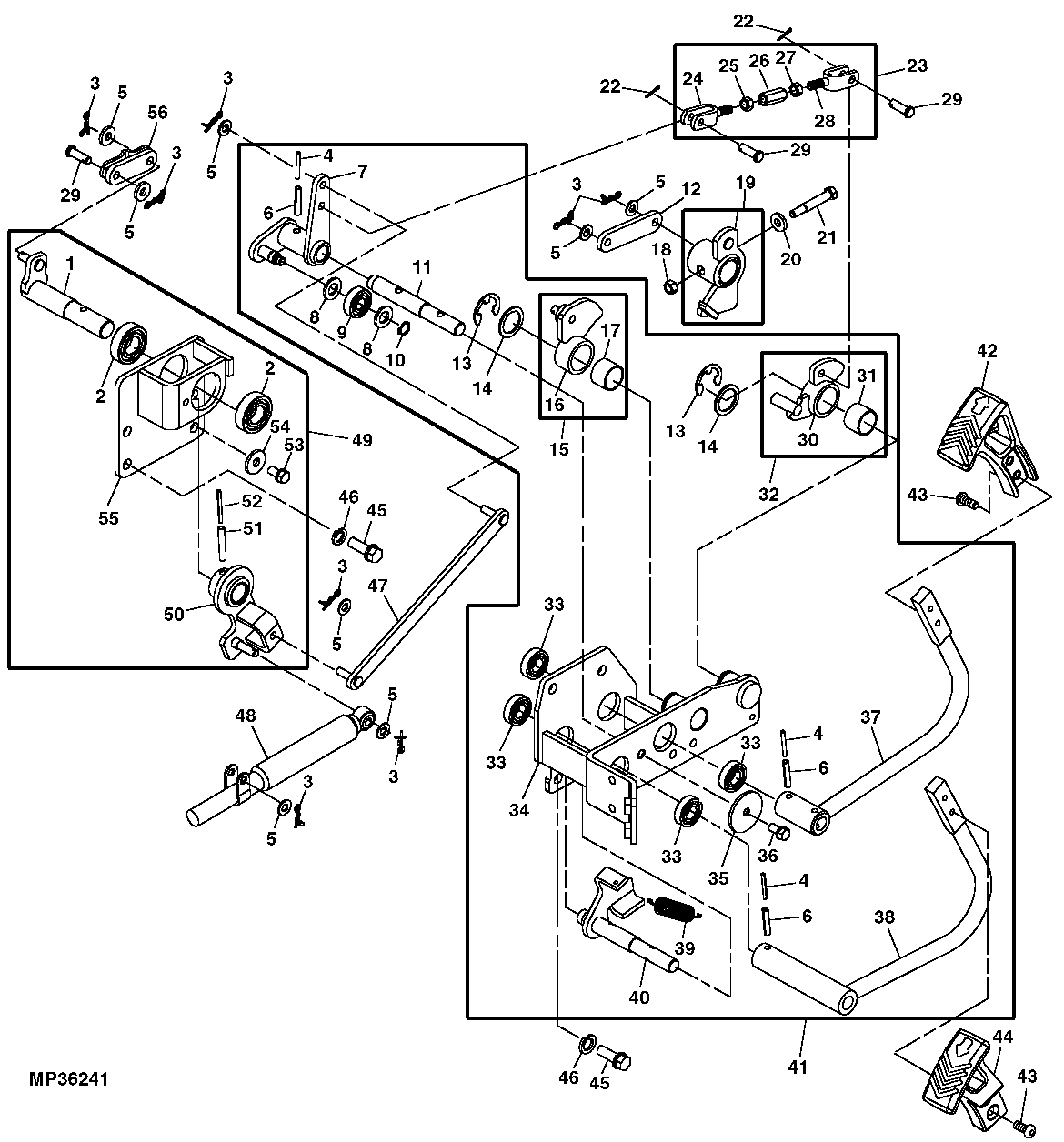

I was using the tractor and got off while running (put in neutral) and when I got back on it wouldn't move in reverse and just creeps fwd. Checked fluid, debris, broken line, linkage etc. Don't see anything. The loader, pwr steering, PTOs & 3 pt hitch all work. Pedals feel soft and don't come back to neutral position on their own? Trying to find a diagram of the linkage and pedal to make sure a pin didn't fall out or something simple like that before going to dealer. Owners manual lacks detail photos.
I'd appreciate any insights/help!
Thanks!

Will this help?

Thanks all! It was the linkage. The pin connecting hydro drive lever to the rod fell out. I actually found the pin and washer in the leaves where I was working. That was definitely a blessing!
Thanks again for the help!
Cool!
Can it be pointed out in the above drawing? Others may want to take a look see at theirs to make sure all is as it should be.
/ 2305 Trans issues
Yep! The parts are #29, #5 & #3. Somehow the spring clip pulled out??? Getting the pin back in was a bit of a challenge. Not much room for your hand.
