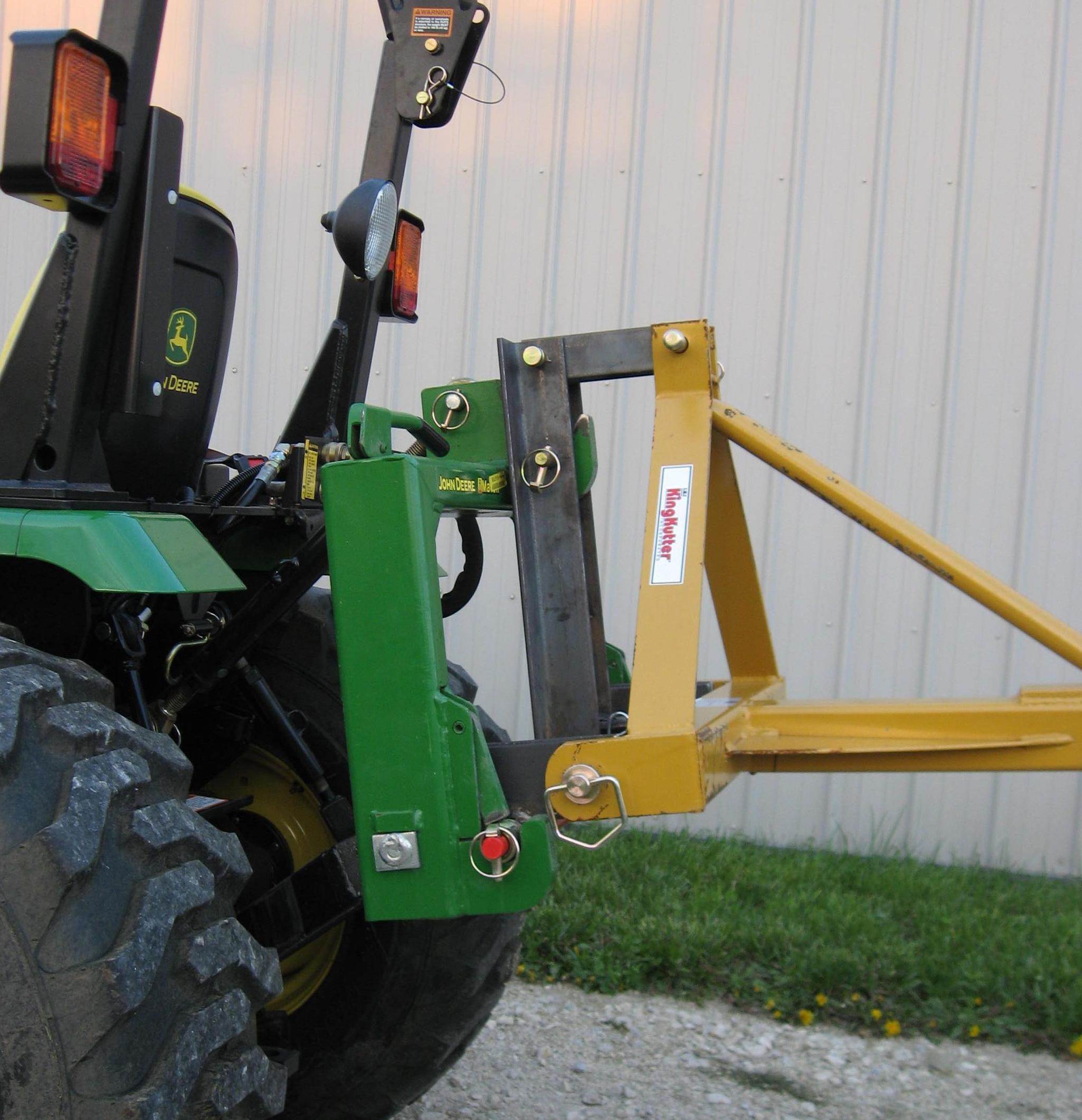

has anyone adapted a none imatch cutter (pin height) to the imatch? 4 foot cutter. pictures would be great.
/ 2305 rotary cutter #2

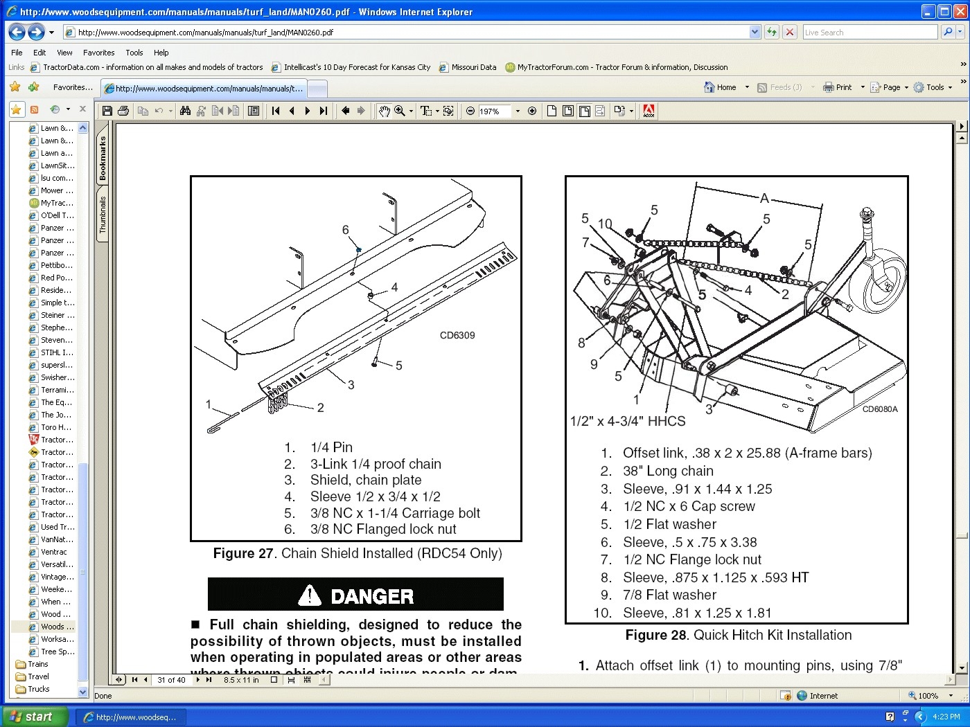

It's not a rotary cutter, but here's a diagram of the adapter they use for the Frontier rear finish mowers. Basically it's two brackets that go from the bottom pins up to the top pin to hold it down to the correct height.
Something like this could probably be fabricated pretty easy.
Also here's a pic of an adapter I made to deal with fit problems for a landscape rake.

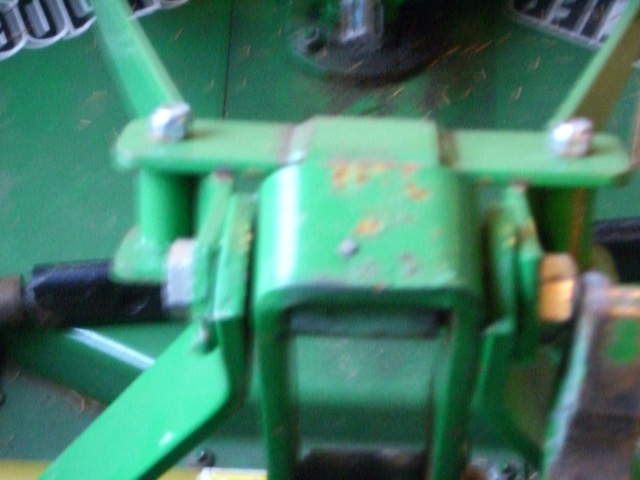

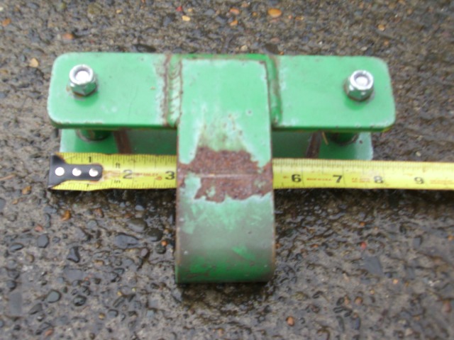

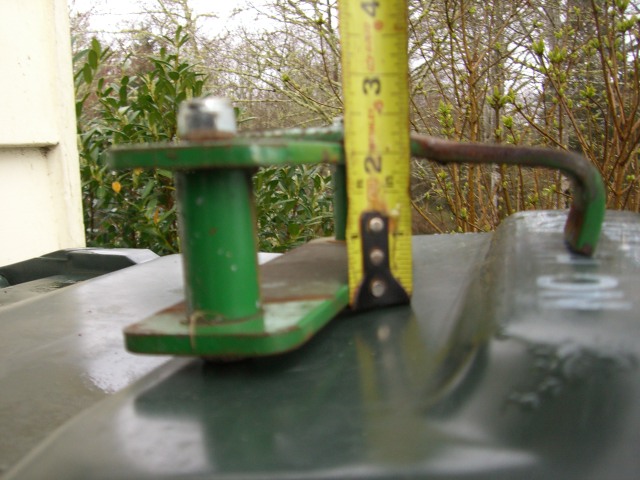

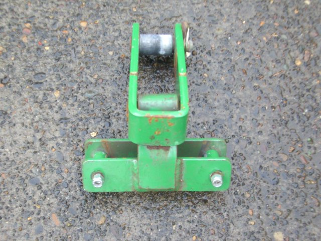

/ 2305 rotary cutter #4
Shown is a bracket that my dealer made to adapt my RFM to my I-match. I got another and added it to an old John Deere 4' brush hog. I added the u shaped collar and the bracket keeps it from extending. I have several other pictures that show the measurements better. I don't have anything of the brush hog with the bracket in place.
