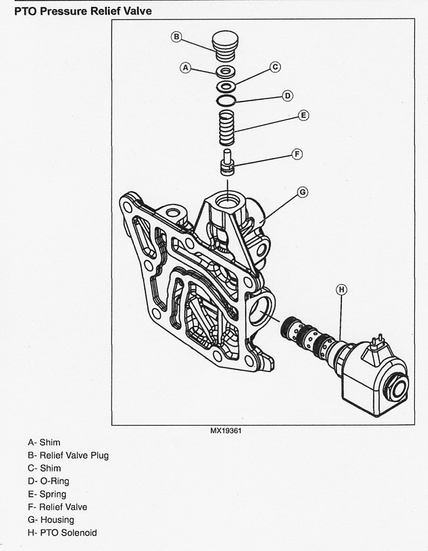

The switch is working, I am getting 12 volts all the way down to the solenoid at the bottom rear of the tranny.
/ 2305 PTO not engaging #3
Maybe the solenoid has failed or is sticking. Not to be insulting, but I assume you made sure the selector was set for the mid PTO.
Yes, tried all 3 positions. We actually took the magnet end of the solenoid off and it is working, so we are hoping that a new one will fix it.

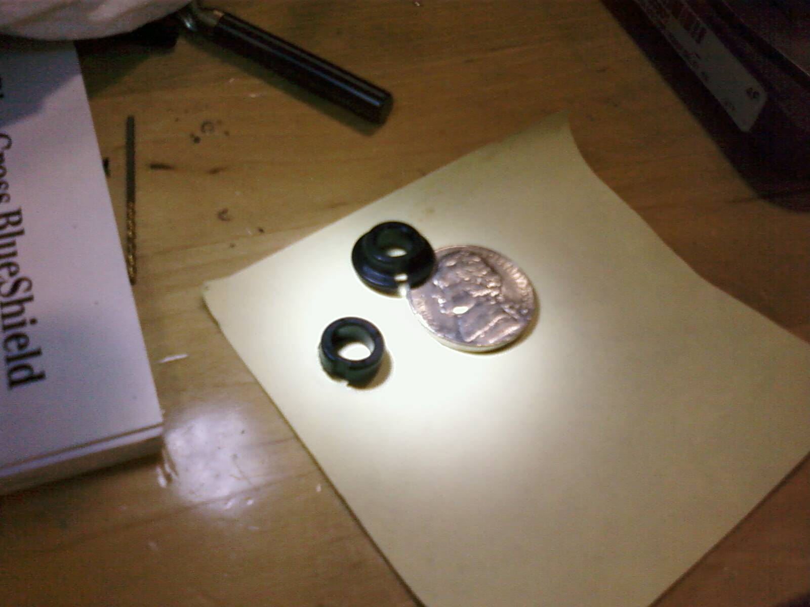

Ok it's fixed, but it wasn't easy as we had to make some small plastic parts to replace the ones that broke. These are internal on the solenoid valve. They basically encapsulate a spring to return the internal stem to its native position. Deere doesn't sell these parts except with the whole solenoid which is a Kanzaki (sp?). I guess if someone needed some, they could take the broken pieces to a shop and have them make them some. We used a high end plastic called PEEK which would be expensive to use but since we had some laying around, we used it. Plus, I guess I should have said that I work in a machine shop to start with. I guess if anyone needed some, I could maybe make them some for a small fee plus shipping.
Old broken piece and 1 good piece.

Can you tell me if it takes 2 of the little rings and are they the same? I can't find my files, but I found the 2 parts in the picture.
/ 2305 PTO not engaging #19
Glad to hear it.
Yes sir, it has two little black plastic matching rings to hold the spring in place.

So did your BIL find a decent used one?
When I get caught up at work, I will make some of them and have them available.
