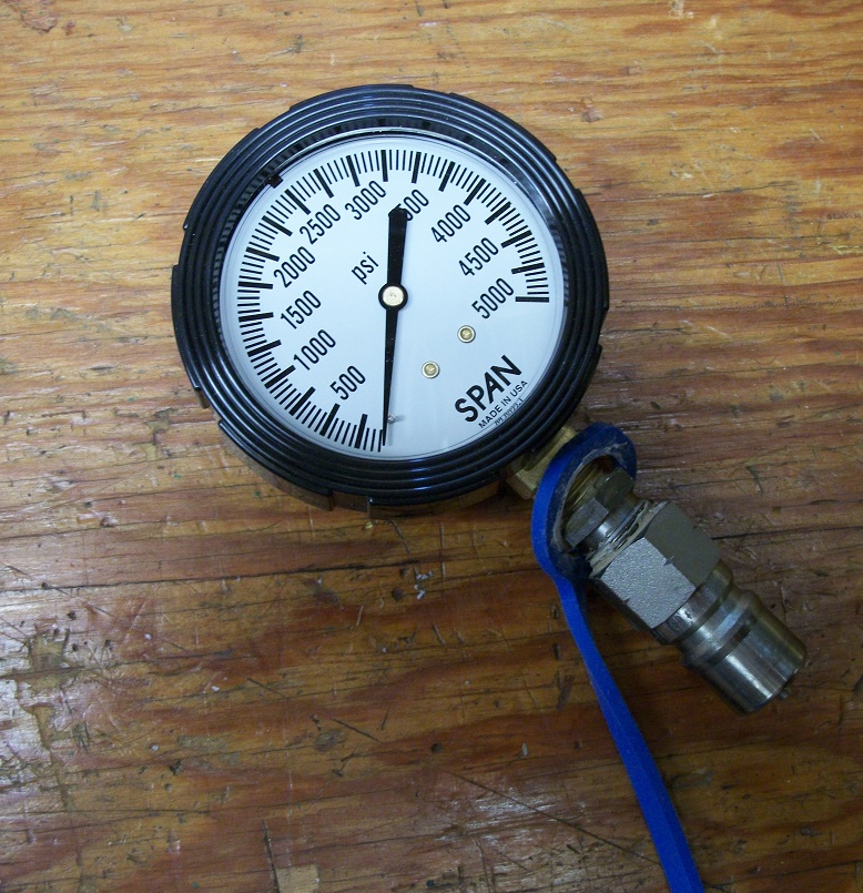

I just bought the parts and made up my gauge..

Thanks for all the replies. I have been off and on this as I have had other things. finally had some time. Took off the SVC and opened everything up and cleaned everything while I was waiting for the gauge to arrive. finally got the gauge and tested at the ports first valves from the pump. No measurable pressure. Tested it on the connecter as shown in the manual and nothing there. Also tested on the PTO ports and nothing there either. the manual says to get it up to operating temp but I am hesitant to do that with the huge whine coming out of the pump. It seems that there is not pressure coming from the pump. Hoses are fine.
One thing I did notice is that when I drained the oil to check the filters there was little to no oil in the spin on filter. also took out the pipe plug next to the filter base and nothing came out. Also, the drive no longer works.
Seems that all points to the pump but i don't see anything wrong with it when I took it apart.
Im pretty lost right now. I really can't take it anywhere since there is an implement on the three point, and the loader is on as well. can't lift the loader or the three point, so I don't know how to get it anywhere. I have a winch on my trailer so maybe if I can get the implement off the back I could drag it on the trailer.
