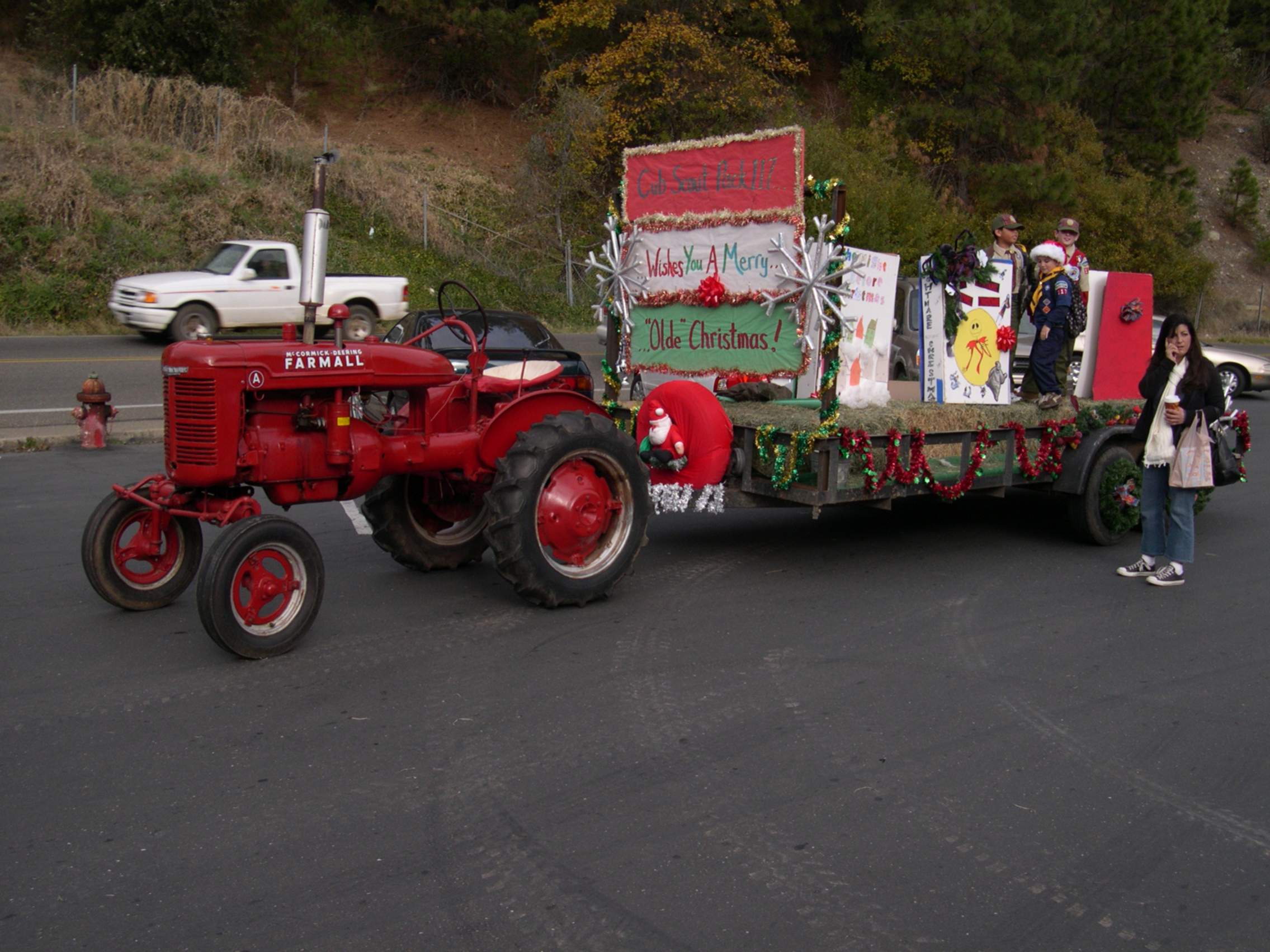

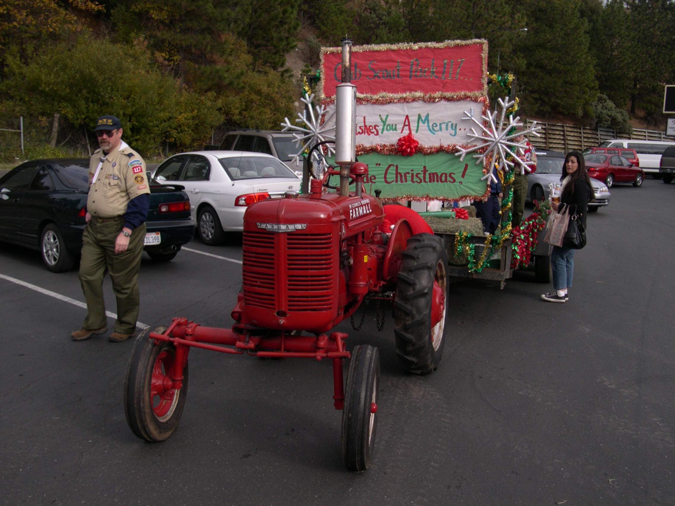

I do not have pictures of the whole thing while in the parade, but while we were preparing.
if anyone has done similar and has pix,Id like to see some.
