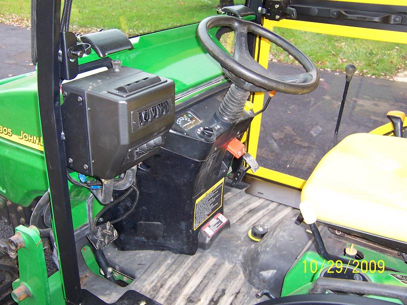

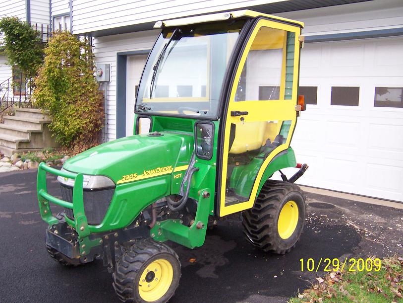

I believe the 2210 and 2305 Curtis cabs are the same. I've had my curtis soft side for 6 years now. Its been a great cab has plenty of room and good visibility.
I did add a radio and a cable operated chute deflector adjuster howdayado.
I didn't like the heat output so I changed the radiator fan to an electric fan with a pwm controller to keep the coolant temp above 180 in the winter.

Hi Dalejr! If you read the post I send to Diz, the prize and options are there. The first time you install it, it takes about 3 hr. You have to make your first heater and electrical connection and your primary bracket which will stay in place once you removed your cab. I used a pulley attach to the ceiling to removed it and it takes about 1hr to do the job. I stored it back on its original pallet and leave it in my garage for the summer. The bracket to removed it is included with the cab. As for the ac, I don't know, not an option that I needed, but I think they do have it. Check it out on there web site ROPS and Non-ROPS tractor cabs, canopies, and guards for all popular brands - Jodale Perry Corporation . Do I regret it, absolutely not, best moved I made, after my 2305 of course.;)

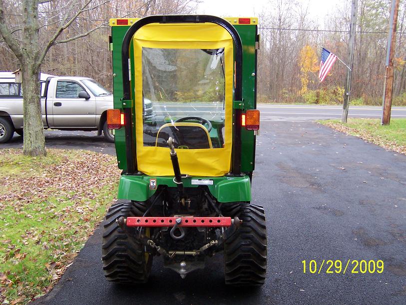

Labrat - or anyone else w/ a curtis soft side on a 2210/2305 - any issues w/ the soft rear window? I'm about to order one of these and contemplating the hard rear panel instead of the soft one.

I did go to TSC and buy a couple of fiberglass rods and put them above and below the rear window, when the wind blows it pushes the window into your back.

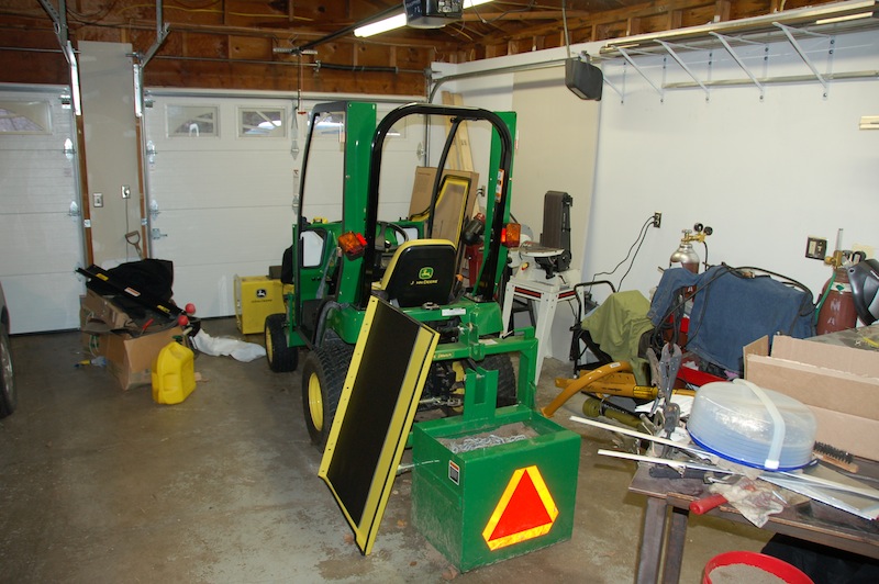

Arrived today, woo hoo! Heater didn't make it, but I've got stuff to keep me busy installing the cab for now.
Labrat or anyone else who did this - how did you route the snowblower chute deflector cable into the cab?

I never use the brakes so I ran the cable through the hole in the floor and clamped it to the brake petal.

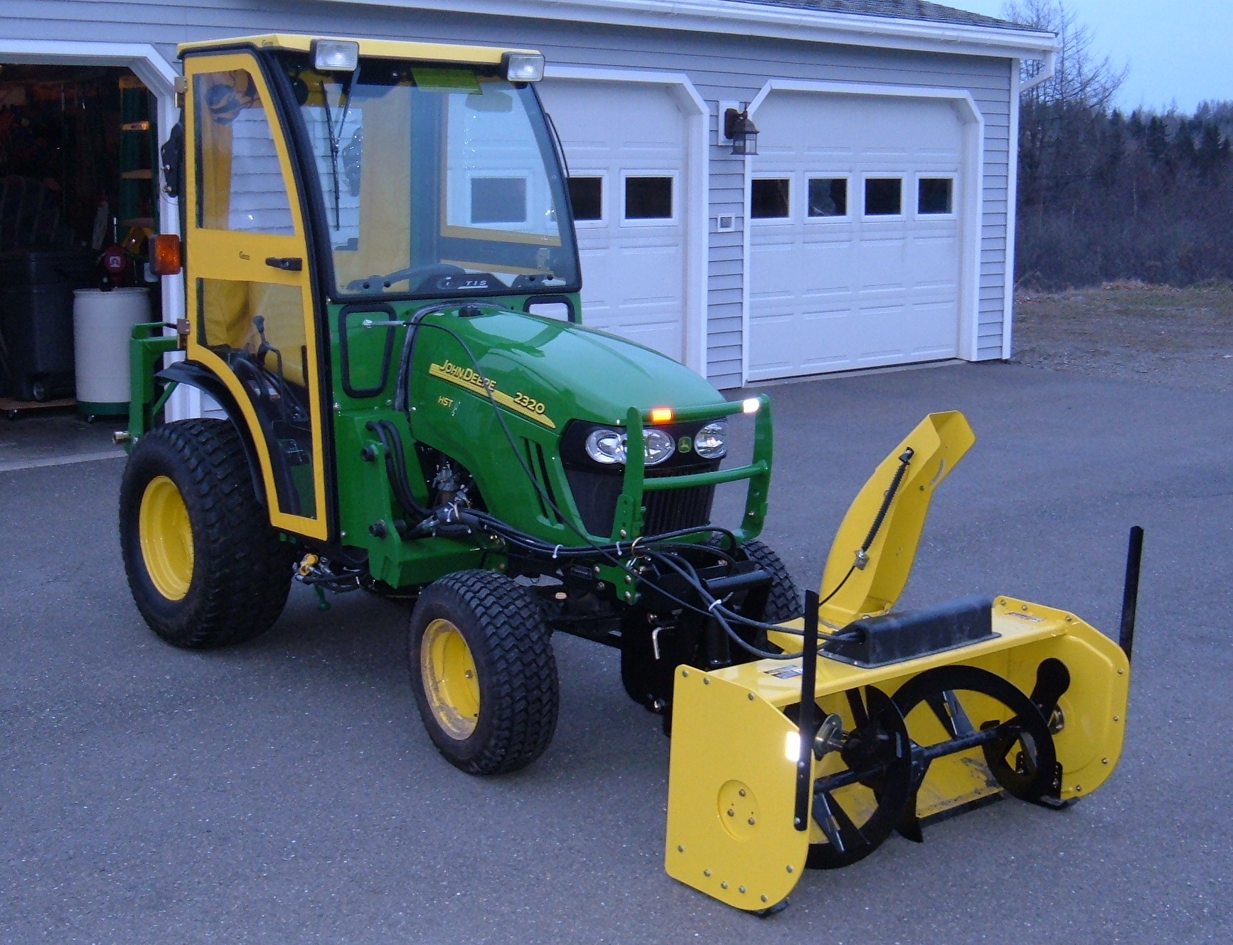

I have a 2320 but basicly the same cab style, I removed the plastic glass on the left hand side, this was where I also put my heater, so that I would have less "stuff" in the way when I get out of the cab. I also lowered the heater a few inches so that I had room for the cable chute deflector. I thinks that I used 3/16 plate or whatever was the same thickness as the acrylic window it was replacing. I then painted it JD Green and installed it. Looks factory original!:D

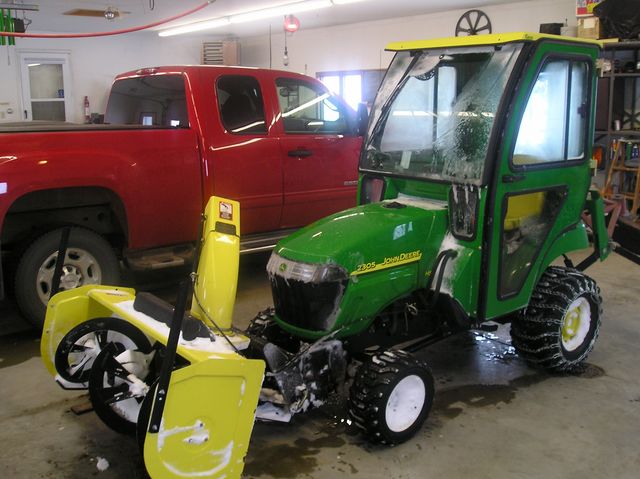

The coolest mine has been was 45 degrees inside the cab. But that was after dark in the middle of a blizzard. That is when that pic was taken. 12 degrees and sustaned 30 mph winds gusting to 45 mph.
I like my cab!!

Pics so far. That floorboard bolt on the right hand side of the tractor is a pain when you have the diverter valve kit installed. I might just take the easy way out and put the bolt in upside down so the nut is on top.
Thanks for the input on the blower cable guys. Merry Christmas!
