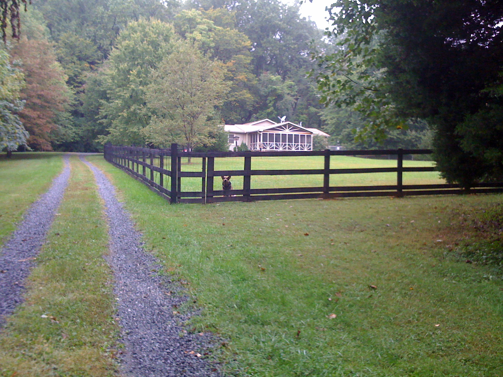

I responded to your msg, but realized after reading your post, that I never mentioned the 3pt hitch. I had no problem attaching it, but did have a problem keeping it from swinging from side to side. After doing 80 3-4' deep holes, I realized that having it loose is not a bad thing, because it makes getting it into position that much easier. I attached the yoke to the boom on the 2nd hole from the rear (close to the tractor) and I could lower it past 3.5' and drive around with it fully elevated with no problem.
Not sure what type of fence you are putting up, but I put up a 4 board horse fence with post every 8' for over 600' and it took me and my brothers 3 weekends to do it. We did 10 the first day, 30 the 2nd day, 20 the 3rd day, and I did the remaining when I could. After painting and gate hardware, I'd say it took me a solid 5-7 (8 hr) work days.
I paid around 450 for mine in Frederick, MD and I'm more of a buy it instad of rent it guy, so I can work when I want to and not feel pressured to get it done in one day so I can return the rental equipment. Besides, I plan on using it next year to build a pole barn and eventually....I'll fence in the rest of the property.
OK OK, I uploaded a picture of the fence too. This is the corner closest to the road, and you can see the reason it has 4 horizontal boards.

Nice fence!
meb9796,
Nice dog! Beautiful trees!! Gorgeous property!!! I'm in lust!!!!
