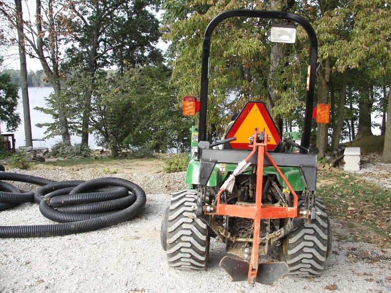

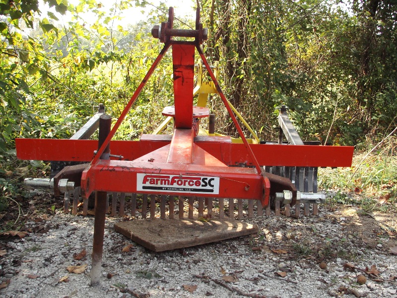

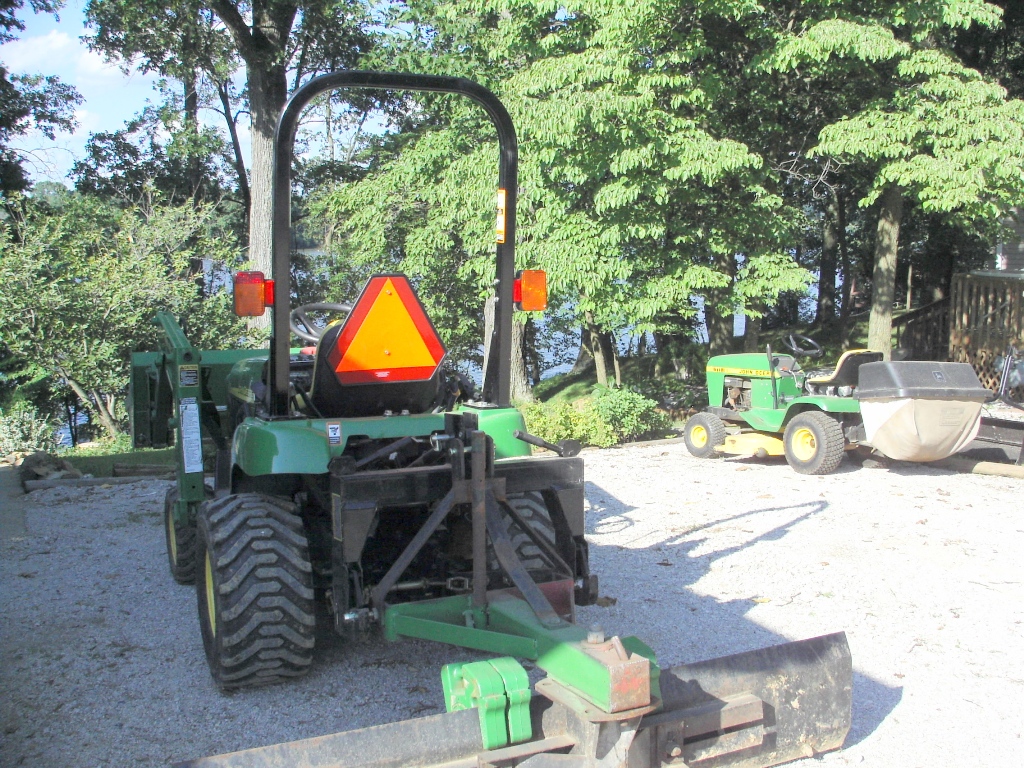

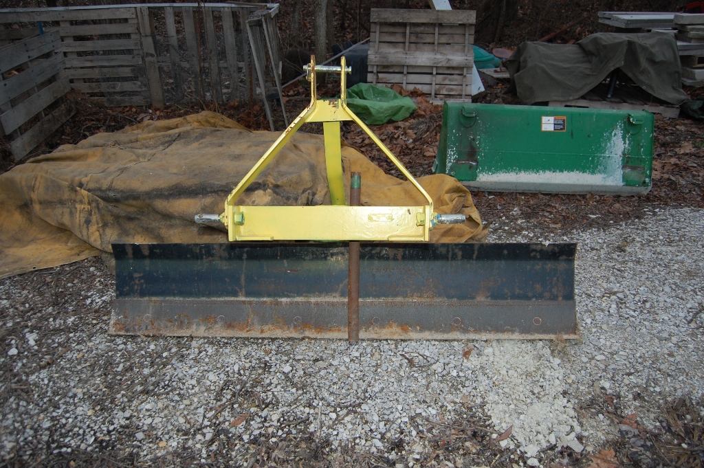

I have a 2210 with both standard and sub-compact attachmetns, here's my 2 cents:
One of the issues with many of the sub compact attachments is that they are built with a 20" wide 3 point instead of the standard 26" of full size cat 1. This works fine on the 2210/2305's unless you plan on getting a quick hitch like the I-match (or speeco/harbor freight).
I have a hitch and had to modify my rake and sub-soiler (both sub-compacts) to make them wide enough to fit the hitch. My blade is a 6' J-bar full size that weighs about 300 Lbs. It does only lift about a foot as others have stated but works well for me.
In short, I would buy full size implements because they're usually cheaper, heavier, and work just fine.
BTW I'm another big fan of a rake. It's probably the implement I use the most and was well worth buying.
