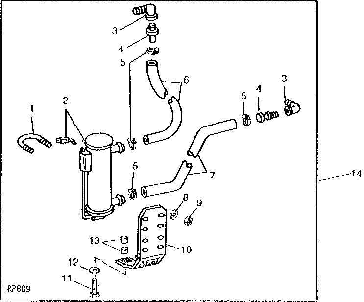

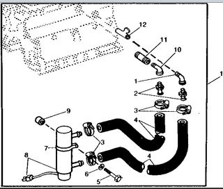

/ 2240 - Cold Weather Starting Kit #3
JDparts shows a coolant heater for your tractor

hey all, I'm finally getting the engine coolant heater for my tractor. from the picture is looks like it hooks into the left side of the engine towards the rear. is that correct? thanks Dane.

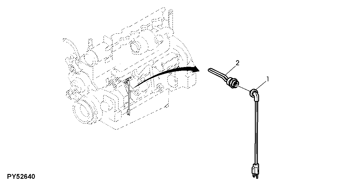

According to JD parts the coolant & air intake heater are optional. I agree the 5045D should start with no assistance @ 45° F. Below is photo of location of coolant heater
