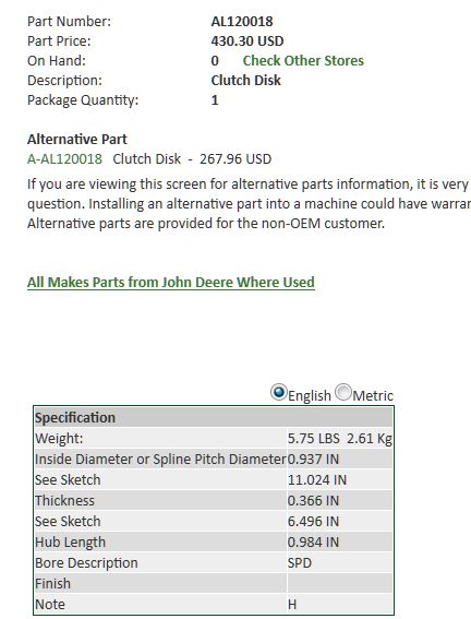

I though my clutch was worn out, there was too much play in the petal. the gears would not stop turning when the clutch was engaged, but the linkage/rod from the pedal to the throwout bearing lever was tightened all the way. although the clutch was not slipping. so I split the tractor last night. the clutch looks good it is about 0.39" thick. the flywheel looks like it has been machined recently (before I bought the tractor). It looks like the levers on the pressure plate are adjustable. they are sitting 1.4" from the surface, when everything is bolted together. this is a single stage clutch by the way.
so my question are; what is the thickness of the clutch before it is considered worn out?
How do you adjust and set the levers (to what specs).

/ 2240 Clutch specs info #2
Here's the spec's on a new clutch plate
Hi all, I found the specs for the the pressure plate fingers, I was told to set them at 1.8 inches. the thickness of the clutch seems to be correct (.38 inches). I slid the tractor back together and adjusted the clutch pedal rod so that I have 1" of travel before the throwout bearing touches the fingers. the rod is now adjusted in the middle.
I tested it out, it is definitely better. when going from neutral into gear the gears are still turning, nothing like before but would prefer them to be stopped when shifting. any other suggestions?
Thanks, D
