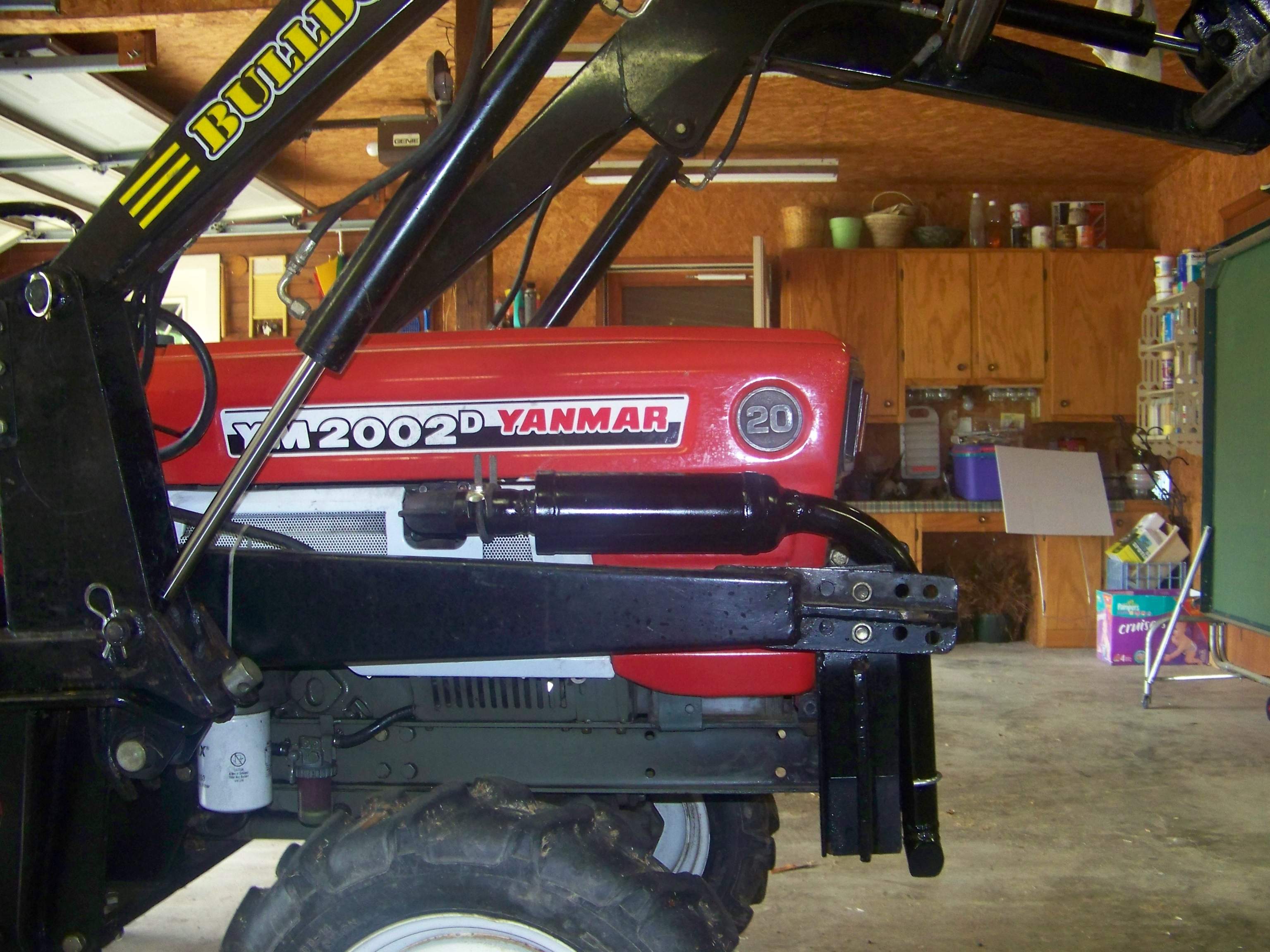

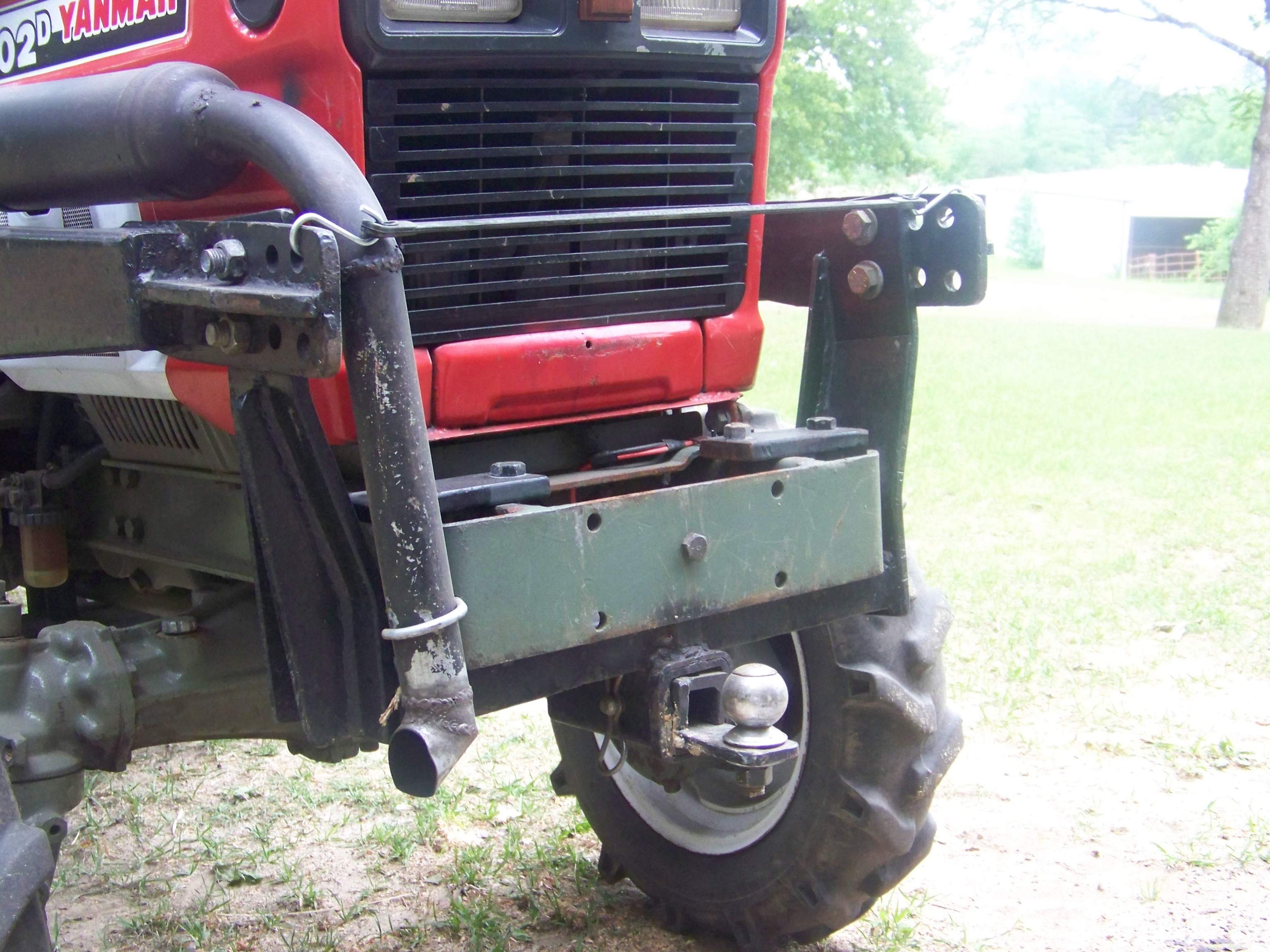

May not be of interest to you and might not work with your set up but here is how I turned my muffler forward and then down. I mow under a lot of trees and the muffler sticking up was a big problem for me. Just a thought. Takes a little cutting and welding. Fumes are not a problem. I have a little 45 degree welded on the outlet of the exhaust that direct the exhaust out and down. As far as the filter is concerned I personally think the factory jobber is adequate. Again, that is just my opinion.
