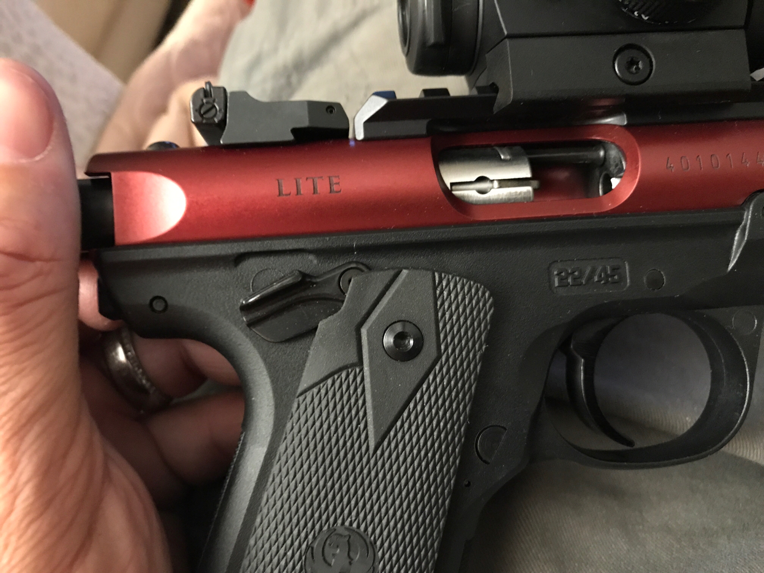

Apologies. Arrived home and examined the ammo and must correct a 'typo'. My ammo and way too many FTL's first time using my new Mk IV Lite was not 'Thunderbolts' rather 'Golden Bullets' Hollow Points. Per K0UA's instruction, decided to examine the bolt action.
Slowly pulling back, I get a hitch about 1/2 to 2/3's way. Is this normal? Smooth otherwise.

Yes normal, I believe this is where the bottom of the bolt is riding over the top of the now cocked hammer. Make sure those surfaces are smooth. They will smooth up themselves after firing enough rounds, but wouldn't hurt to check with your finger. Now that you have one of them fancy pistols that come apart if you look at it crosswise (green with envy). My first concern would be the area that the captive recoil spring rides on the top of the bolt via the little funny looking half moon cutout piece of metal on the end of the recoil spring guide rod. Anyway polish the feed ramp and see if anything improves.. Also try a bunch of different rounds (I know easier said than done nowadays) and see how they all work.

Okay, decided to try a bunch of different brand/type ammo today at the range. 22LR now very easy to get at any gun store around here now and lots of selection too.
Shot 20rds (2 different mags) each with six different ammo types, took very good notes and saved my targets. Have a dedicated logbook now. Why did it take me years to start doing this... :duh:

Oh and I did lightly polish the feed ramp prior. Used Flitz and my dremel. Hard to get the tool in on the tiny feed ramp but it did polish up to a shine.
Same problem with the Golden Bullets... FTLs. Great news is the Thunderbolts, Browning, and CCI were flawless and I had really nice groupings with the Thunderbolts. Had problems with the Federals (2 FTE) and one FTL with the Gemtechs. I think I have narrowed my selection down! Time to clean and polish again but need a better tool to get on the feed ramp (narrower felt tip bit).
