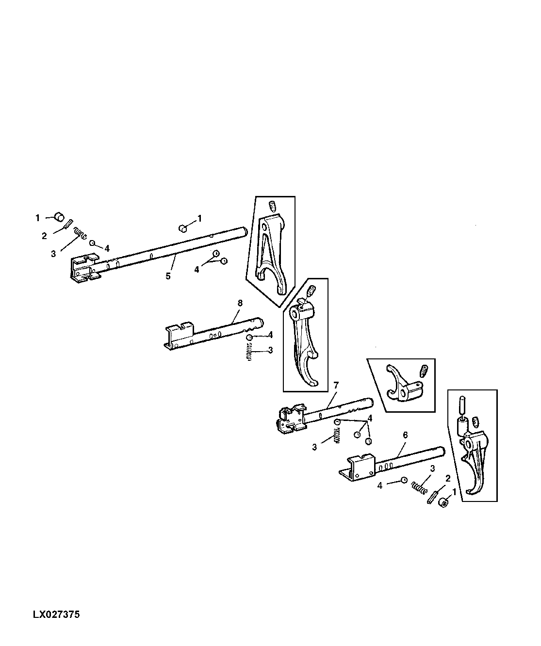

Lost gears except 3rd and reverse. Cannot put shift into other gears. The clutch seems OK. Use the clutch to put tractor in 3rd or reverse. No noise. Just lost all gears but 3rd and reverse. Just hoping for some advice or guidance on what may be the problem. I know it is a collar shift transmission, but have not been into it yet. Thanks!

Might be a failed pin on the shifter arms? Sounds like you're going to have to open it up.

Yes, take the top cover off. You should at least be able to see where the problem is and manually shift the gears with a pry-bar to isolate the defect.
Take pics as you go.
/ 2155 4x4 JD Transmission Problem #9
I'm thinking one of these forks is not connected to its shaft. Possibly dropped out of the collar and binding.
/ 2155 4x4 JD Transmission Problem #10
The shift forks are held to the shift rods with set screws IIRCC the set screws are safety wired.
You need to remove the rockshaft housing to check.
I am thinking the stamped part riveted to the forward end of the shift rod broke.
You need to remove shift lever housing to check.
If a shift rod needs to be replaced you will have to split the tractor.
Broken part may be able to be welded back on to save splitting the tractor.
/ 2155 4x4 JD Transmission Problem #11
I agree with Zebrafive on broken shift rail tab that gearshift handle is suppose to sit in. I've seen several broken tabs re-welded to shift rail. I also suggest to remove shift cover for a visual inspection.
