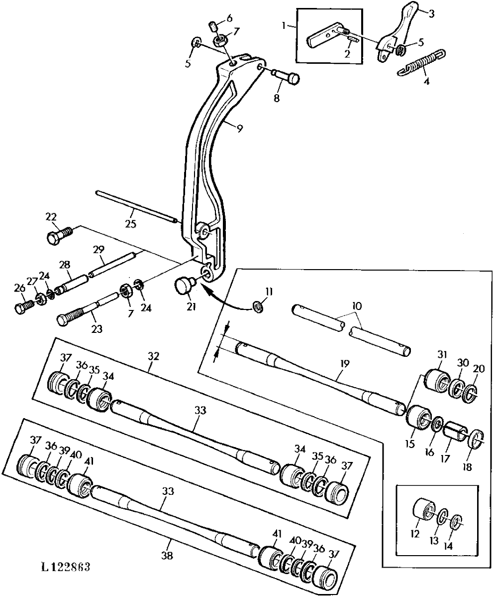

We use our old 2130 for bush hogging. Last time she was using it the lift quit working so I figured it was low on hydraulic oil. Yesteray I was looking at it and found where it is leaking as evidenced by the two oily spots on the ground. It is leaking in what (at least to me) is a very odd place. The two draft (lift) arms of the three point attach to the lower part of the tractor casing by sliding the swivel balls over a pin on each side of the differential casing. The arms are held on the pins by a collar and spring clip. The oil is dripping out around the pins...which I assume is actually one long bar that runs internally from side to side. I have never encountered anything like this before and was wondering what the concensus of those here might be as to what the problem is....and what it will take to fix it?
I was thinking I might be able to put some type of packing around the shaft but as of now I am not able to get down to look and see. Then I started wondering is there was actually something leaking internally and letting fluid drip into the bottom of the housing into what is a dry area around the pins or shaft and then seeping out around the pins and onto the ground

Normal with age. Just replace the seals. I broke a seal in frosty weather while snowblowing. When it's all drained to change the seals. Has the oil filter and screen ever been replaced and cleaned? As for the engine, keep fresh anti-freeze with active corrosion inhibitor. Old anti-freeze will allow the wet sleeves to cavitate holes and leak.
5 R63937 WASHER AR X X X I.D.=26,5MM
L41154 WASHER AR X X X I.D.=29,1MM
6 L26941 BUSHING 2 X X X I.D.=25,5MM

Looking at JDparts.com there were three differnt shafts used. All had diffferent seals. You will need the serial number of your tractor to get the correct parts.
You can do the repair without draining the hydraulic oil, but you will be losing it as you do the repair. Plan on catching it.
Remove the retaining pin and lower 3pt arms on both sides.
Make sure the pin hole in the rod the 3pt arm was on does not have burrs that will damage the seals.
You will replace the seals in one side at a time
Push the rod into the bushing of the tractor transmission case. ONLY FAR ENOUGH to remove the old seals.
Remove old seals
Replace with new seals (heat in warmto hot 160* water until soft, bend in "U" shape, install, reshape it round.
Slide shaft back out thru new seals.
Repeat opposite side.
Replace lower 3pt arms.
Top off hydraulic fluid.

Easy way to find correct page is enter a part number that buickanddeere listed such as L41788 into the parts search under part index in the parts catalog.

Here is how I searched JDparts.com:
Model search: 2130 then click: 4143 -1830,2030,2130 Tractors 12May11
I like using the Sectional Index, so click: Sectional Index
From there click: 70 Hydraulic System
From there click: 74 Parts For Load Control.
That will bring you to the load control shaft, shows the internal parts, the bushings that are pressed into the transmission/axle case (don't replace these) and the shaft seals/o-rings that are in the bushings.

Thanks to all of you for the great help. I was able to find the proper page and see that Deere refers to it as a "sealing washer" apparently. I called my local JD dealer and told him what I needed....he happens to have them in stock. He calls them a washer also...said they were made of neoprene. Now I just need to tear into it and see if the bushings are worn also and if not, hopefully the sealing washers will do the trick.

SUCCESS! After a couple of trips to my JD dealer I found that my 2130 has the older smaller 25mm shaft and requires a smaller seal. He had one in stock and ordered another overnight. We installed them this morning....or I should say my wife installed them and everything is back together. I put 5 gallons of fluid in to see if any leaks out before I fill it up.

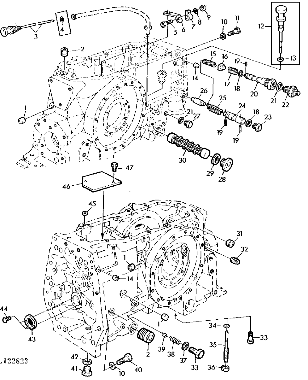

Here you go parts key #3.
/ 2130 losing hydraulic fluid #11
I am not sure if you will have the small dipstick #3 or the long one #12, but it's near the left rear corner of the right hand foot board.

IIRC the "negative stop screw"(parts key #23) isn't designed to be adjusted tight against L/D linkage but is intended to stop L/D linkage from moving too far in the wrong direction. As long as L/D lever under the seat is placed in "D" the L/D shaft can normally be fully removed without any ill consequences.
