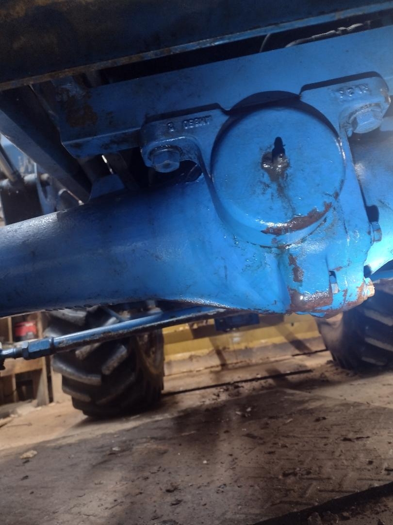

I thought it was the power steering pump leaking, and running down to the front hub shown in pic, which is low spot. After brake clean, I think it is coming from the bottom whatever this is with grease fitting on it. Does that seem possible? I have found pics on parts manuals, but I can't find the name of it.
It is leaking steady fluid, you can see a trail. The power steering was low, and so was main hydraulics. I topped both off. Is this different issue? Wouldn't the fluid in the axle be something else?
What is this called? What do you think is leaking? And suggestions on fixing? Do I just remove the two bolts above? Thanks. It is located at my camp, 300 miles away. But I do get there a bit.

That part is just a pivot point. The part behind that is a solid piece of metal, that is part of the front axle assembly.
If I remember, there are power steering lines attached to the frame above the pivot point.

Hard to tell, but may be just grease that has liquefied and oozed from pivot, if it isn’t coming from above.

it is power steering house the got to the arm. Not sure the terminology. From arm that goes to wheel to frame on left side. Not easy to get access to. I got it off but it was not easy, very tight.

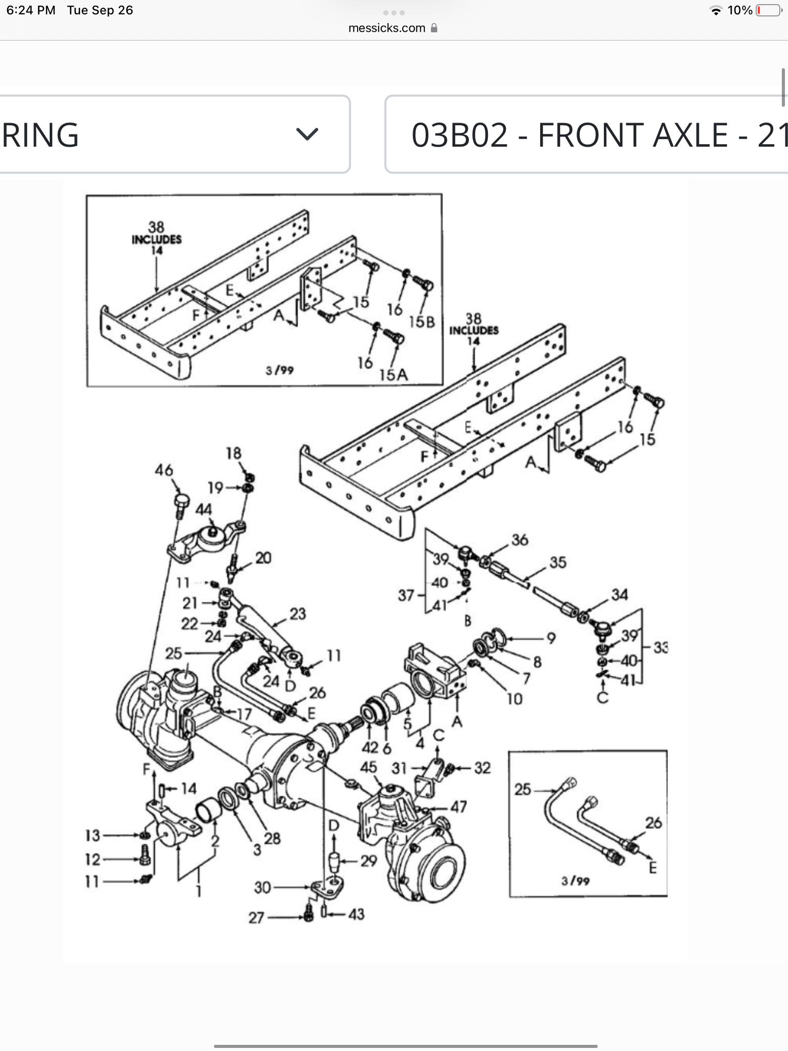

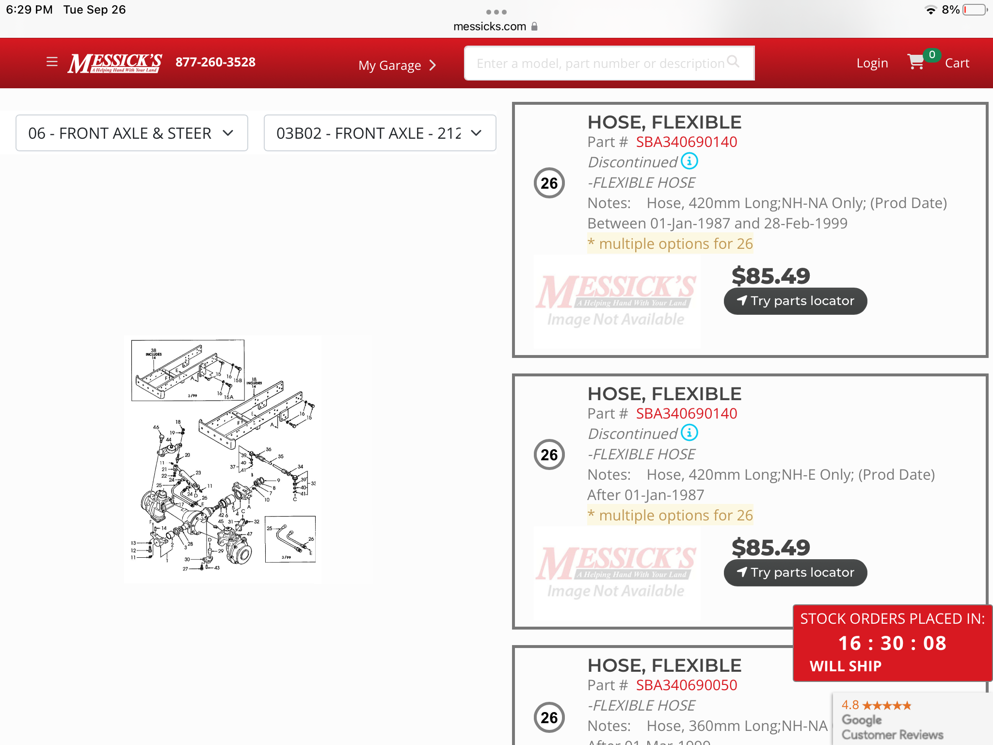

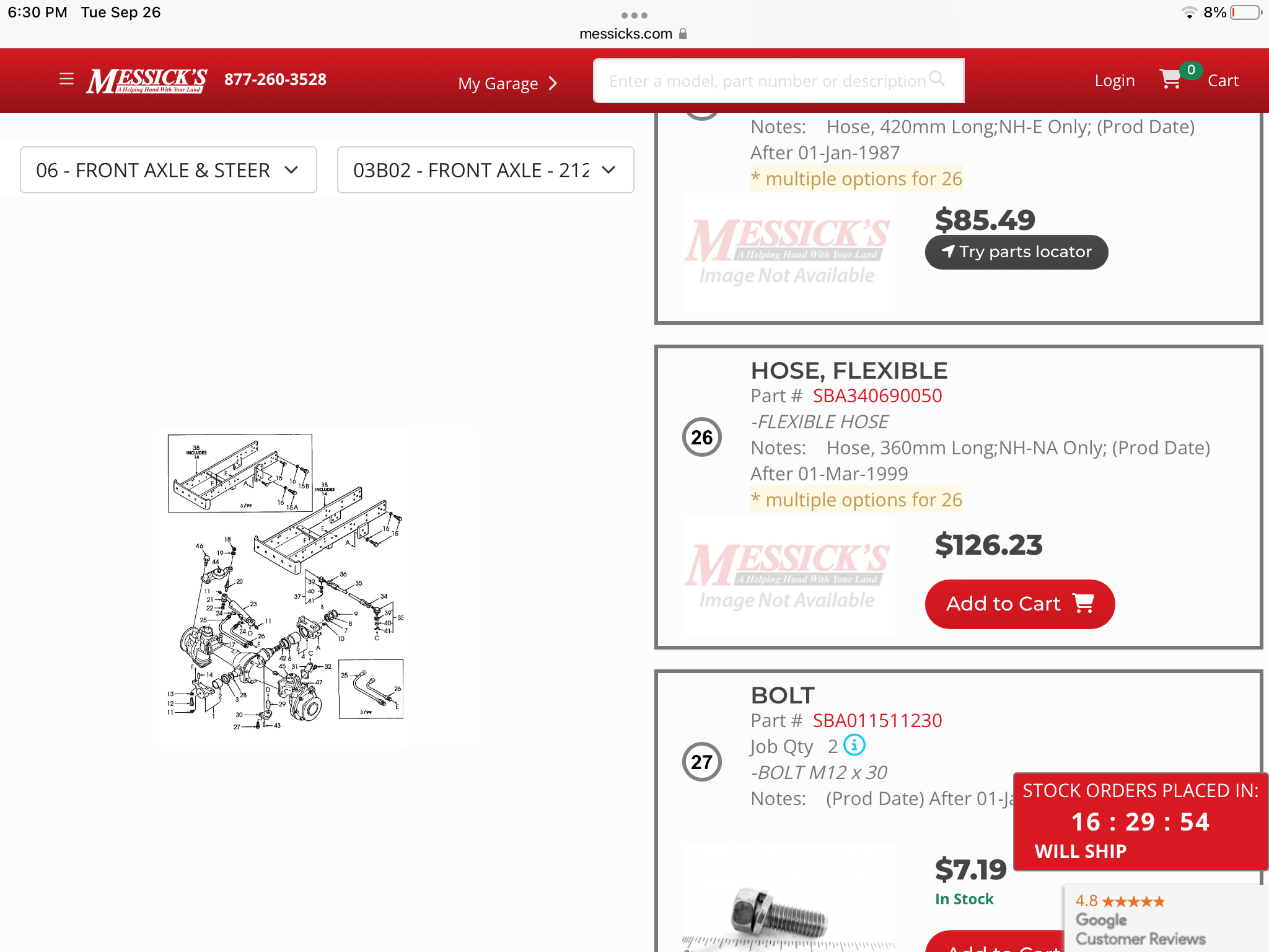

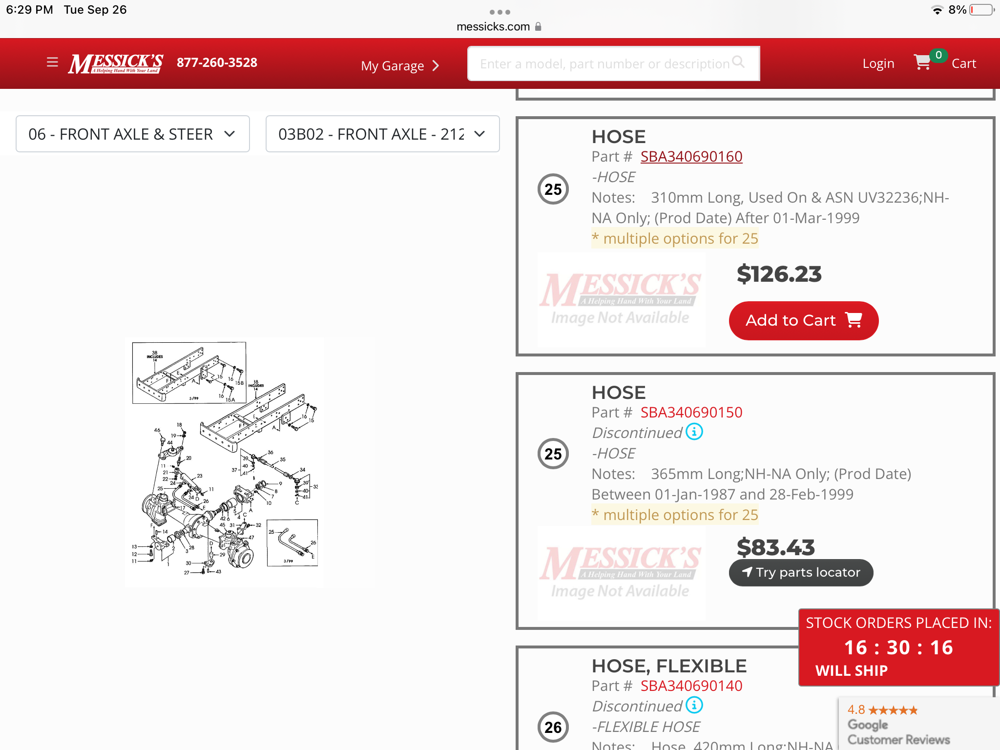

I need 26 in the diagram for a 1995. Not sure I am reading right, 3 options. I think mine is not available.
/ 2120 front end leak #12
Depends on year. Disregard NH-E for Europe, but the #26 I listed is the only one available. You might measure yours to see if #26 is long enough.
360mm = 14 1/8"
#13
Mine is 14". Maybe I will try to run to autostore today to see what they say and cost. If not order 14" hose from Mesecks.
