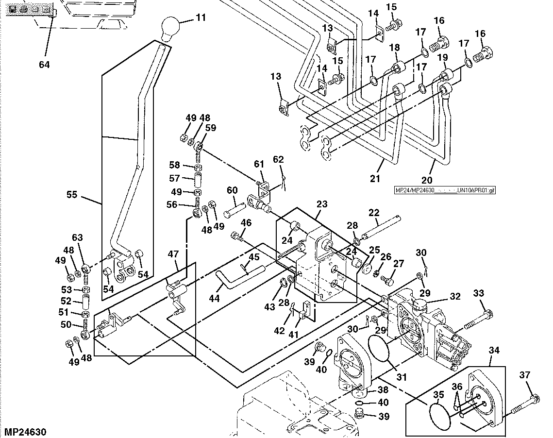

The bucket dump circuit on my 4100 has a re-circ position if you push the stick all the way to the right. Unlike the boom float position, there is no detent to push past to engage the bucket dump re-circ. If you go too far right on the stick, you go from powered dump to re-circ.
It is supposed to help dump heavy loads faster, but mostly it its just annoying because with an empty bucket, it just kind of goes limp and slowly sags and/or does not hold the desired position when back-dragging / back-digging. A lot like what is described in the original post.
Recently, I re-discovered a feature that I had noticed when I first got the tractor, but forgot about until I started using the loader heavily.
Next to the dump/curl spool on the SCV valve, there is a small metal "L"-shaped block that can be pivoted into position to prevent the bucket circuit spool from being pushed all the way in to the re-circ position (stick all the way right). I think this is there for use with an implement like a front blade or snowblower where the re-circ function would be useless. I have engaged this little metal stop on my machine and leave it that way when using the loader as well.
Its part #41 in the attached, very confusing parts diagram from the JD web-site. If you can't find it or figure out what I am talking about, I can probably be talked into taking a better photo tomorrow.
This feature is not documented in the user manual, and you have to take the cover off to really see it and mess with it, but it sure makes using the bucket dump function a lot more intuitive.
Maybe the 2210 SCV has the same thing? If not, it would probably be possible to fabricate something to limit the travel of the spool to just the normal range.
- Rick

You Know Rick, I think you may have hit the nail on the head. I don't know if the 2210 valve has the same limit stop, so I'll try to take a look at it this weekend.
I definately seems like the recirc is sticking. I would guess that the best analogy of the recirc position is a float for curl only, which is what it is doing. This would also explain why a short shot of up-curl would re-lock the bucket.

The float position on the boom connects both sides of the cylinder to the low pressure side and no force is exerted.
The re-circ or re-gen position on the bucket connects both sides of the cylinder to the pump or pressure side. Applying the same pressure to both sides of the cylinder results in a net force because the rod-side has a smaller cross section. So, you get a force proportional to the rod area times the PSI. Not as much as full-pressure dump, but not the same as "float", either.
What is really an issue is that the operator's guide does not explain it very well or warn the operator that it can be confusing to push the stick all the way to the right expecting full dump, but getting re-circ dump.
