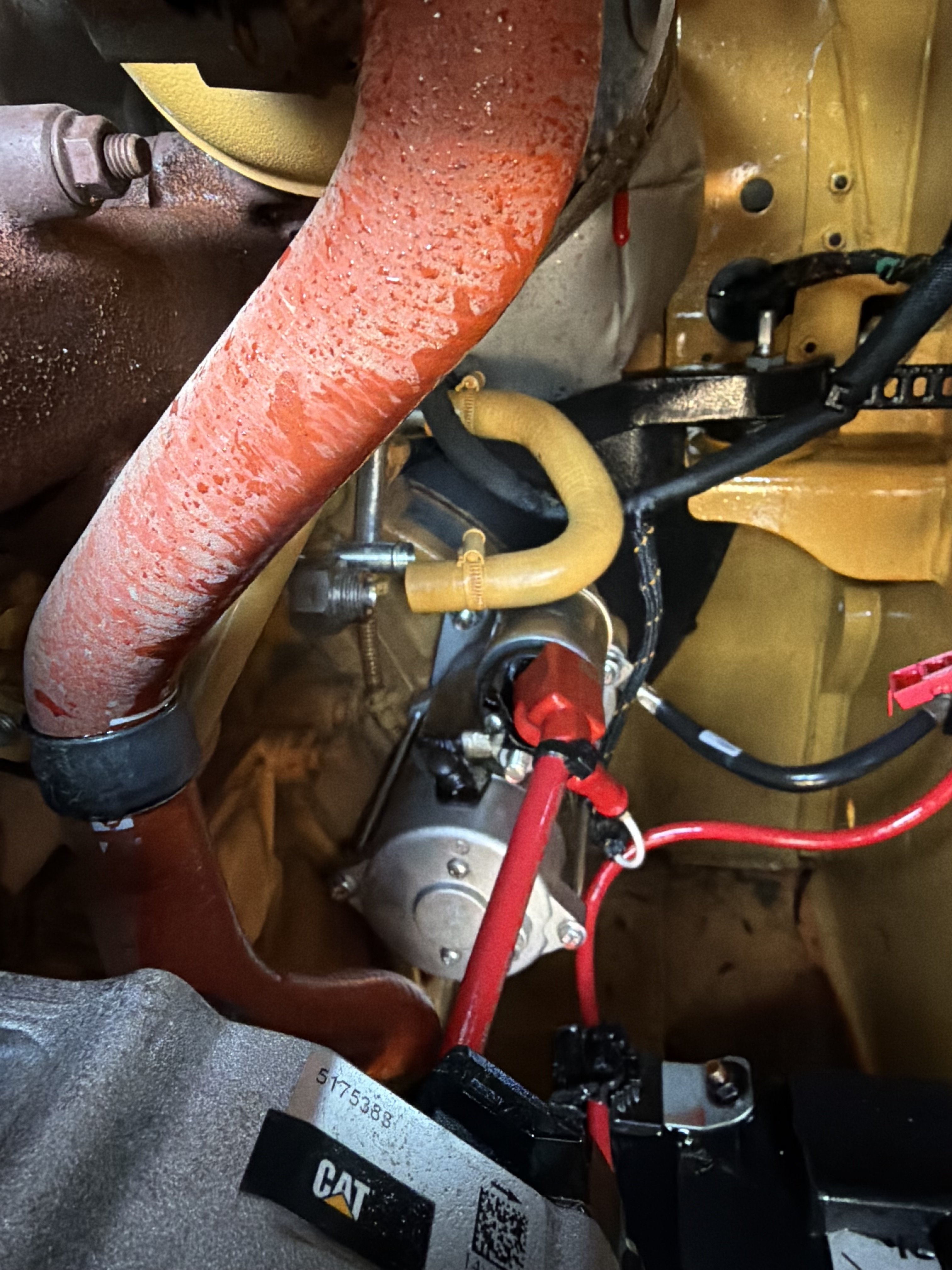

This just happened to me last week. I rented a new Caterpillar 275XE forestry mulcher and it overheated. Only had 40 hours on it.
I shut engine off and found this:
Coolant hose blew off because assembly line worker didn’t slide hose clamp on far enough past the “barb” on the fitting.
Luckily I caught the alarm quickly and shut it down before the engine was ruined. I bet that engine would be $35,000 to replace.

It’s everywhere and happening to all manufacturers.
For example:

Is that even a barb fitting? Almost looks like an inverted flare from here, which makes me wonder if there is a fitting missing.
All the best, Peter
Those fittings are very common for cooling hoses. 13 psi doesn’t require the same type of barb fitting as higher pressure systems.
