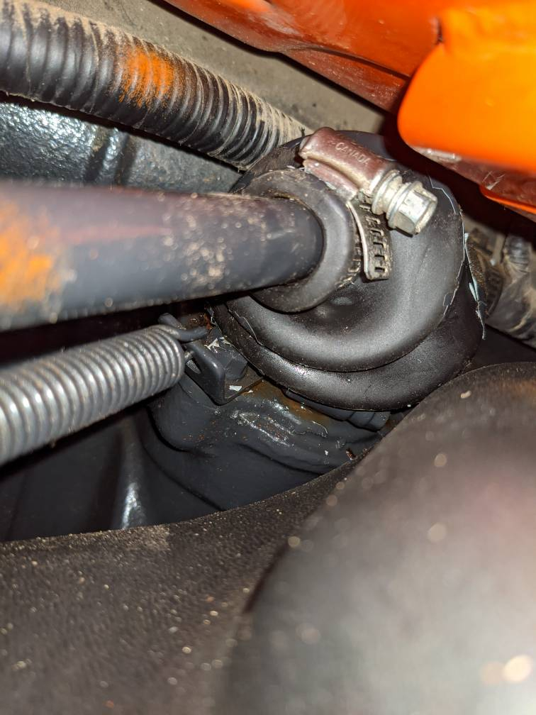

I have had a small leak for about a year now. Happens to leak when the transmission is hot.
- Does anyone have a part for the seal that surrounds the shifter linkage going into the transmissio?
- Does anyone know where the vent tube is for the transmission? I would like to make sure that is not clogged with a dirt dauber or other debris
- Lastly has anyone experienced this issue? If so do I need to take to the dealer or fix it myself.
Thanks

Mine leaked around the boot. I slipped a hose clamp down the shaft and worked it onto the boot. With enough socket extensions, I was able to tighten the clamp. Problem solved. It took 6 attempts holding my phone up in the cavity to get this photo!

Awesome! Do you think removing the diesel tank would give me more room to work?

I did not need to. You can loosen the bottom tank brackets and tip the tank down a couple of inches if needed. I would not recommend removing the fuel lines (and tank) as that requires you to purge the air out of the system after which can be a pain.
