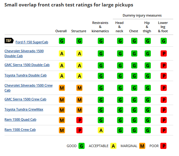

Speaking of failures, apparently you failed to read the first line of the report which stated the following:
http://www.iihs.org/iihs/news/desktopnews/tough-test-for-pickups-ford-f-150-nabs-lone-good-rating-for-small-overlap-protection said:
Three out of seven large pickup trucks IIHS evaluated in a new round of crash tests earn an acceptable or higher rating for occupant protection in a small overlap front crash
Being as there are only 7 pickups listed, saying that they tested other Fords, but didn't include them is a fail...

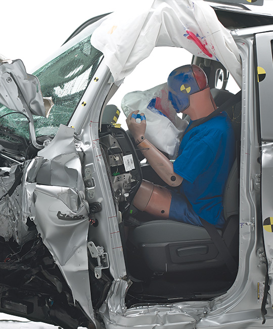

Here is why Dodge got a "Poor" Structural/Lower Leg & Foot rating:

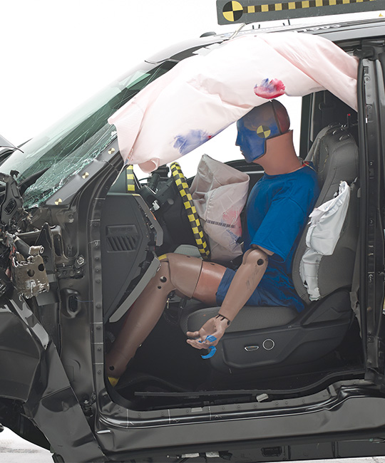

Here is why Ford for a "Good" Structural/Lower Leg & Foot rating:
Overall results:

Yep. Ford has done a fine job with the F150.

To me it looks like the Ford cab separated from the frame and absorbed some of the shock that way. You can clearly see it getting pushed well into the box.
The RAM is pretty alarming. That's a nasty failure.

The Ford SuperCrew scored 'Good' last year and was not changed for this year. The SuperCab was changed to add an additional support bar (that was on the SuperCrew last year). I don't think that the regular cab Ford was updated, so no need to test.

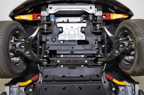

A lot has been said about the results of the Insurance Institute for Highway Safety's small overlap front crash-testing of the 2015 Ford F-150 SuperCrew and SuperCab. IIHS decided to test different cab configurations after it was brought to its attention that front wheel blocker bars are included on the higher-volume four-door crew-cab Ford but are not included on the smaller extended-cab or regular-cab versions.
As a result, the 2015 SuperCrew got the IIHS Top Safety Pick designation while the extended-cab version did not because it achieved a marginal rating on a scale of good, acceptable, marginal and poor on the small overlap front crash test. To get the Top Safety Pick award, a vehicle must get a good or acceptable rating in that test and a good in the other four tests. It should be noted that the SuperCab did achieve a rating of good in the other tests.
When media outlets found out about the wheel-well blocker issue, it didn't take long for many journalists to cry "foul" and accuse Ford of trying to "game the system" by taking advantage of the fact that the IIHS had never tested all of the F-150's cab configurations. Until now IIHS has only tested (it purchases each of its test vehicles from private dealerships) the volume leaders in a vehicle's lineup, which, in the pickup segment nowadays, is the crew-cab model. (We should note that IIHS is likely to be more comprehensive in its vehicle testing in the future to detect differences like those found in the F-150.)
Common sense dictates that if a vehicle has a slightly different size, shape, mass and structural configuration that it might get slightly or significantly different crush and deflection results when involved in an offset collision (in this case, offset on the driver's side by 25 percent of the total width of the pickup). And that's exactly what the IIHS found when it tested the F-150's less popular extended-cab version. Extended cabs are estimated to be 20 to 25 percent of total F-150 sales; regular cabs account for less than 5 percent.
The question here is whether Ford is at fault for treating each of its cab configurations differently (all three cab versions did receive a five-star rating from the National Highway Traffic Safety Administration, the max for its tests), including the "right amount" of structural support necessary for each cab, or if all vehicles with the same name should meet similar crash-test requirements. The issue is tricky. Was Ford responsible for IIHS not including other cab versions to see if they would test differently on the small overlap front test? The answer to both questions is probably not. And remember the other truckmakers have not had different cab configurations tested by IIHS either; they too have only had their high-volume players tested.
For the sake of argument, if Ford had only included those deflection bars (highlighted in yellow and red in the photo below) at the front and rear of the wheel well on the units tested by the IIHS, then accusing Ford of making a vehicle just for this test might make some sense. But as near as we can tell, that's not what happened here. Instead, it sounds like we have a test that's going to be conducted on all pickup truck cab configurations (or at least crew and extended cabs) from now on. That will have the eventual impact of making truck owners safer if, heaven forbid, they find themselves in an accident.
attachment.php
Shame on Ford for trying to game the system and shame on the other brands for not getting their trucks ready for this.
This test (small frontal overlap) has been in the works since 2012. Chevrolet/GMC and Ram have all had a refresh since then. Why didn't they incorporate something like this when they did their refresh? Its not like the test is a secret or that its not testing that they don't do themselves (or if they don't do it, they should be doing it).
