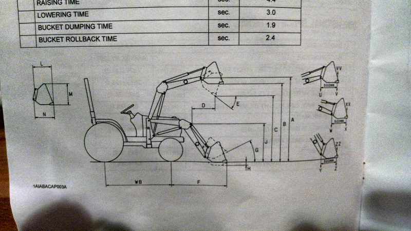

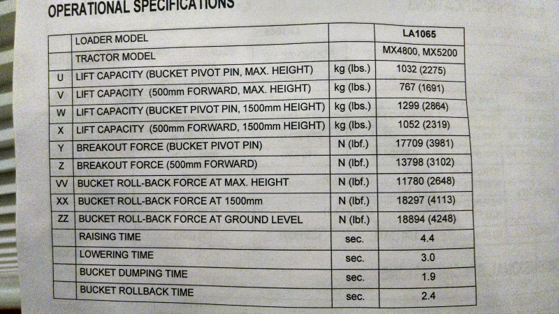

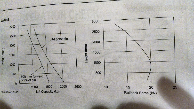

That 1691lbs number for the LA1065 is for 500mm forward of the lift pin at max height where the loader is the weakest. Lift capacity at 1500mm and 500mm in front of pins is 2319lbs so make sure you are comparing apples to apples.
Here are the tables/graphs from my LA1065 manual.
Luke, those charts really illustrate how much more lift a loader has down low as compared to full height. it is one thing to see figures, but I think the graphic depiction of the lift really shows you what can be done at the various heights, at both the pins and 500mm out. Good on Kubota for actually publishing that data.
/ 2014 vs 2015 MX5200 #22
Yes, and breakout REALLY drops off too.

Comparing Apples to Apples (pivot pin @ 1500mm) The LA765 is 1684lbs vs LA1065 2864lbs

The reason the new loader looks less powerful is because a SSL coupler is now standard equipment and it moves the pivot point out. The older MX loader is the same spec, but the SSL coupler was not standard so the spec sheet was done with a pin-on bucket. Good for customers to make it standard, but bad for those who shop based on spec sheets.
