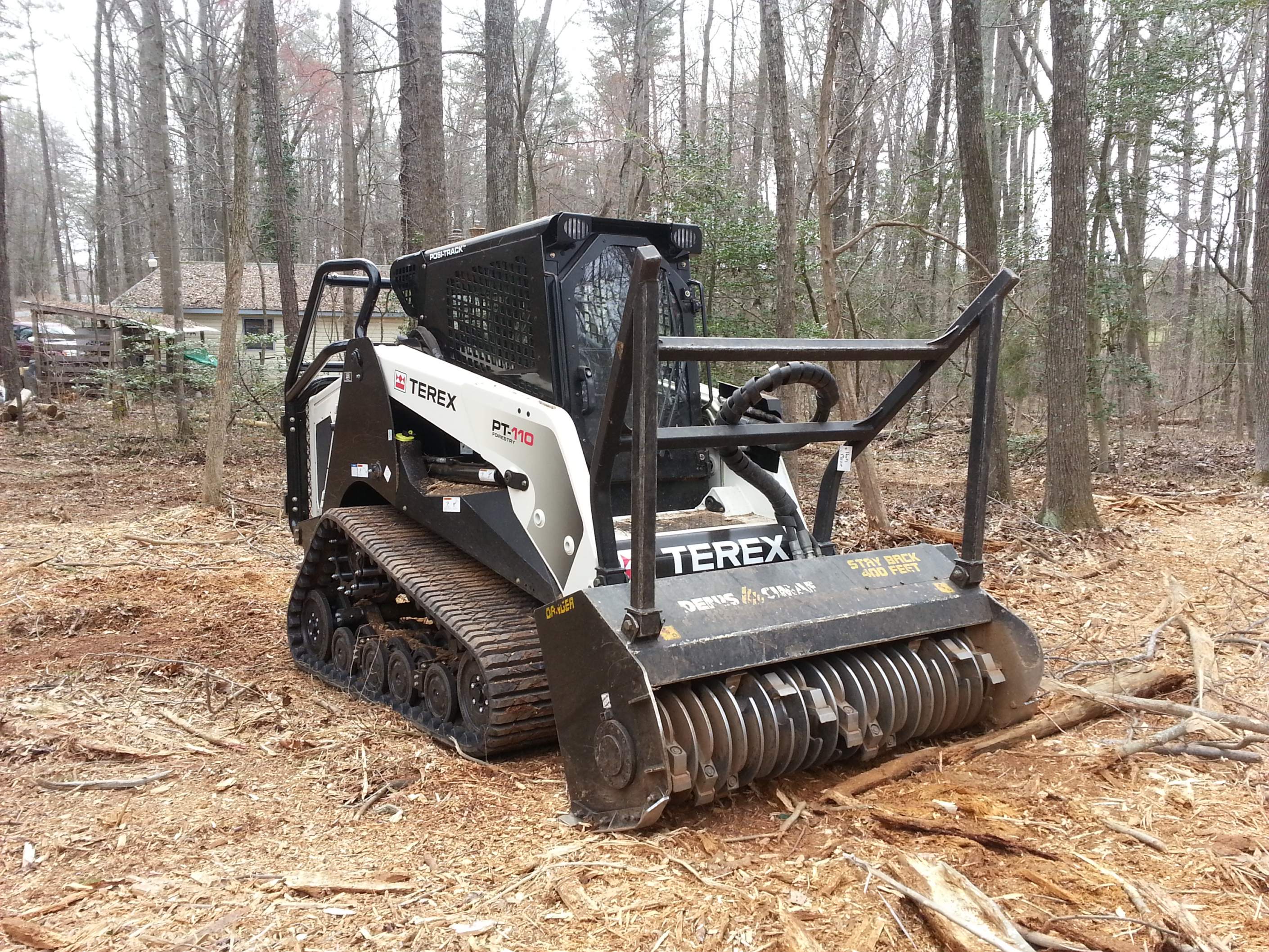

Took delivery of the new machine today and had a chance to put it in the woods for a few hours. So far a night and day difference (and improvement) over the old PT100. 45 GPM and a hyd. driven cooling fan really makes a difference. Waiting to see if any of the demons from the older PT's will surface, but so far I think it's a solid machine. It seems they really worked out the old bugs.

I have exact same set up. I have 100 hrs on mine. Only problems so far...1 air conditioning not working while under load....2. Watch your air conditioning bracket that holds the condensor, mine broke pulling condensor torwards radiator, i caught it in time, but bracket is held on by 3 screws that need to be grade 8 and locktighted in due to vibration.... And ohhh ya, the windshield wiper wont last long lol

The A/C bracket breaking is not new and was a big problem on PT100Gs too. I have a buddy who works for a large right of way clearing company near me and they finally had their own brackets made because Terex would not acknowledge that the failures were a problem (They won't consider buying until they've been out for awhile..they were told that Terex only ran one test machine for both dirt work and brush cutting, and then for a very short time before the launch). Hopefully they'll address this. Local dealer has also heard that they've had problems with the fans (may need to replace) and something to do with the motor mounts as well. Might want to contact your local dealer.

Well all i can say is terex replaced bracket over night no questions asked. I owned a 4810 so i am aware of the history, and believe me i was hesitant to buy, but the machine does perform, has better balance than the 299 as well as cleanout access. If it is as durable as my takeuchi has been i will be happy. I'm not drinkin the coolaid, but with my cimaf head it does volumes above comparible machines and the low ground pressure is a plus. I demoed a sk140 and while it was a monster it will not outwork the terex by much and the price difference was HUGE....

Ran four hours yesterday and had a small electrical problem that caused the cooling fan to shut off ('fwd fan solenoid fault'), but my dealer took care of it quickly and it's back in action. All in all, I'm impressed with the machine. I'm still getting debris in the engine compartment but Terex designed the belly-pan to drop outwards so it's much easier and faster to routinely clean out.

Day two running........blew the forward drive hose (the one inside the belly pan) running the right track. Effectively the machine would only turn right going forward, but would back up fine. After dumping gallons of fluid and making a huge mess, managed to get it up on the trailer and back to the dealer (and of course breakdowns happen most on the weekend). It'll have to be fixed the on the trailer, because she darn sure isn't driving forward. Better there though than in the middle of the woods. Two days running a brand new machine.....broken down each time, but I'm not discouraged with the machine yet. Chalking this one up to breaking it in.

The hydraulic failure ended up being some kind of equalizing line between the two motors. It was a steel line that had to be replaced. Back out tomorrow for day three. Crossing my fingers.........
