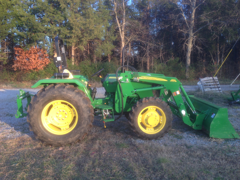

Here she is 5075e with a mx8 cutter. I spent about 6 hours in the seat today and just love it!

Congrats! That's a mighty fine looking machine you got there!
